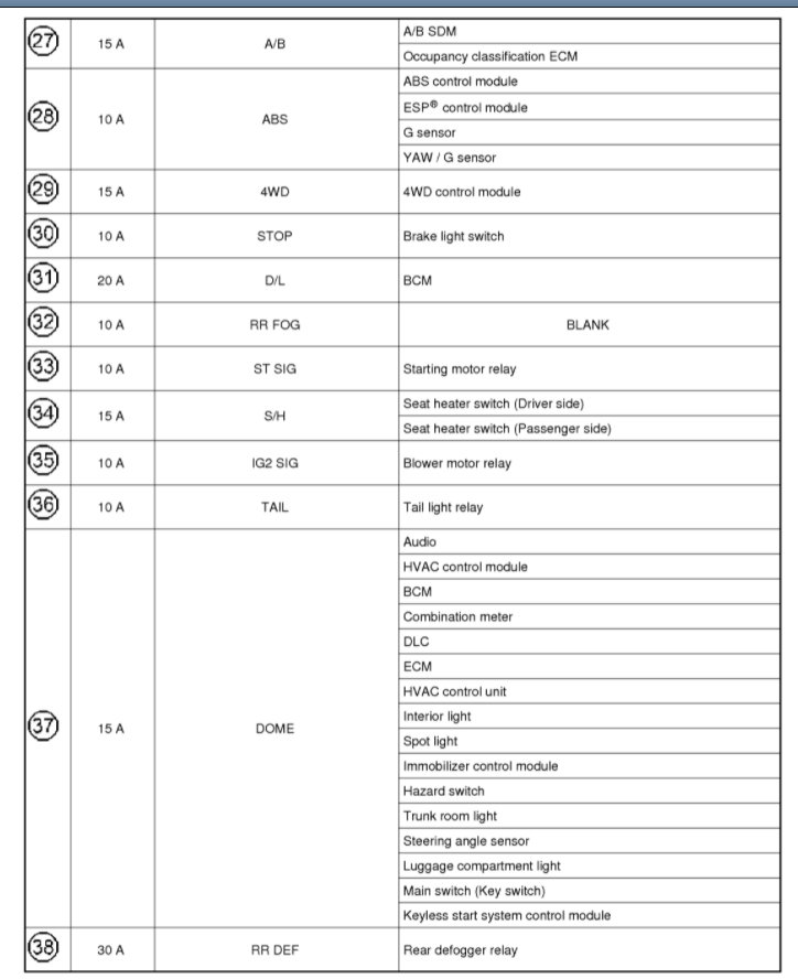

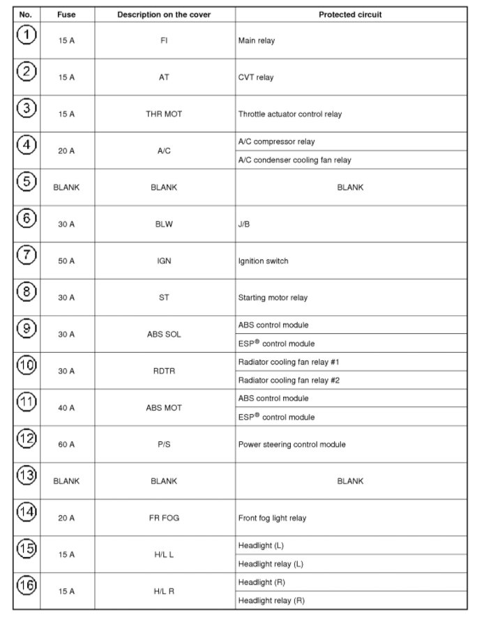

My car has a h4 fitting for both my dipped light bulbs and full light bulbs. I just want to know where the fuses are in the car?
Jan 2, 2020 at 9:05 AM
Experienced Mechanic
18,907 POSTS

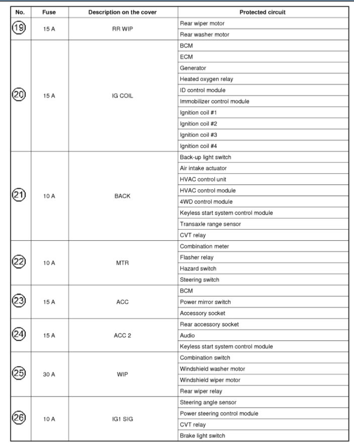

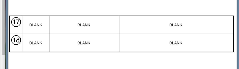

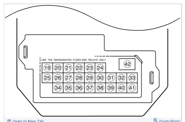

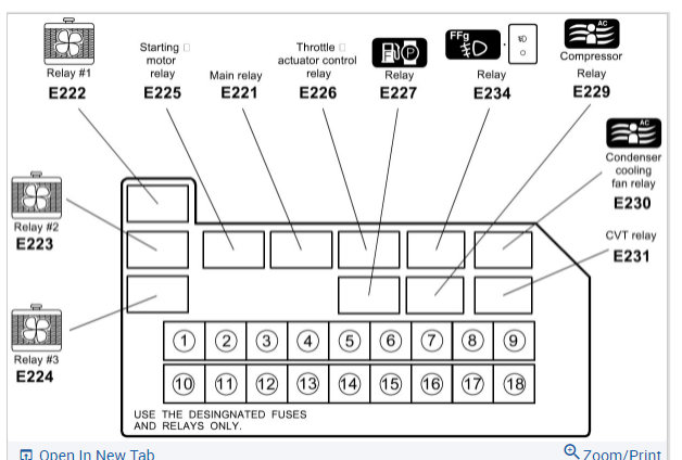

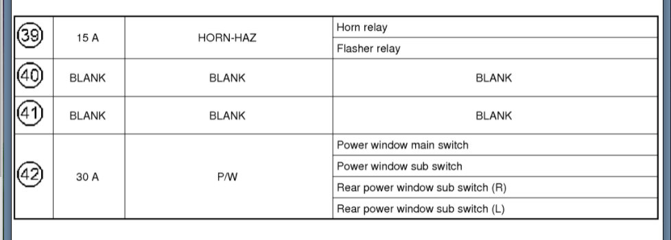

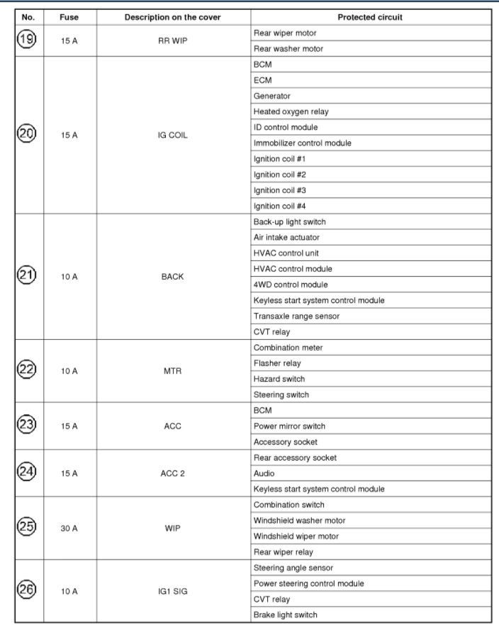

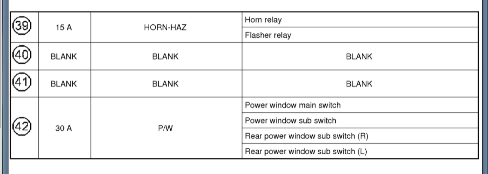

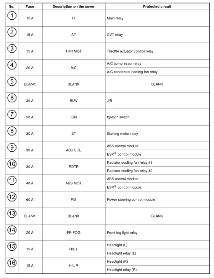

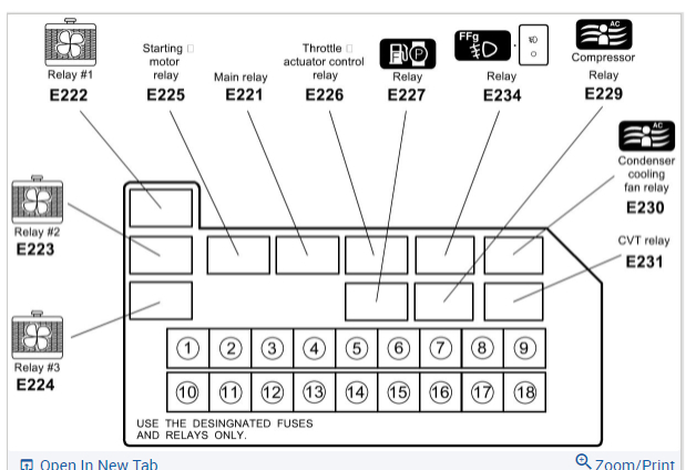

I am attaching all the fuse information but here is a guide that will help test and replace fuses and relays:
Below you will find the info from the manual on the fuse location. Please run through this information and let me know if you have other questions. Thanks
