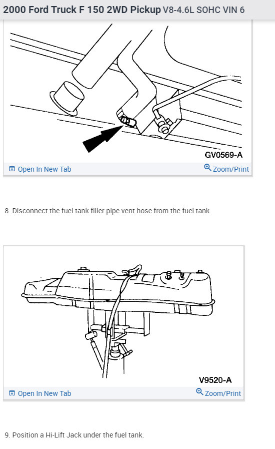

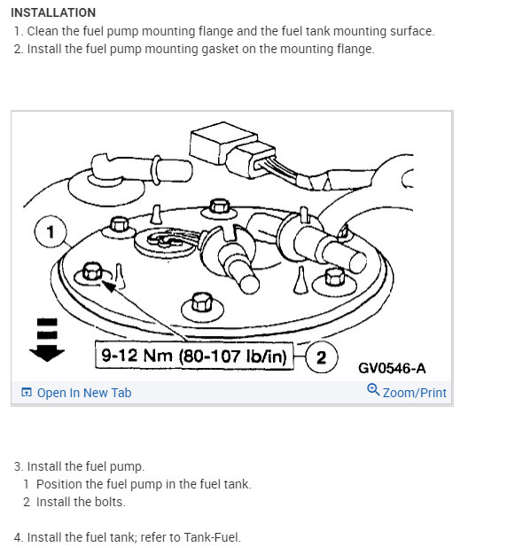

The fuel pump went out I have another, but it is for diesel, same exact year and engine, but my truck is gas.
May 31, 2022 at 4:16 AM
SQM
  • 6,383 POSTS

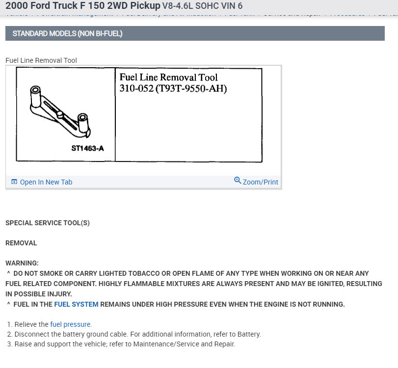

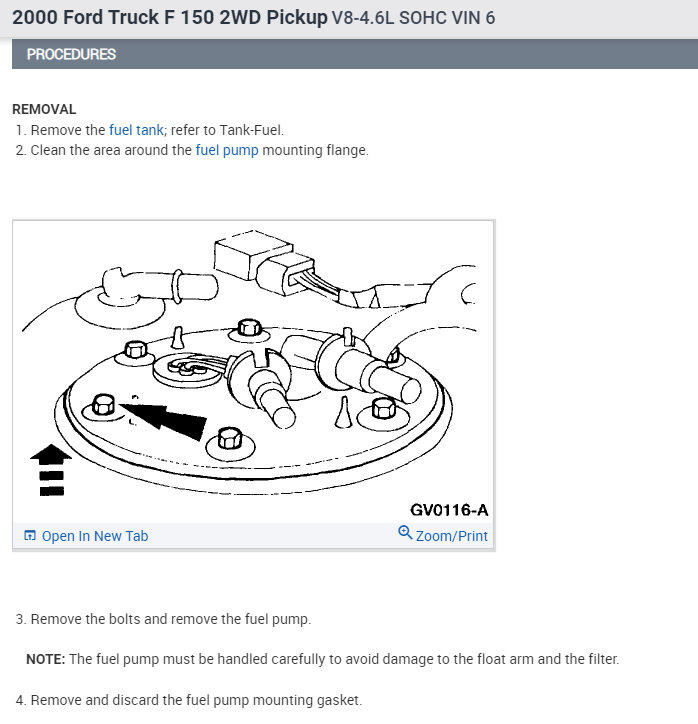

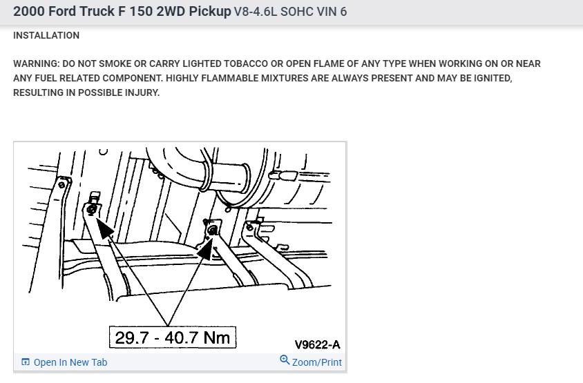

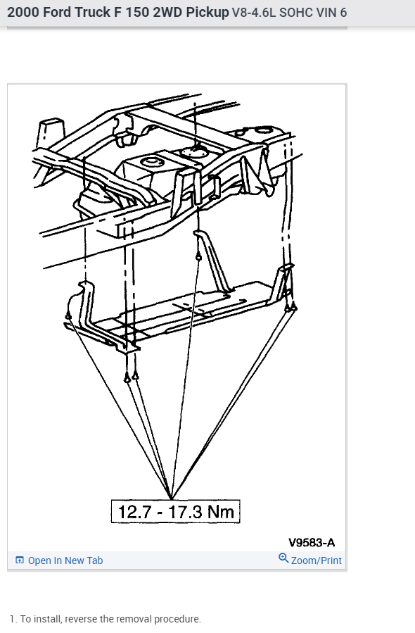

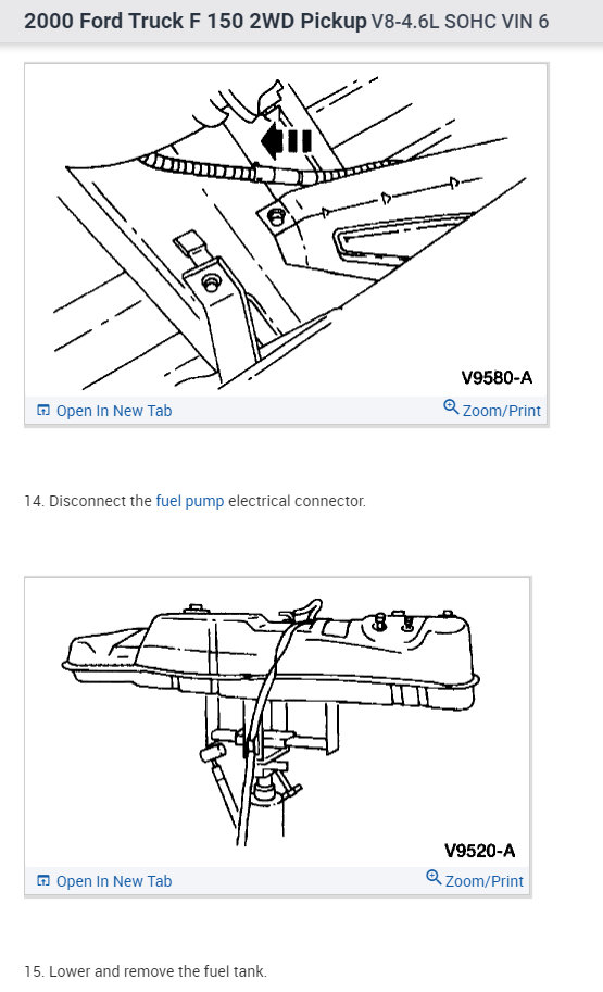

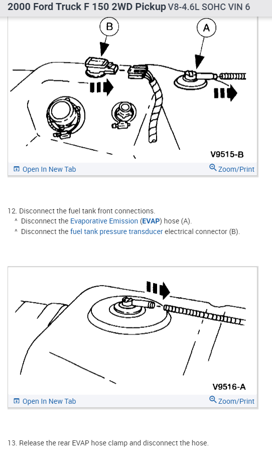

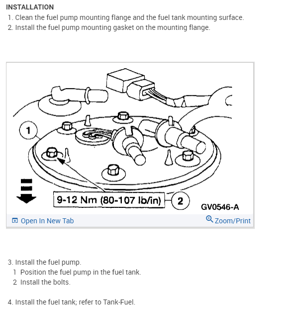

Those pumps are different and not interchangeable.
Depending on the wheelbase the OEM part number for the gas fuel pump is
XL3Z9H307DB (120" wheelbase)
XL3Z9H307EB (139" wheelbase regular cab)
XL3Z9H307DB (139" wheelbase super cab)
And this is the OEM part number for the diesel F81Z9C407AC
https://www.2carpros.com/articles/how-to-replace-an-electric-fuel-pump

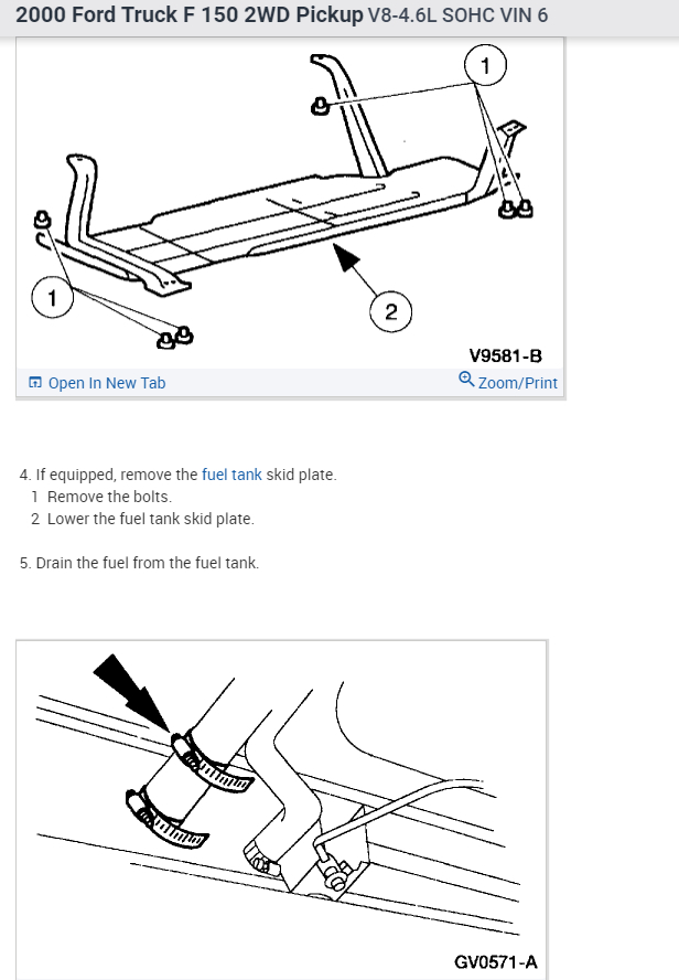

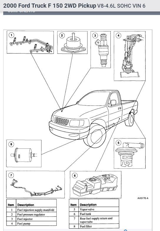

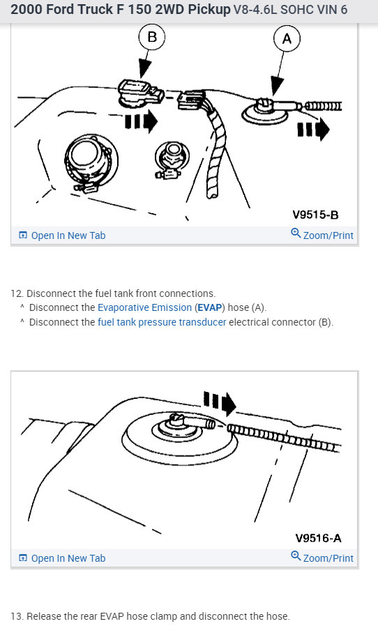

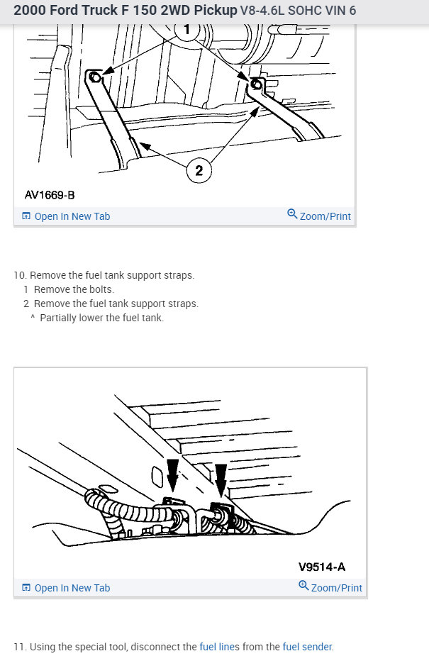

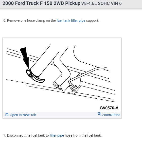

I have attached the replacement procedure below for your reference.
