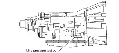

Desperately seeking, advise overdrive started going in and out after warmed up, then lose all gears put it in neutral, coast then I put in gear had gears for ten seconds then none got it home and parked it for two months. Drained fluid looked like motor oil put new fluid back in got in it started it up put in drive, had all gears long enough to go through all the gears then nothing. Stopped for twenty seconds barely got first then nothing. Repeated stopping and going until I got it home. I am hopping I can do it myself I cannot afford another transmission. I have got opinions but need professional advice. Am I able to save my auto transmission? Can someone please point me in the right direction?

One additional thought is if there is a pressure issue. I have attached a picture of your transmission which indicates the transmission pressure test port. You will need a gauge to check, but most of the nationally recognized parts stores will lend you one. The second picture is what the pressures should be. If it is low, the trans will not go into gear and is most likely the result of a bad front pump. At that point, the is most likely internal damage to the clutch/friction plates and the transmission will need to be overhauled.
I hope this helps. It is confusing, but follow the directions in the links above as well as what I suggested.

PS: The second picture looks blurry until you enlarge it.
