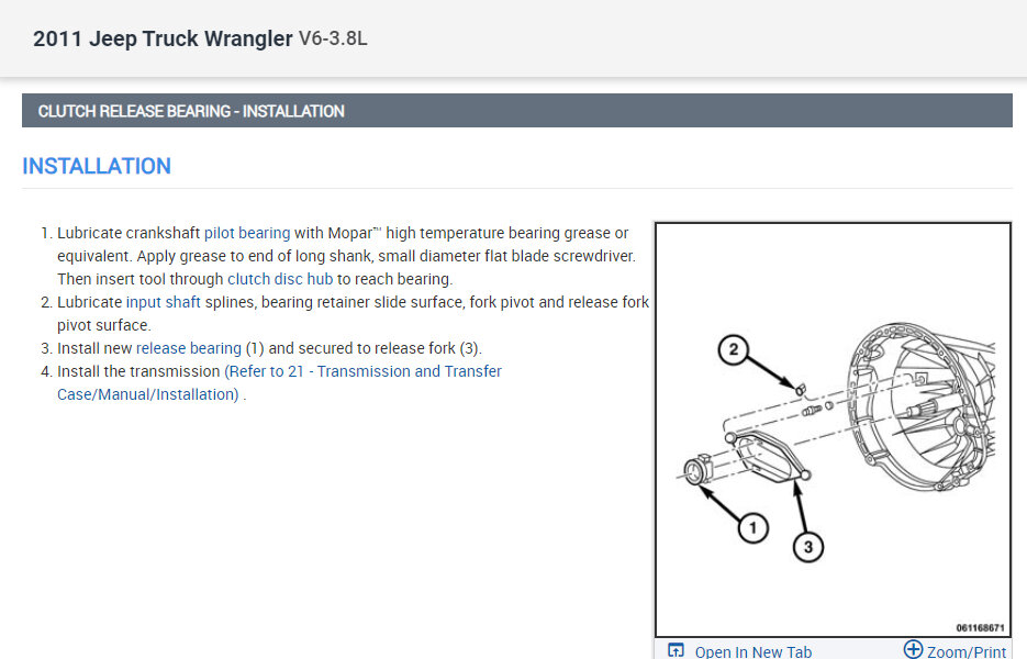

The vehicle listed above is a Sport model with 6speed manual transmission. I am on my 4th slave cylinder. Clutch was replaced about a year ago (+/- 30k miles) slave has failed 3x in last 6 months. The last time I removed the faulty slave cylinder the throw-out bearing arm was so far back and up that there's no way to install the replacement slave cylinder with the push rod in the cup of the throw-out bearing arm. The throw-out bearing and arm were replaced with the clutch a year or so ago so they shouldn't be worn. I am working on this by myself. I cannot afford a mechanic, I live in a very rural area, and I don't want to pull the transmission if I don't have to. Is it possible that the bearing arm has come off the pivot due to slave cylinder issues (the last slave cylinder pushrod was bent at almost a 90-degree angle) and can I reseat that arm without dropping the transmission?

Wow, that is a lot of slave cylinders. When they are installed, you can't allow the release lever plunger to pivot more than 2° in either direction in the slave cylinder bore. Allowing the plunger to pivot more than 2° in the bore will cause fluid to bypass the seal and result in fluid leakage and failure.
The release bearing is installed into the fork. If that has come apart, I don't feel you can reinstall it without removing the transmission. I attached some info below. That is what needs to be done once the transmission is removed.
I wish I had a better/easier answer for you. Let me know your thoughts.

Okay, I'm thinking that it's possible that the clutch fork Spring clip may have come loose.
Is there a way to get to that without cracking open the transmission bellhousing? If I do have to open it up. I'm thinking I may only have to do it an inch or two and that way I don't have to restart the transmission. Let me know what you think please.

Hi again. I was right, the clup that holds the throwout bearing arm to the pivot was nowhere to be found. It was a $10.99 fix but I had to take the jeep apart to get to it. I'm currently trying to restab the transmission amd I have about and inch to go to bolt it in. Question- should the shift with the splines spin freely once the transmission is seated? Mine does not. I didn't have an alignment tool but I never removed the clutch assembly. I ensured the angle of the transmission matched the angle of the motor when I stabbed the transmission back in place. I just wanted to be sure before I bolt it down and put everything back on.
