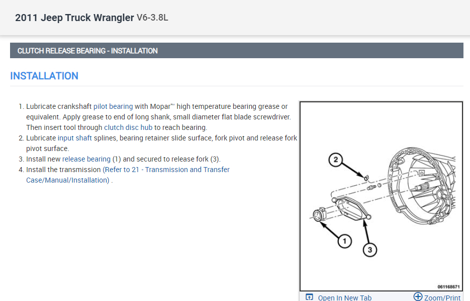

The vehicle listed above is a Sport model with 6speed manual transmission. I am on my 4th slave cylinder. Clutch was replaced about a year ago (+/- 30k miles) slave has failed 3x in last 6 months. The last time I removed the faulty slave cylinder the throw-out bearing arm was so far back and up that there's no way to install the replacement slave cylinder with the push rod in the cup of the throw-out bearing arm. The throw-out bearing and arm were replaced with the clutch a year or so ago so they shouldn't be worn. I am working on this by myself. I cannot afford a mechanic, I live in a very rural area, and I don't want to pull the transmission if I don't have to. Is it possible that the bearing arm has come off the pivot due to slave cylinder issues (the last slave cylinder pushrod was bent at almost a 90-degree angle) and can I reseat that arm without dropping the transmission?

Wow, that is a lot of slave cylinders. When they are installed, you can't allow the release lever plunger to pivot more than 2° in either direction in the slave cylinder bore. Allowing the plunger to pivot more than 2° in the bore will cause fluid to bypass the seal and result in fluid leakage and failure.
The release bearing is installed into the fork. If that has come apart, I don't feel you can reinstall it without removing the transmission. I attached some info below. That is what needs to be done once the transmission is removed.
I wish I had a better/easier answer for you. Let me know your thoughts.
