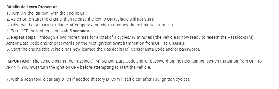

Security light stays on and I cannot start the car?
2002 CHEVROLET TRAILBLAZER
20,000 MILES
SALSAFUN458
Can I remove the pass lock chip in the PCM for a 2003 Chevy trailblazer?
Jun 20, 2023 at 5:54 AM
  • 110,244 POSTS
No, that isn't possible. We need to figure out why it is staying on. Try this and let me know the results.
Turn the key to the run position and allow it to stay on for approximately 10 minutes. The security light should turn off. See if the vehicle starts. If it does, we are going to perform a 30-minute relearn. See attached below.
Let me know what you find.
See pic below.
