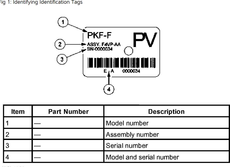

Yes but the secondary codes are different. 3w7p7000be and 4w7p7000be.
Friday, April 24th, 2015 AT 7:50 AM
1BADMERC
MEMBER
5 POSTS
Correction 3w7p7000be and 4w7p7000ea.
Friday, April 24th, 2015 AT 7:53 AM
HMAC300
MECHANIC
48,601 POSTS
That is for production. See pic
Image (Click to make bigger)
Friday, April 24th, 2015 AT 8:03 AM
1BADMERC
MEMBER
5 POSTS
So I should be good to go?
SPONSORED LINKS
Friday, April 24th, 2015 AT 8:26 AM
HMAC300
MECHANIC
48,601 POSTS
Yes the numbers you se on what I sent is just an example it should be fine
Friday, April 24th, 2015 AT 8:40 AM
1BADMERC
MEMBER
5 POSTS
Thank you so much for the help.
