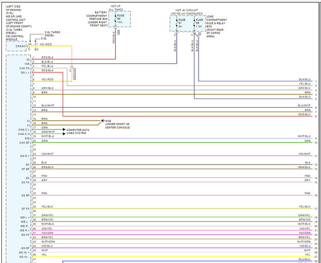

I have a random sporadic inop of blind spot, turn signal and cruise control, as well as SRS fault. I can't connect scan tool because DLC is inop as well. The fuse seems fine but clearly something is taking down the CAN network. I found water in the trunk from a worn-out seal and found corrosion on the fuse/relay panel on the trunk floor. However, I don't see any real damage and the wiring was taken apart and cleaned. I suspect it may have affected other controllers (i.e. the SAM(s). I did not see any obvious signs of damage or corrosion on the rear SAM or front SAM.
I am trying to see what is common on these systems to narrow down the search.

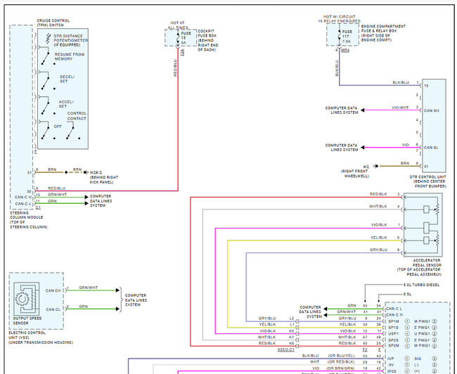

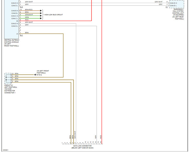

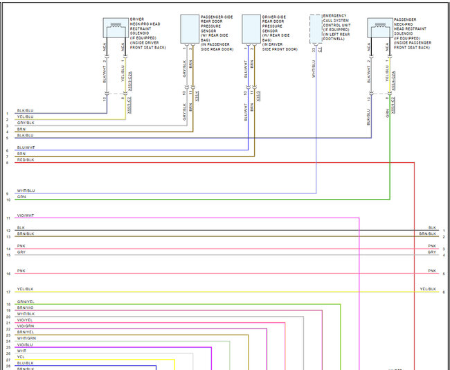

We are working blindly without the DLC working so we should concentrate on that first. Let's check fuse #58 7.5 amp with the ignition system on to see if the fuse has power. This guide can help:
Both brown wires on the DLC need to be grounded as well. Here is the wiring diagrams so you can see how the connector works. Check out the images (below). Please let us know what happens.

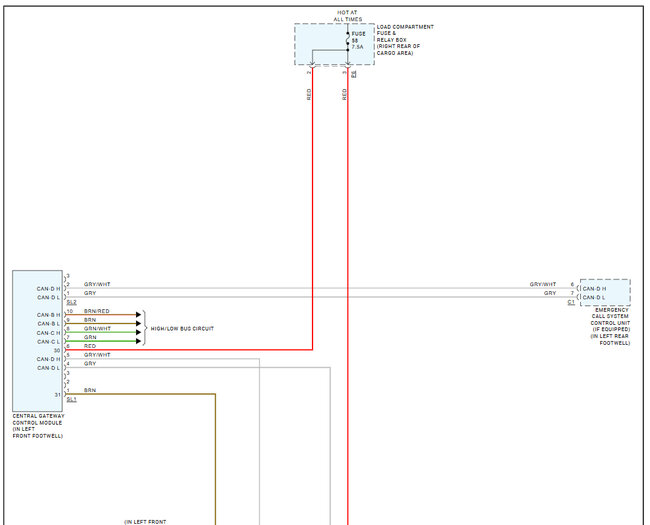

I've already checked that. That was the first thing I did. I have power and the fuse is good. But I will use these diagrams to check everything at the DLC - power, ground and Bus voltage levels (this will also tell me if there is a faulty node taking down the network).

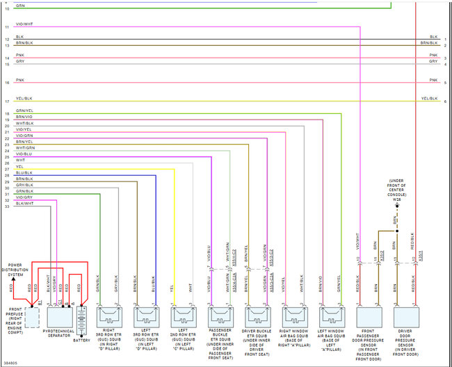

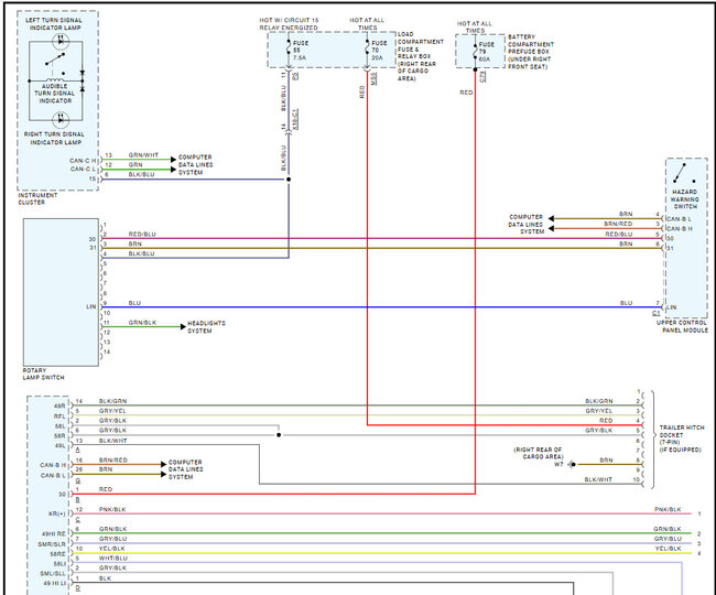

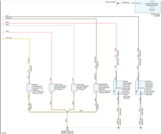

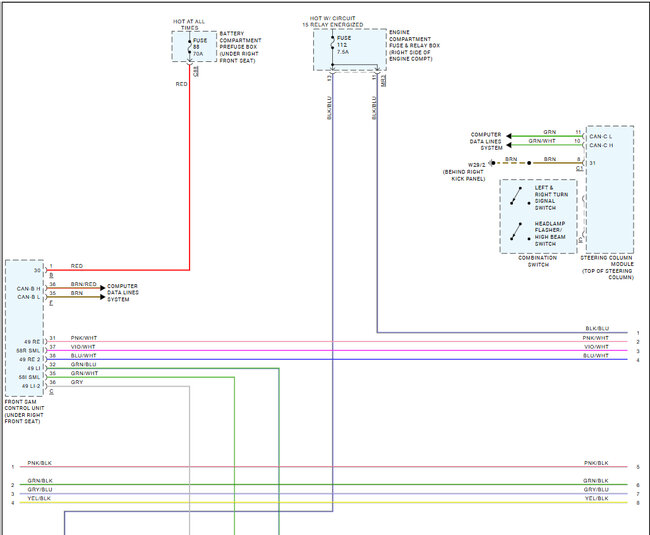

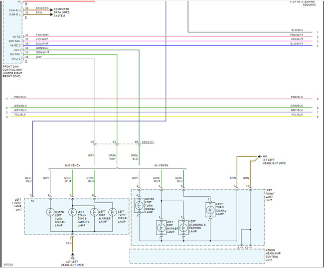

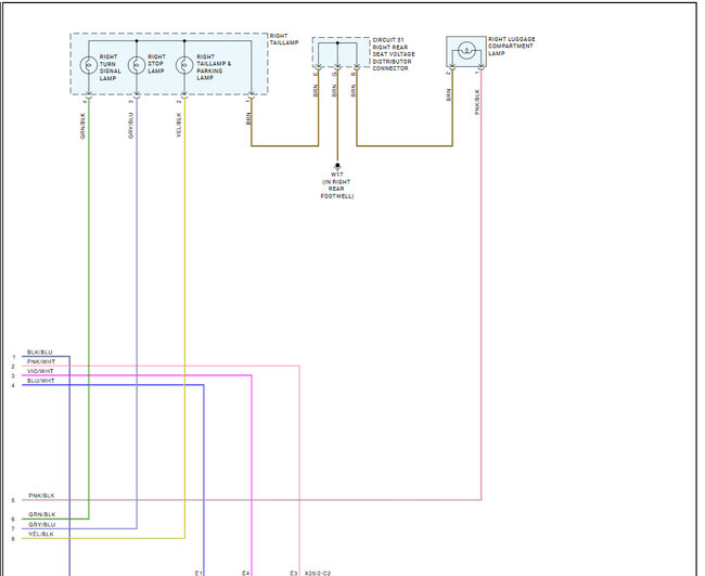

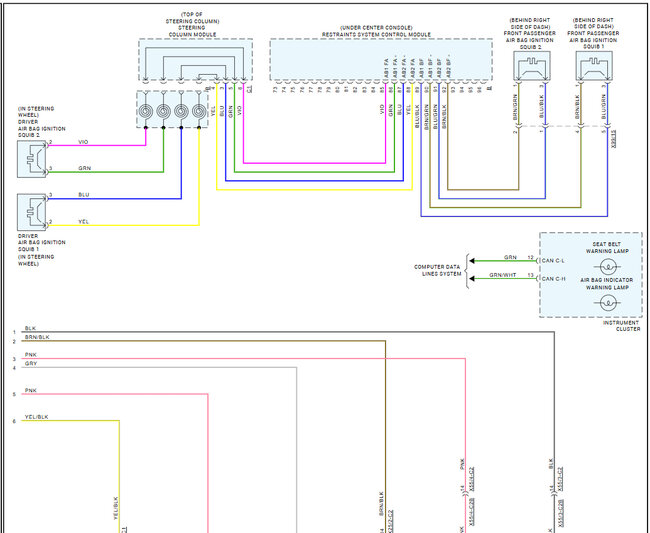

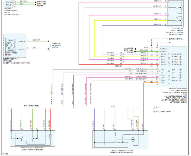

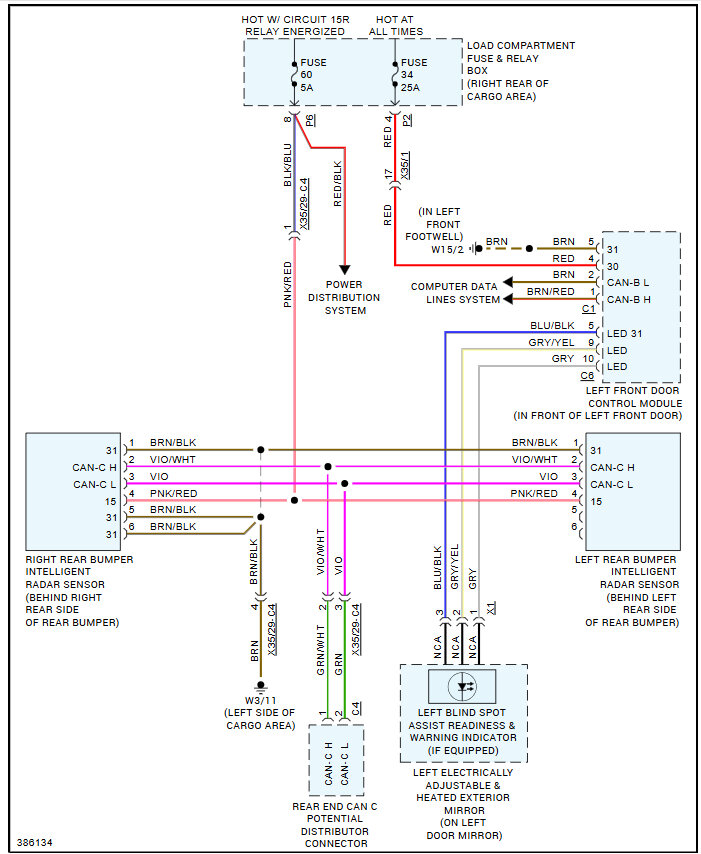

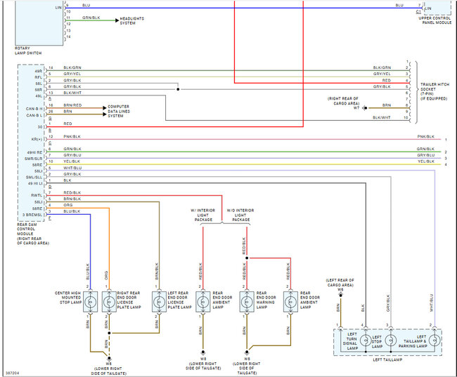

Sure, here are the wiring diagrams for the blind spot, SRS, turn signals and cruise control. Check out the images (below). Let us know how it goes.
Dec 25, 2024 at 2:37 AM
SPEEDRACER3
  • 25 POSTS
Progress has been made; The common line to all these systems was the Central Gateway. It had no power (same as the DLC connector). I found that the two wires from Fuse 58 were broken at the terminal crimp site (was not obvious until you pulled them out with some force). This was the cause for the DLC not having power and the second wire from this fuse powered the Central Gateway. This is explained why I had no CANbus and everything was going haywire. A quick and dirty test of connecting those wires to power brought everything back online and working again.

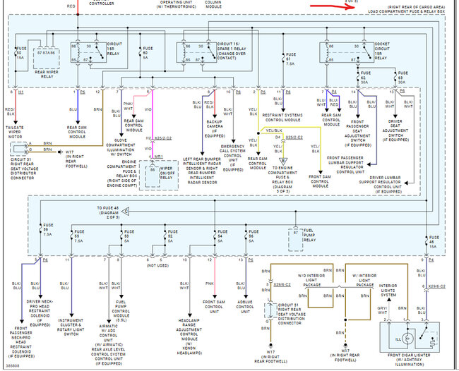

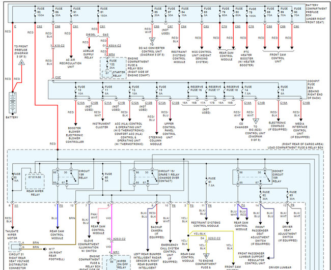

That said, there is a ton of corrosion and damage on the bottom of the fuse/relay panel and each one needs to be removed and cleaned or repaired. Other wires are broken from corroding for so long. Is it possible to have wiring diagrams of the fuse/relay panel in the cargo area (trunk)?
Also, would anyone happen to know what terminal type is used in the connectors for this panel? They look like they could be (MQS)MQP 2.8, but I'm not entirely sure. The locking system seems different.

Sorry don't know the terminal connectors, I would reach out to the Mercedes parts department. Here are the fuse panel wiring diagrams, good find on the wiring issue.
