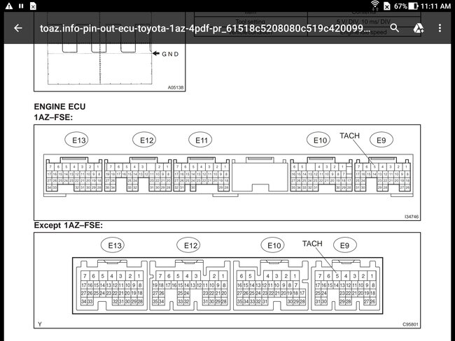

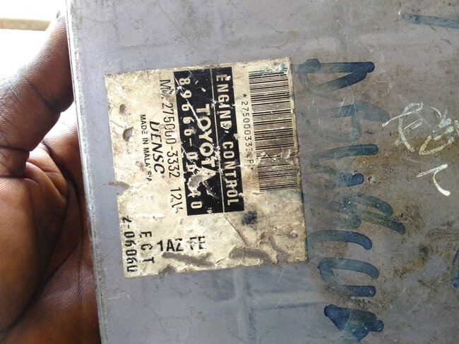

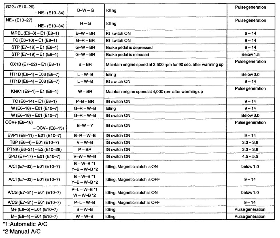

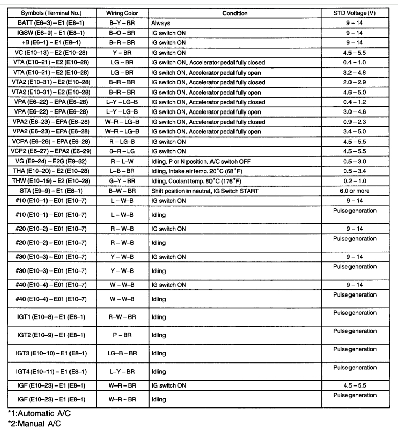

Can i get ECM pinout value for this ECM?
2002 TOYOTA CAMRY
1,234,567 MILES • 2.0L • 4 CYL • 2WD • AUTOMATIC
MALLYBOY
  • 329 POSTS
This vehicle does not communicate when you plug in the SCANNER, the tachometer and speedometer are not working so I need the ecu pin out diagram to trace the fault.
Edmonton no:89666-06340
Engine type:1AZ-FE
Sep 18, 2024 at 7:56 PM
  • 55,224 POSTS

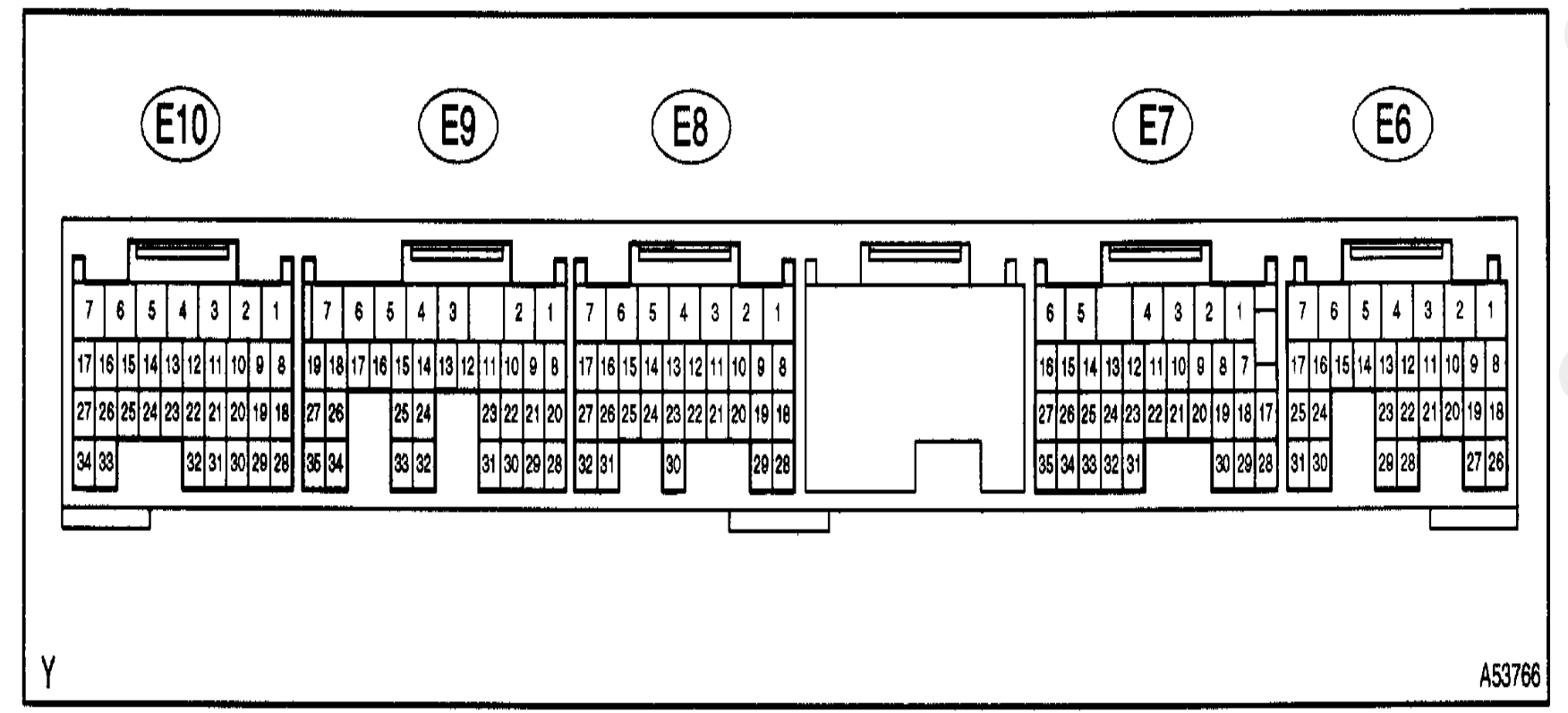

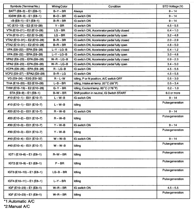

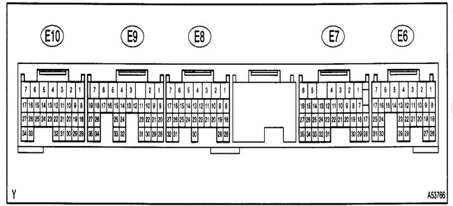

Sure, here are the ECU pinouts for the electrical connectors. Check out the images (below). Let us know if you need anything else.
Sep 19, 2024 at 3:44 AM
MALLYBOY
  • 329 POSTS

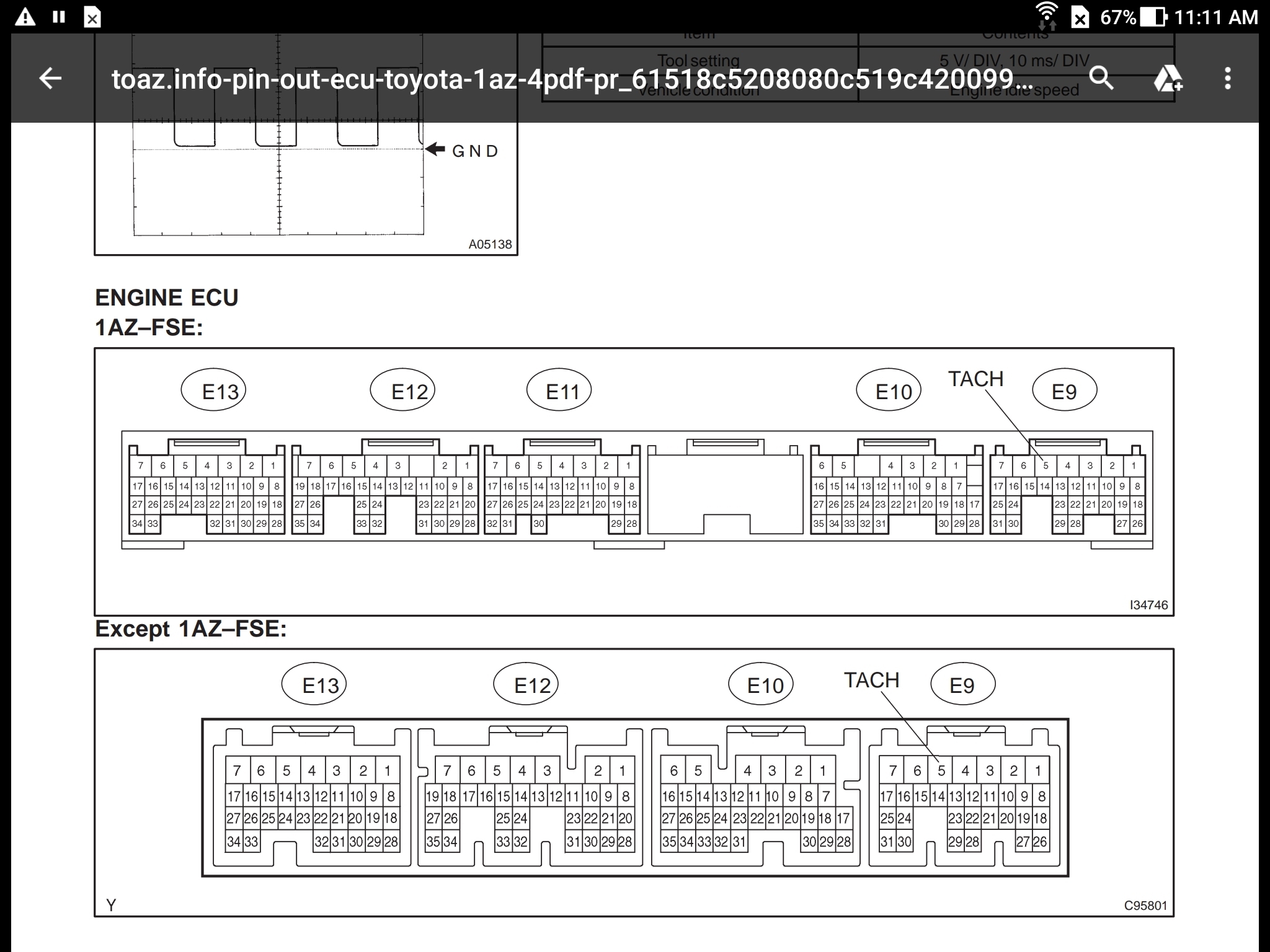

This is not the end I sent to you. The one I sent to you has 4-end connectors while the one you sent has 5-connectors, look at the image below.
Sep 19, 2024 at 8:17 PM
  • 55,224 POSTS
I can only look up the engine control module for a 2002 TOYOTA CAMRY. I don't have a part number reference. Do you have another car you want me to try?
