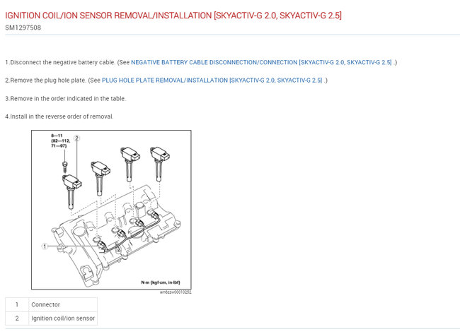

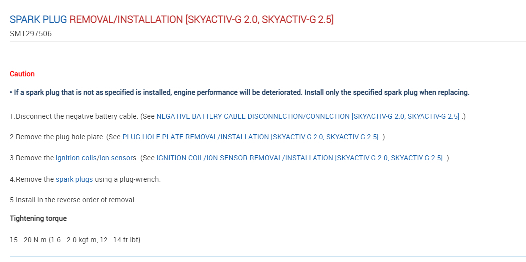

Can i drive on two cylinders safely to a garage?
75,000 MILES • 2.0L • 2WD • AUTOMATIC
MIKE JACKSON4
could only install two sparks plugs and have problems with the other two. Can i drive a short distance to garage?
May 14, 2022 at 7:20 AM
AL514
  • 5,685 POSTS
Hello, what kind of issues are you having replaced the other two spark plugs? I would not drive with two spark plugs out of the engine, which is not safe. What sub-model is this, Sport, Grand Touring, Touring?
https://www.2carpros.com/articles/how-to-change-spark-plugs
May 14, 2022 at 8:58 AM
MIKE JACKSON4
the threads got crossed putting new ones in. They will not seat all the way down. I have the i touring model.
May 14, 2022 at 9:13 AM
AL514
  • 5,685 POSTS
Sorry to hear that, the reason I would not drive with plugs out is that the fuel injectors are still going to be firing and without spark plugs in the cylinder head, that unburned fuel is just going to shoot out of the cylinder and on top of the engine. There could be a good chance of a fire. Plus, you won't make it far running on two out of four cylinders. Have it towed or flatbed to the shop.
May 14, 2022 at 9:26 AM
MIKE JACKSON4
Thank you for the insight. I'll have to take the trip of shame to the shop. Mike
