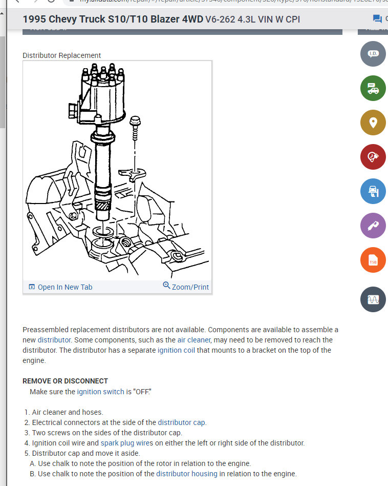

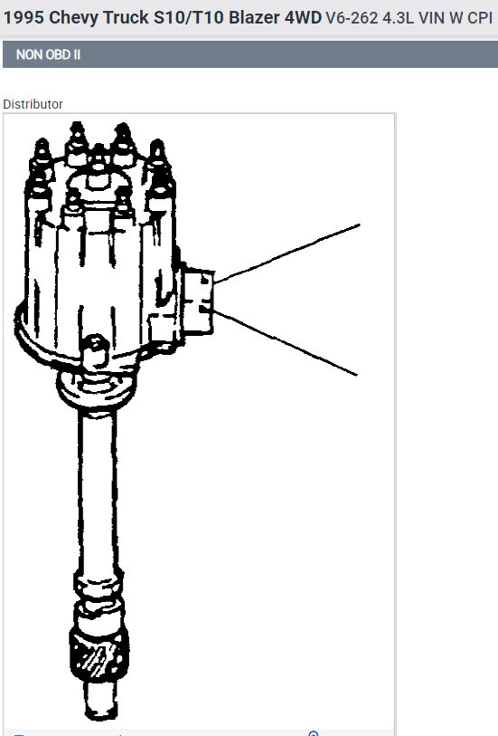

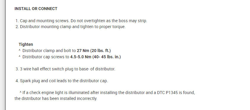

Can I change the distrubutor without taking the engine out? Or moving the engine?
150,000 MILES • 4.3L • V6 • 4WD • AUTOMATIC
2CP

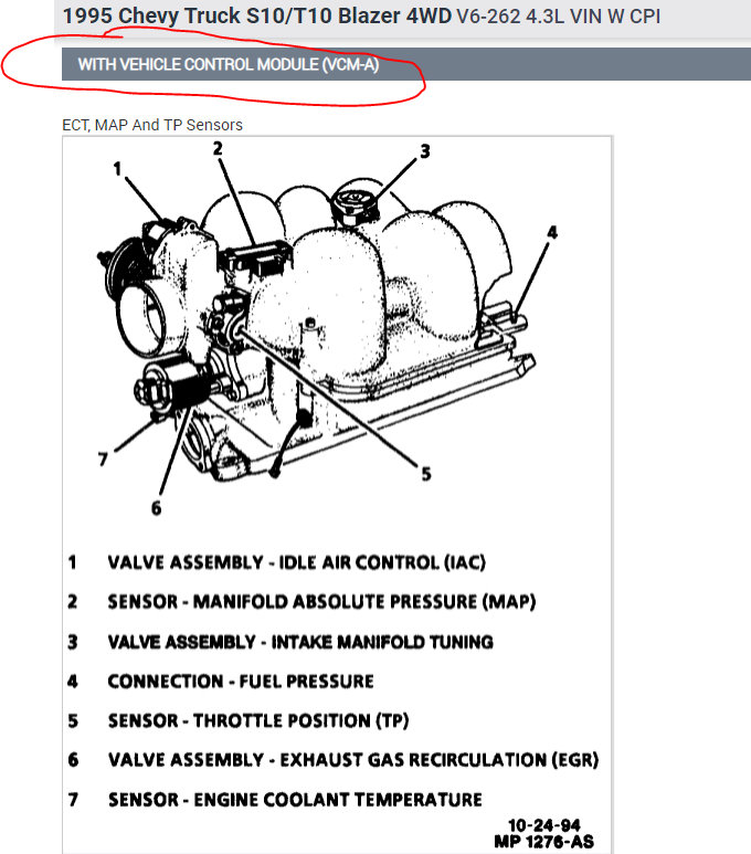

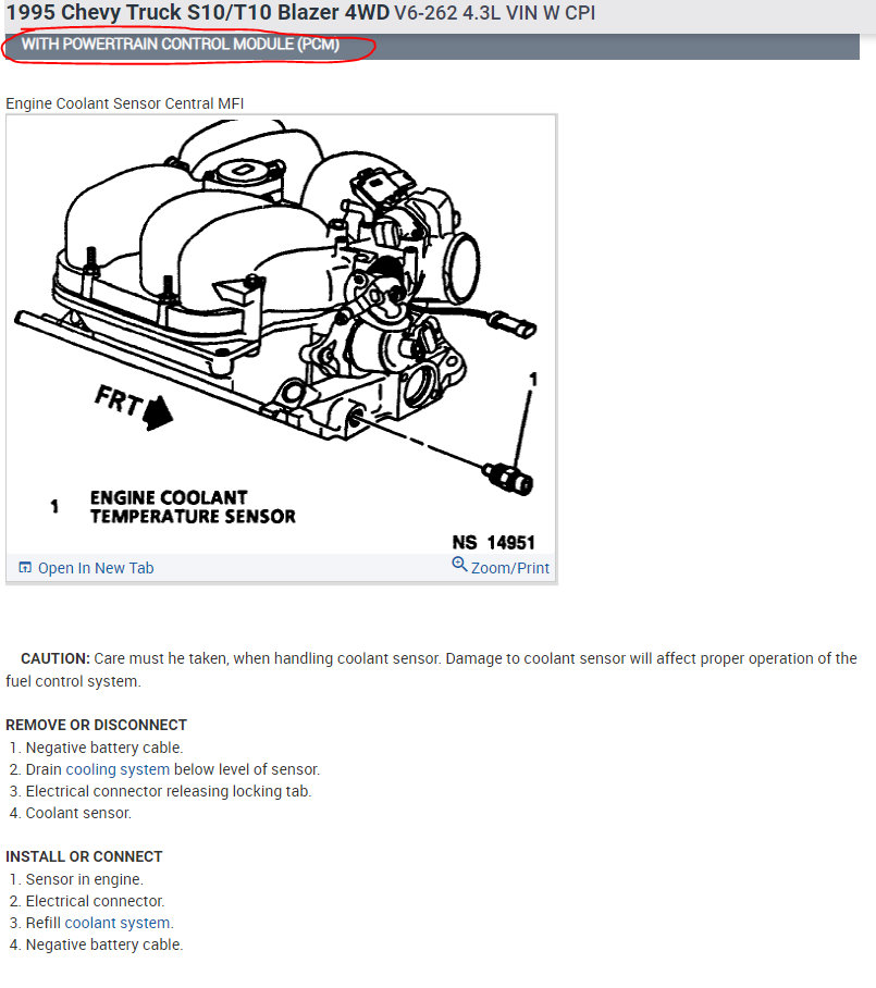

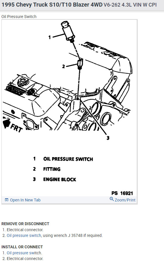

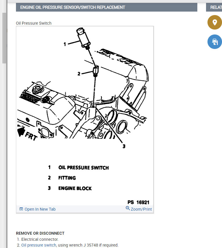

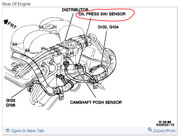

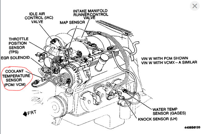

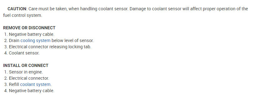

Is that the (1995 Chevrolet Blazer LS 4x4 Deluxe) oil temperature sensor in the front of the engine or the temperature sensor? Or are they the same but different names?
I have a (ACR-12V-3 1963) that came out of mine and it was dirty so I cleaned it, should I replace it, or is it ok cleaned up?
Also what is the correct spark plug to use for it. I used a Autolight 45 and it worked.
Aug 5, 2021 at 5:03 AM

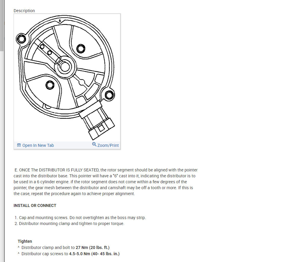

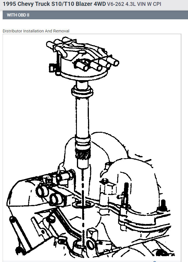

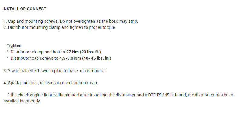

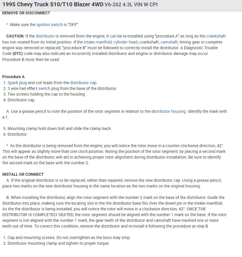

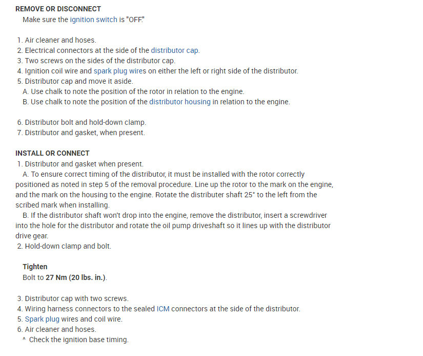

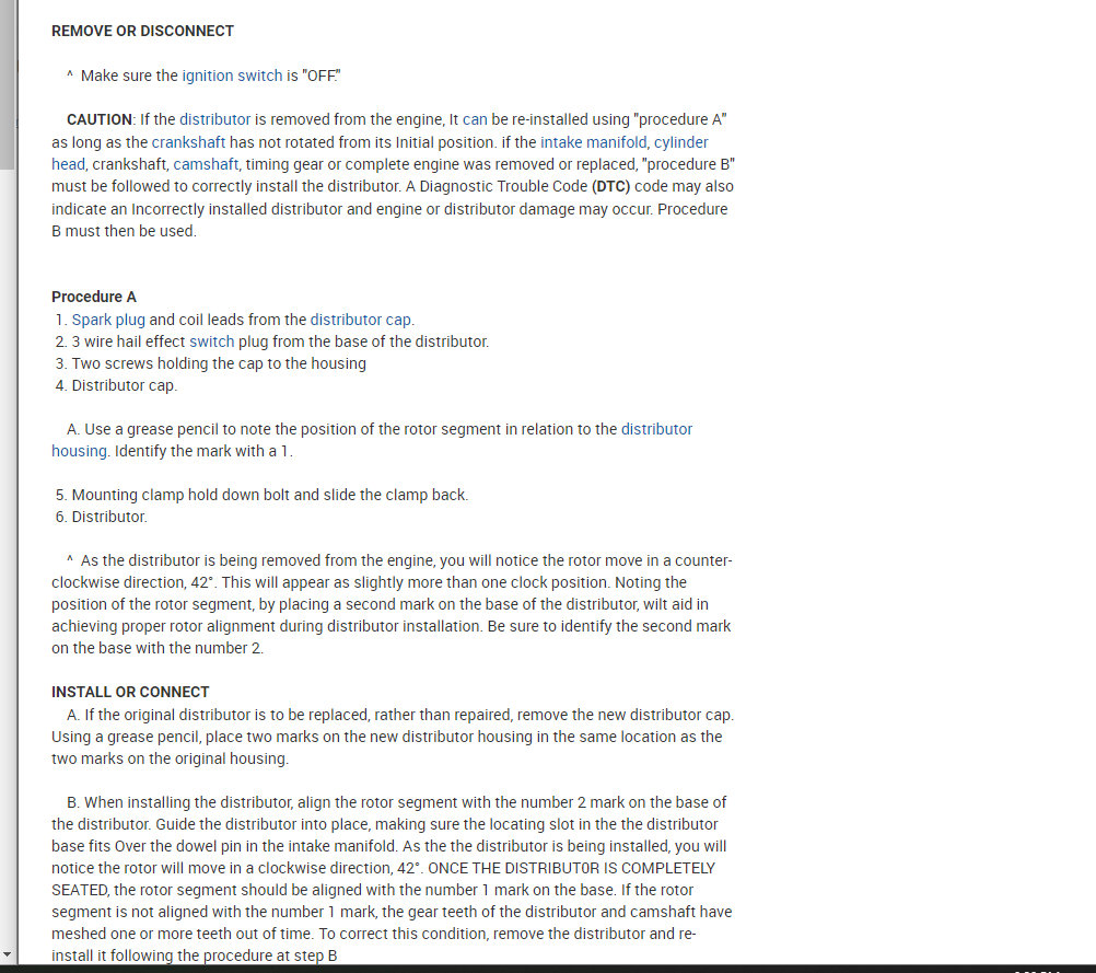

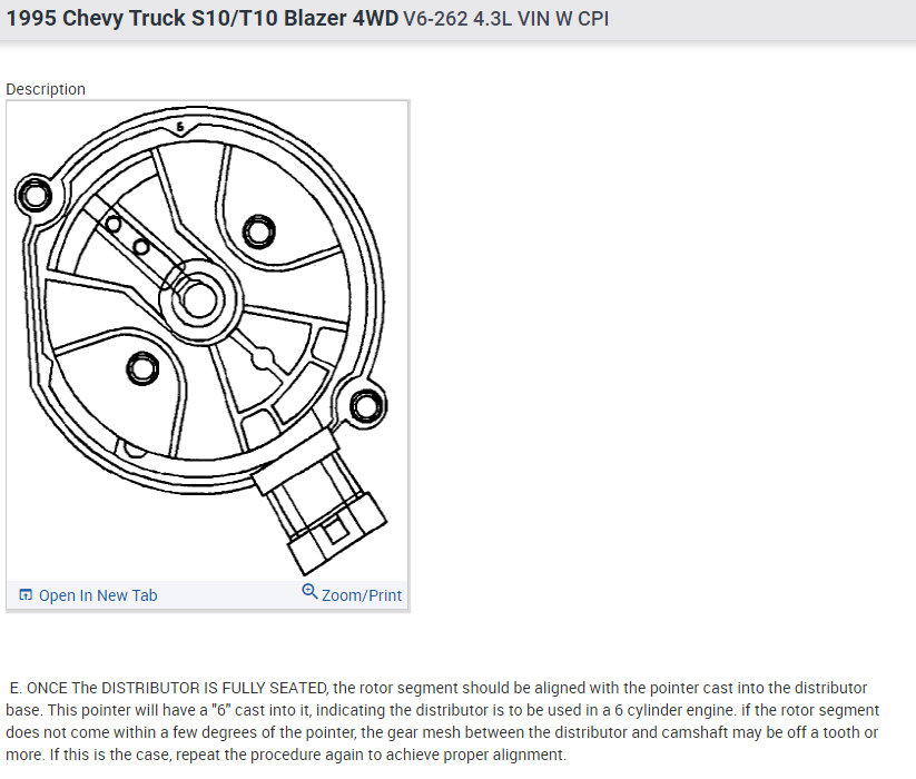

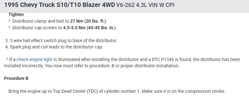

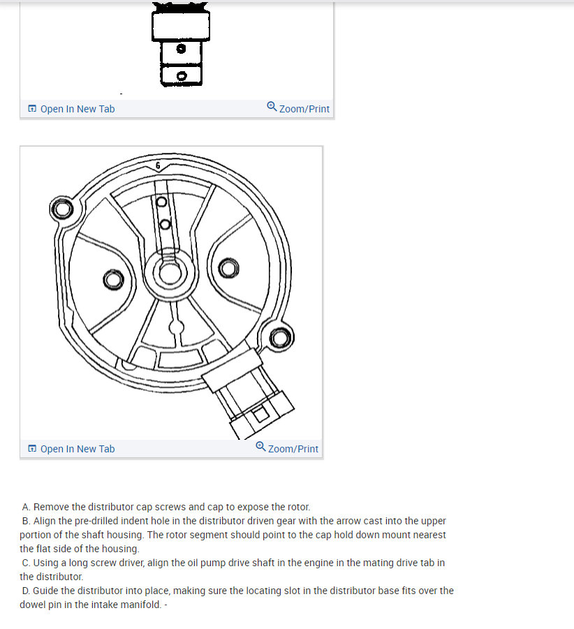

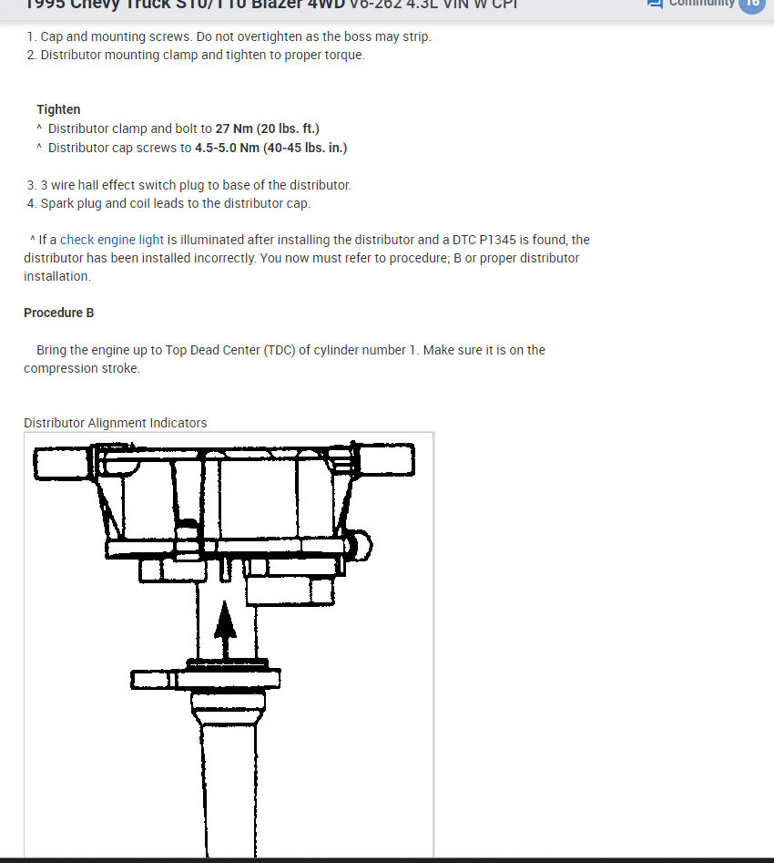

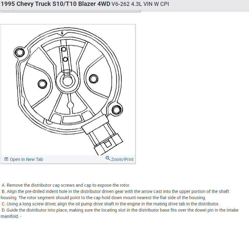

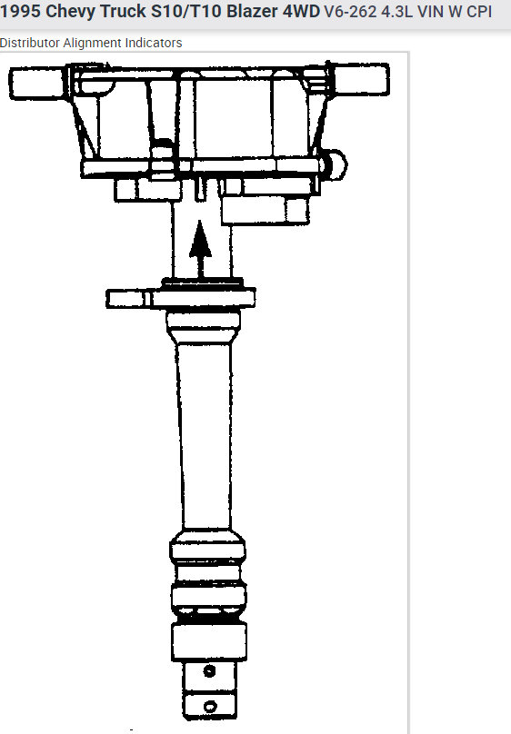

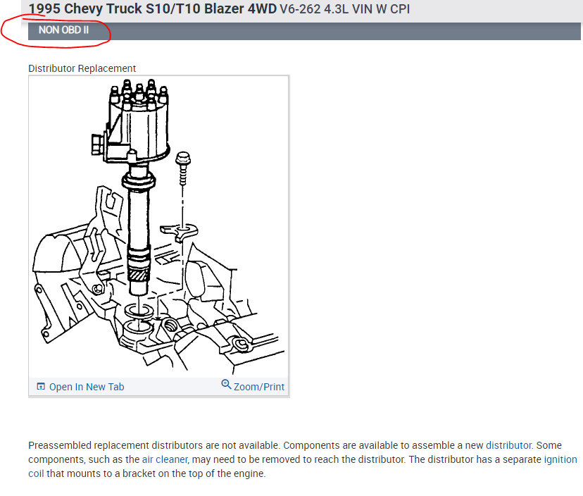

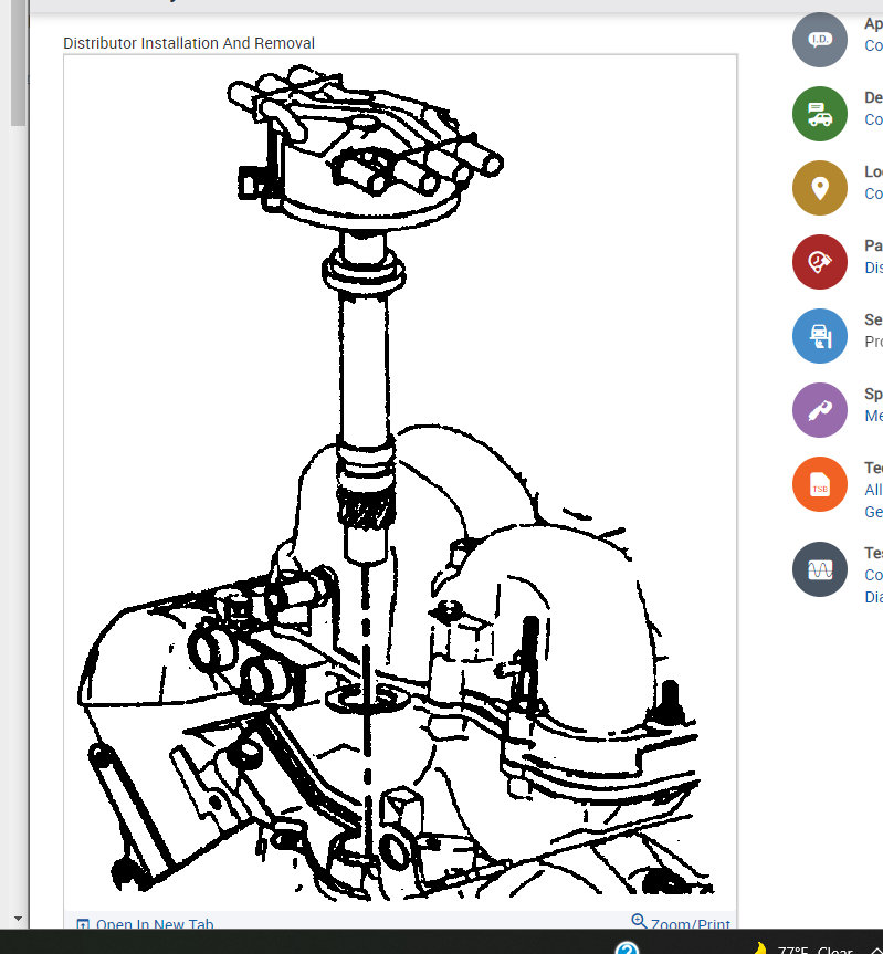

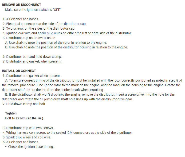

I am attaching the process below on how to remove the distributor for both the OBD II and non OBD II (OBD I) system.
Basically you just need to take the cap off and that should give you the space that you need in order to remove it.

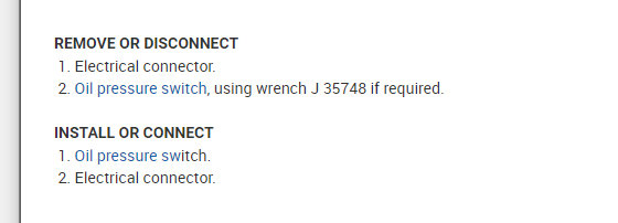

I am attaching the info below for this and the oil pressure sensor. There is not an oil temperature sensor so I assume that you are meaning the pressure sensor.
https://www.2carpros.com/articles/high-or-low-engine-oil-pressure
Please review the info below.

You should not have to remove the engine in order to get the distributor out.
This was the change over year for the Blazer. So some of the 1995 had OBD I and others had OBD II. I have attached instructions for both.
The coolant temperature sensor is located on the front of the engine, right below the intake tube. Back of the engine is the oil pressure switch. See diagrams for both.

https://www.2carpros.com/articles/how-a-coolant-temperature-sensor-works
