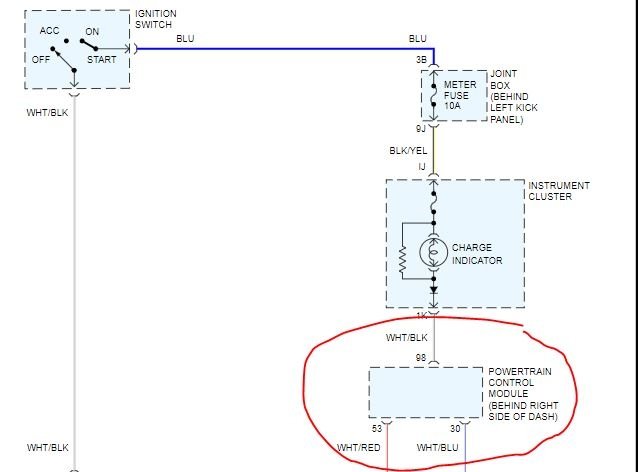

Hello My Fellow Minions, Well it all started about 1.5 years ago. My alternator went bad. Tore out the axle (yes I said axle LOL) got new one in and it was bad out of the box. Dummy me for got to have it tested first.Good practice not!
Did it all over again. Second one lasted one month, third about six months,fourth about ten months. which was back in March of 2019. Tore out and replaced alternator just to find out it was my computer. The ECM had a bad ground, so I sent it off got it back and still not working. Sent it back and a microprocessor was bad. Blue Streak got a whole different one and nothing. My vehicle still is not charging and I cannot afford the mechanic again. Is there any way to bypass the ECM controlled internal voltage regulator with an external one??
Any and all help will be appreciated.
Thanks for helping.

I hate to say it, but no. The ECM regulates voltage based on sensor readings it receives. An external one won't work.
I wish I had a better answer for you.

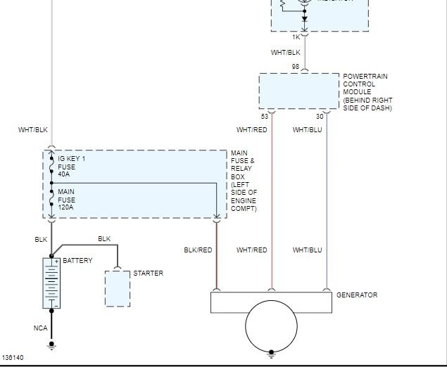

Thank Friend, I was told by Mazda( that a whole other story) that i needed new wiring. Do t'all have a diagram of where I find the wires on the ecm pluug??? Or do bI just look for the same color? Which I think are white with red stripe and white with blue stripe. That is my last ditch effort cause I had the computer replaced soooo maybe that would fix it or help me decide to scrap it or ???
ThankX in advance Bobby B

I do have schematics, but I need to confirm something. You indicate this has a V6 3.0L engine. Everything I have shows it to be a 2.5L V6. Is that correct? I ask because different engine are offered in different countries, and I don't want to give you bad info for your vehicle.

Imma dipstick, yes it's 2.5l. Guess I'm just wishing for a bigger engine.

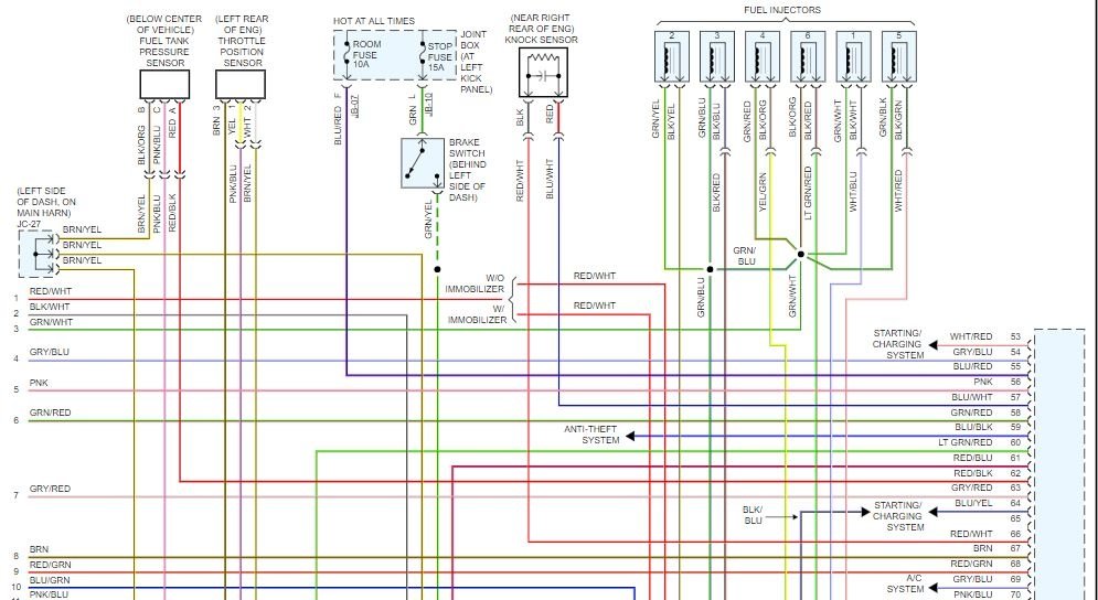

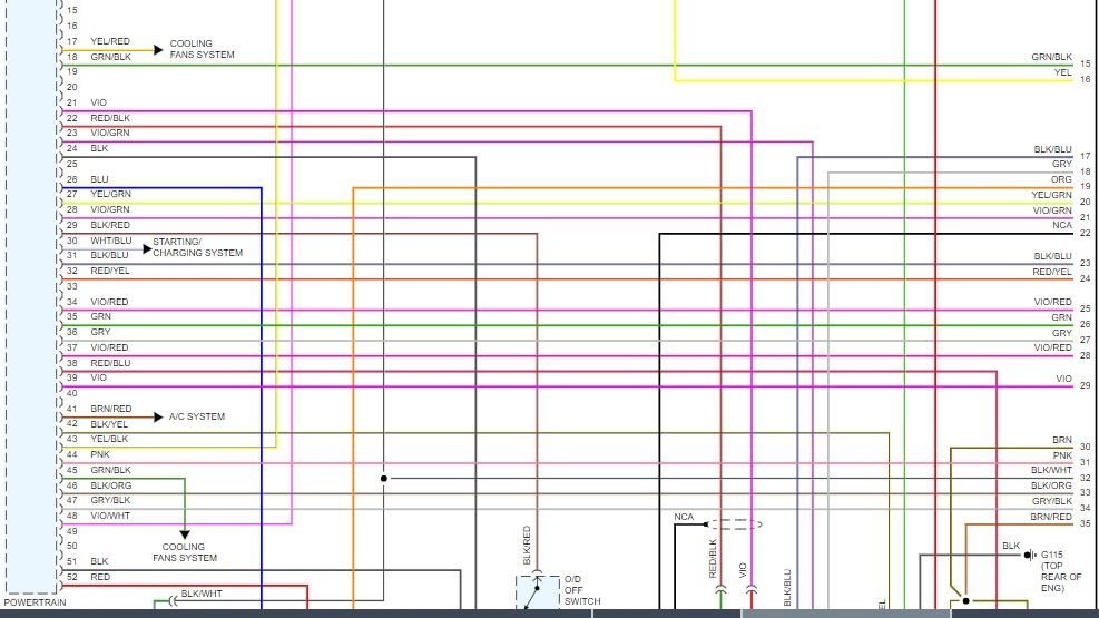

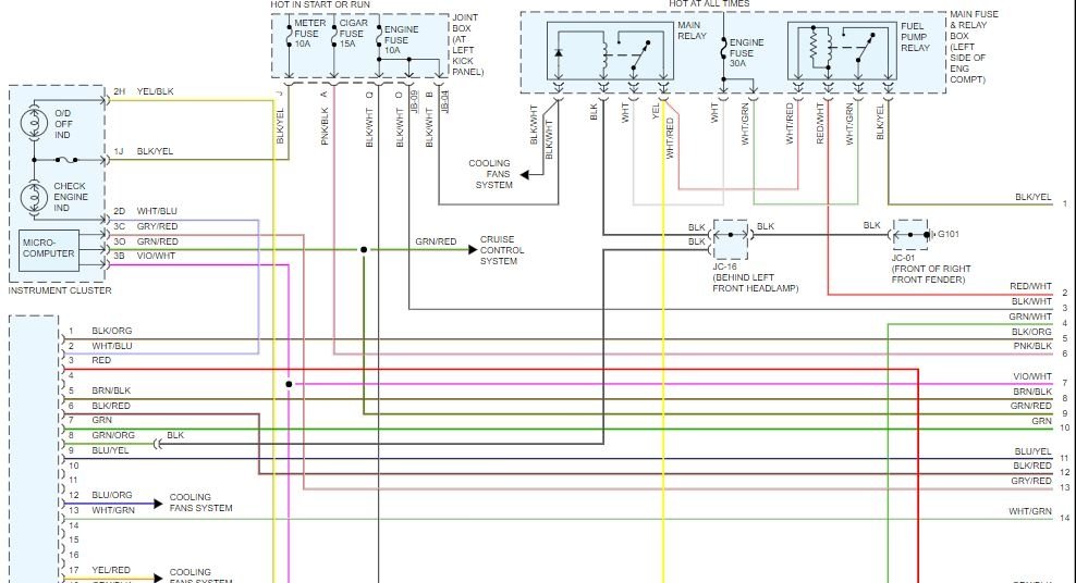

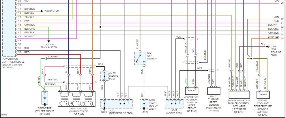

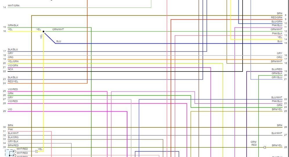

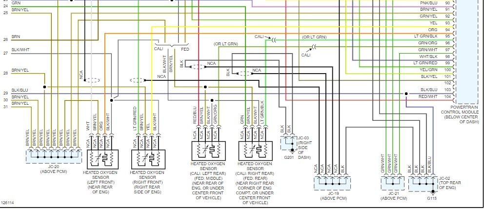

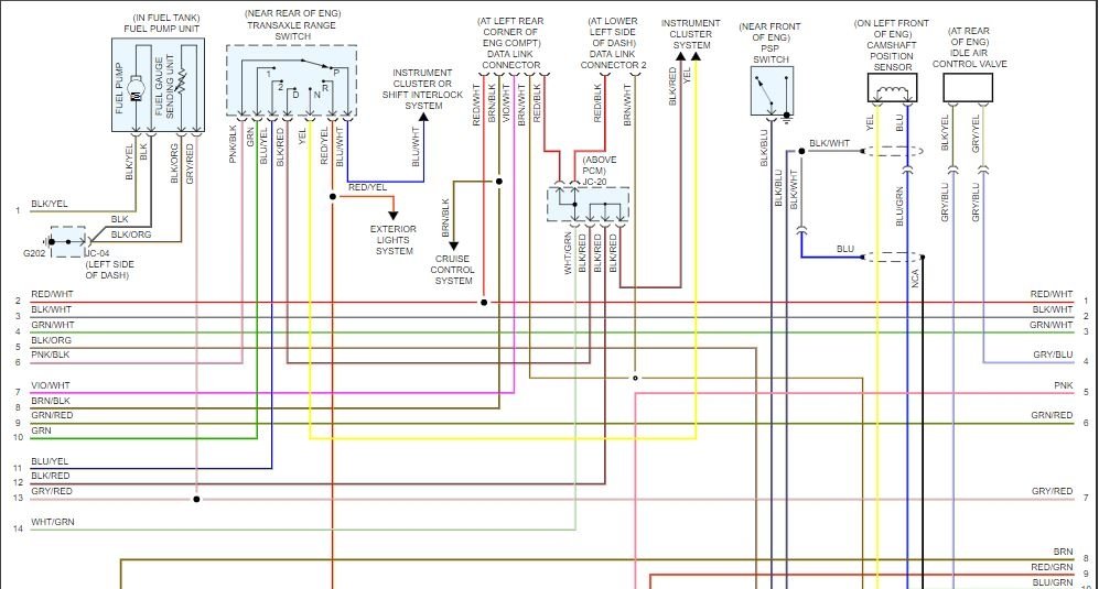

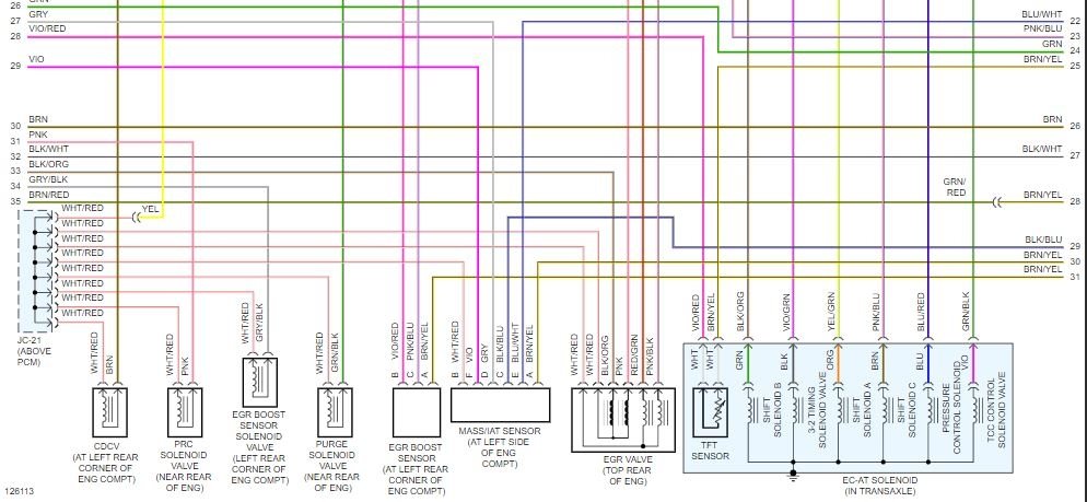

I attached the wiring schematics related to engine controls/PCM. I had to cut them down so they were readable, but I did overlap them so you can follow. The first two pictures are specific to the charging system.
I attached the entire schematic which shows the PCM connectors as well as what goes to them. Let me know if this helps.

My luck is rotten lately. The diagram did not load. It has that generic pic in upper left corner. if I right click to open it I get this:

Interesting. I will send it in two parts. Maybe it was too big.

your diagrams helped but no luck. I have wasted $700.00 and i am done. It's off to the junk yard. now my daughters 2005 Kia Rio is not idling nor accelerating right. how do I test the TPS and is the idle air control valve be part of the problem? As always many Thanks.
