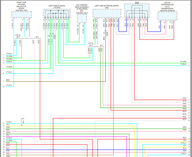

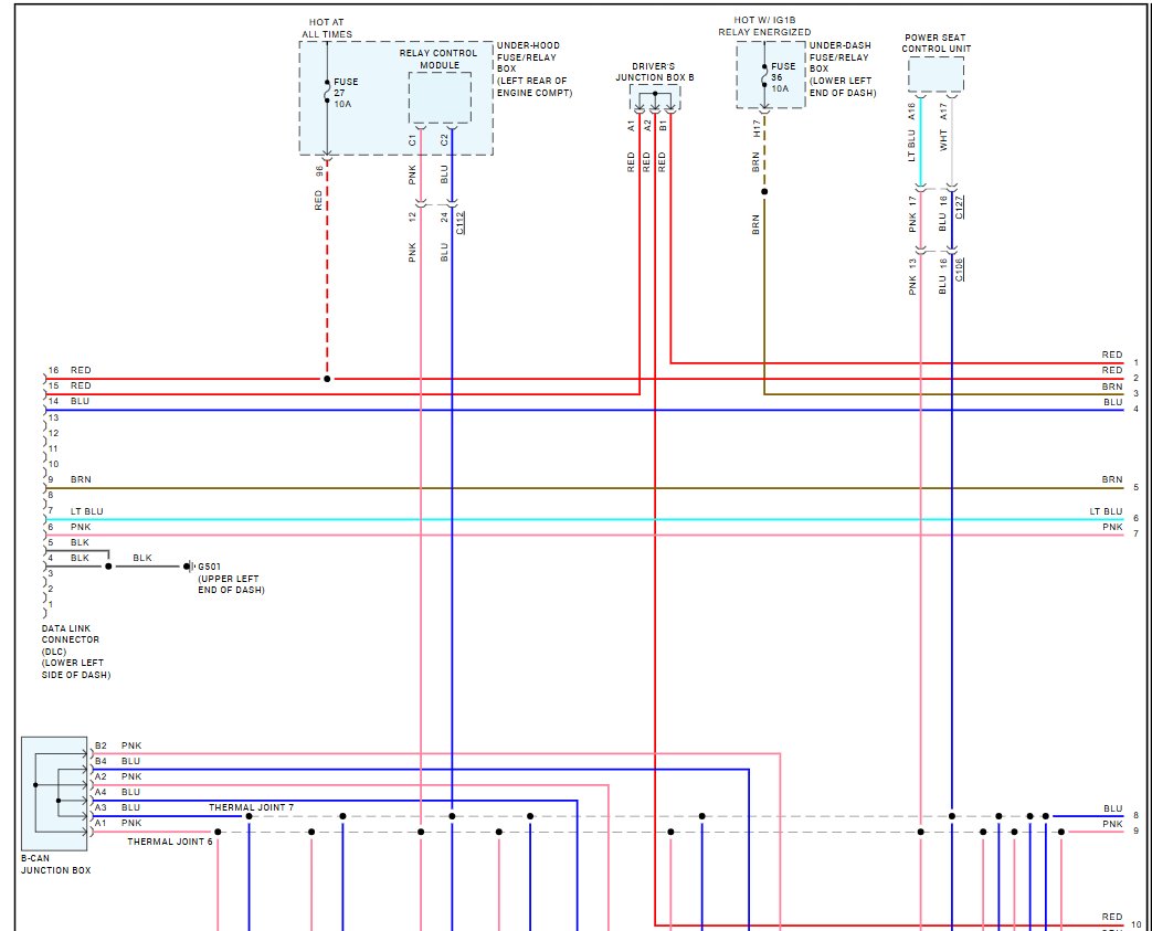

I'm working on the car listed above Sport 1.5T that I purchased from auction as a flood vehicle. I've replaced several major electrical components including the BCM, fuse boxes, spark plugs, and CAN Gateway Module. The ECM was sealed well, so I did not replace it.
Before replacing the CAN Gateway, the immobilizer system and BCM were functioning normally — I was able to scan all systems, and the immobilizer light was off.
After installing a different CAN Gateway module, the U0056-00 code disappeared, but now I’m getting immobilizer issues — specifically a red immobilizer light flashing on the cluster, and the car cranks but will not start.
Currently, the car has multiple U-codes across key modules:
ECM:
U1029 – Communication problem on CAN
U0151 – Lost Communication with BCM
TCM:
U0155 – Lost Comm with Instrument Cluster
U0100 – Lost Comm with ECM
U0038 – CAN Bus A Off
U0146 – Lost Comm with GCM
U0129 – Lost Comm with ABS
ABS:
U0126-00 – Lost Comm with Steering Angle Sensor
U0123-00 – Lost Comm with Yaw Rate Sensor
U0402-68 – Invalid Data from TCM
U0151-00 – Lost Comm with BCM
U0129-00 – Lost Comm with ABS
ESP:
U0416-68 – Invalid Data from VSA/ABS
U3000-49 – Internal Module Error
Instrument Cluster (GCM):
IDAS (ADAS Module):
U0420-68, U0418-68, U0402-68, U0416-68 – Invalid data from multiple sources
I’ve confirmed:
Fuel pump is working
Spark plugs were changed
Injectors have power, but no pulsing
CAN voltages at the OBD2 port are both 2.49V (normal idle voltage)
CAN High and Low resistance is 120Ω, which suggests only one terminating resistor is active
I also verified:
Injectors and ignition coils show voltage but behave like both wires are grounded (no pulsing from ECM)
BCM was programmed and functional before the CAN Gateway swap
All modules are now throwing U-codes that suggest a communication breakdown, possibly blocking immobilizer sync
My main concern now is that after replacing the CAN Gateway module, the immobilizer light came on and now the scanner shows an immobilizer system fault, even though that wasn’t the case before. This raises the question of whether:
The new CAN Gateway is incompatible
There's a VIN mismatch or network map conflict
Or possibly ECM-to-BCM-to-GCM handshake is failing, blocking fuel/spark delivery

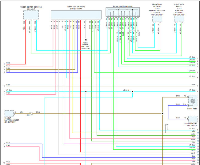

If you have experience with the 2018+ Accord platform and immobilizer logic (especially in post-flood conditions), I’d appreciate any insights into:
Whether the new CAN Gateway may need to be reprogrammed or is VIN-locked
Whether one mismatched module could explain the communication collapse across the whole bus
What your recommended next diagnostic steps would be

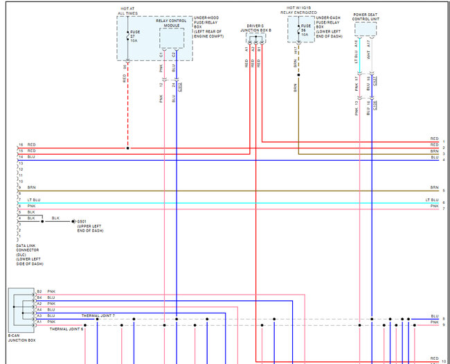

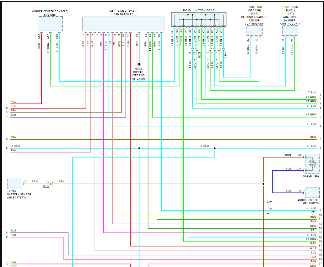

ALSOOOO please if anyone wher i can get a complete can bus wiring diagram please let me know
*** the car still crank and no start and all the the F can moduals have issues ****
Jul 15, 2025 at 7:43 AM
  • 55,433 POSTS

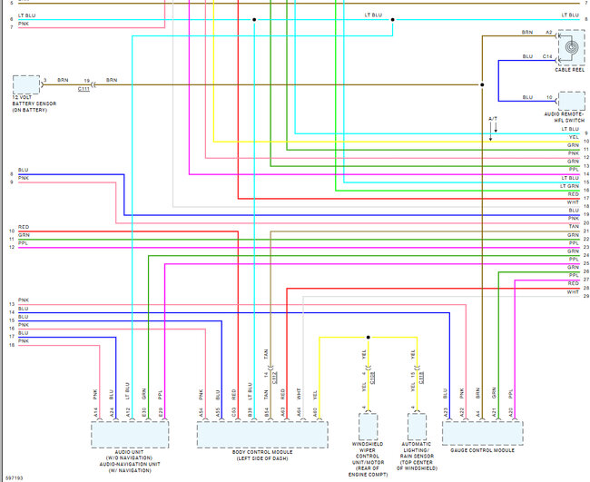

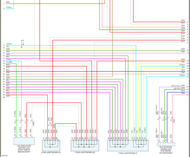

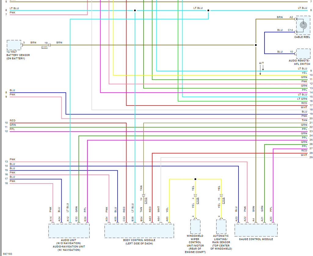

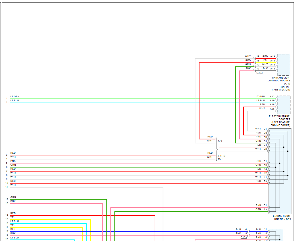

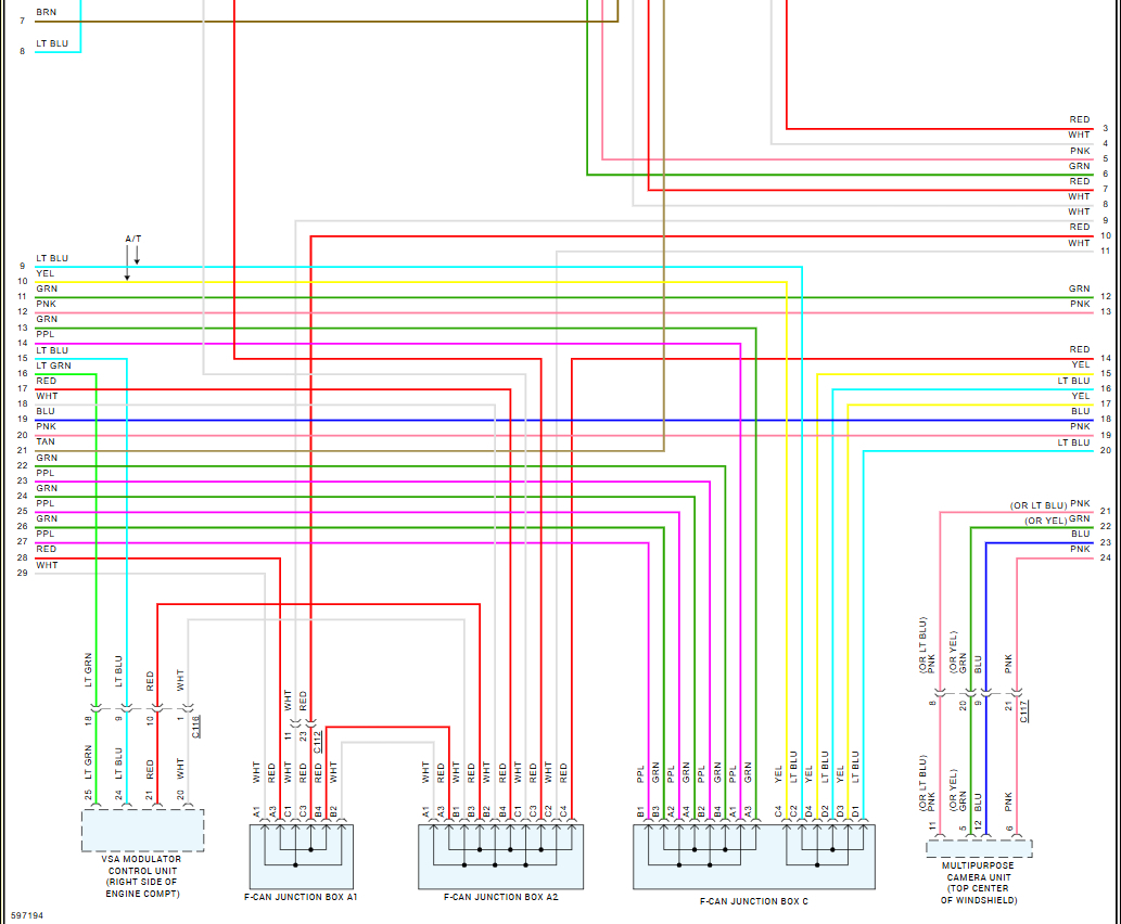

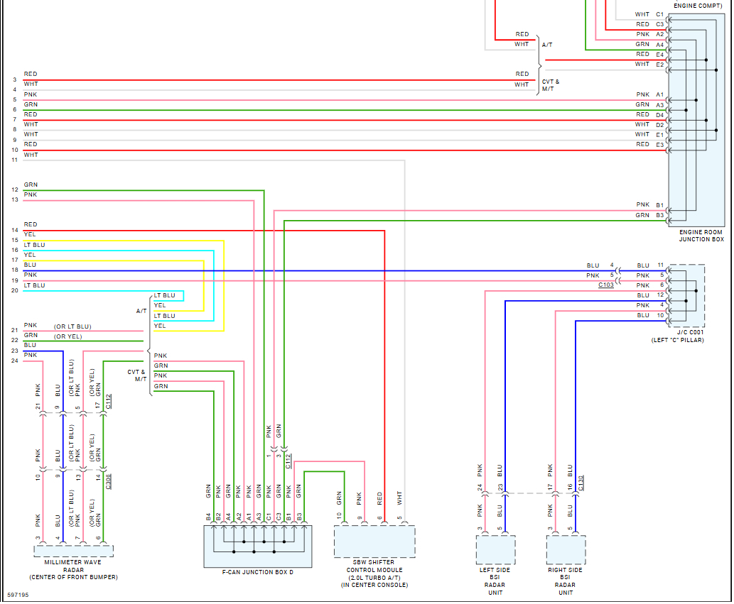

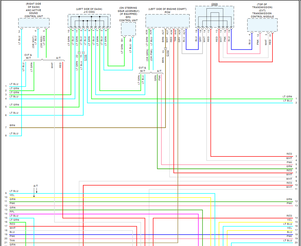

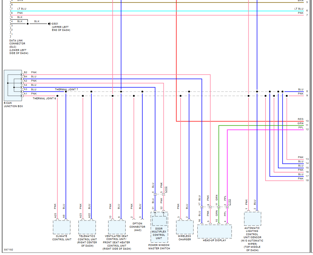

Yep, flood cars can be tough but not impossible, I will help you get the car going. The problem is most likely an incorrect or unprogrammed CAN Gateway. I would use i-HDS to relearn Immobilizer / Gateway VIN to start. The termination resistors are inside the PCM, FYI. I know the PCM is sealed but it is not waterproof so I would replace that as well. You will need to reprogram the PCM and immobilizer to the car. When you say you replaced the fuse panels, and you replace the relays as well? There are many F-CAN junction boxes I would look at from corrosion as well. Also, make sure the modules in the CAN ae getting power and a good ground. Here are the CAN BUS wiring diagrams, both high and low speed. Once you have done the repairs and confirmed the power and grounds, clear all codes and then turn the ignition on but don't try to start the engine and run a CAN scan again. Check out the images (below). Let us know how it goes.
