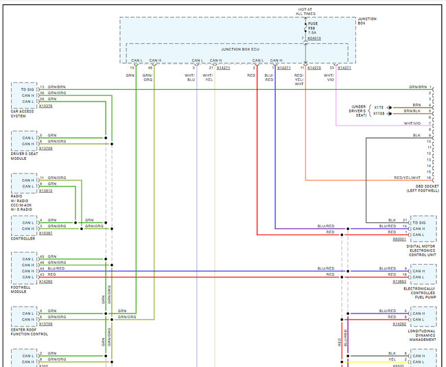

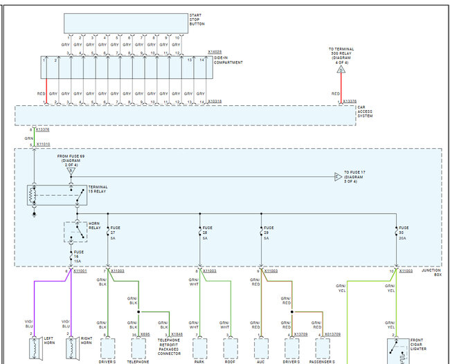

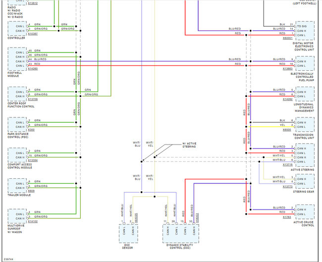

Hi Ken, I have this BMW with no communication on either module, a network can bus diagram will be a wonderful solution for me to further understand what has short the network down.
A diagram on this gate way network system will be a huge breakthrough for me.
WBAVA71056PS04834
Jan 7, 2025 at 6:37 AM
  • 55,805 POSTS
Is this a euro car? The VIN didn't work but here are the CAN bus wiring diagrams with the data connector so you can see how the system works. Check out the images (below). Let us know if you need anything else.
Jan 9, 2025 at 3:00 AM
ANDRIN ATEM
  • 414 POSTS
Diagram is on point Ken, i truly appreciate, i am replacing the Gate way module. thank you so much, this means all.

I don't see the gateway module in the CAN system?
Jan 11, 2025 at 1:12 AM
ANDRIN ATEM
  • 414 POSTS
It use the Lin network system not the Can, the gate way is same as the Junction box, after replacing it, the car could start freely, and the board opens at all times.
Jan 11, 2025 at 3:09 AM
ANDRIN ATEM
  • 414 POSTS
I replaced the gate way module and the problem was resolved, though I had to clone the module, using my mini prog to read the eeprom and write back on the replacement gateway module.

You sent two diagrams, the first diagram shows the gateway module as the junction box, this is a Europe made, so am use to solving this, with the diagram you sent made it even more easy for my son to solve without me being present.

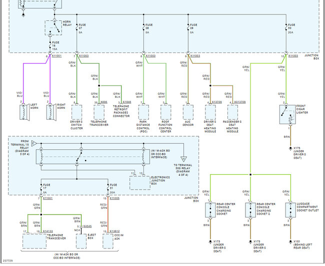

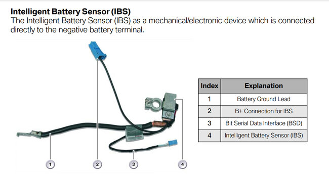

Okay, copied! I will upload videos, but what I am experiencing currently is, the steering lock does not release when the key is inserted into the slut, and the is no communication between the scan tool and the modules, but the VCI is powered on but no communication, I have checked the can bus and the Kline, there is no short to ground.
Jan 15, 2025 at 4:49 AM
ANDRIN ATEM
  • 414 POSTS
Hi Ken, I found the problem and everything is okay. The main problem was a cable that leaves the battery sensor, it had some kind of a short I can’t really tell for now, but as I unplugged it, that car starts every minute and every second of the day. Thanks very much for all efforts and diagrams you provided.
Jan 15, 2025 at 11:58 PM
ANDRIN ATEM
  • 414 POSTS
This is the image, the bit serial data interface was what caused the car not to start.
