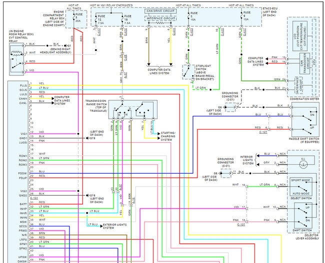

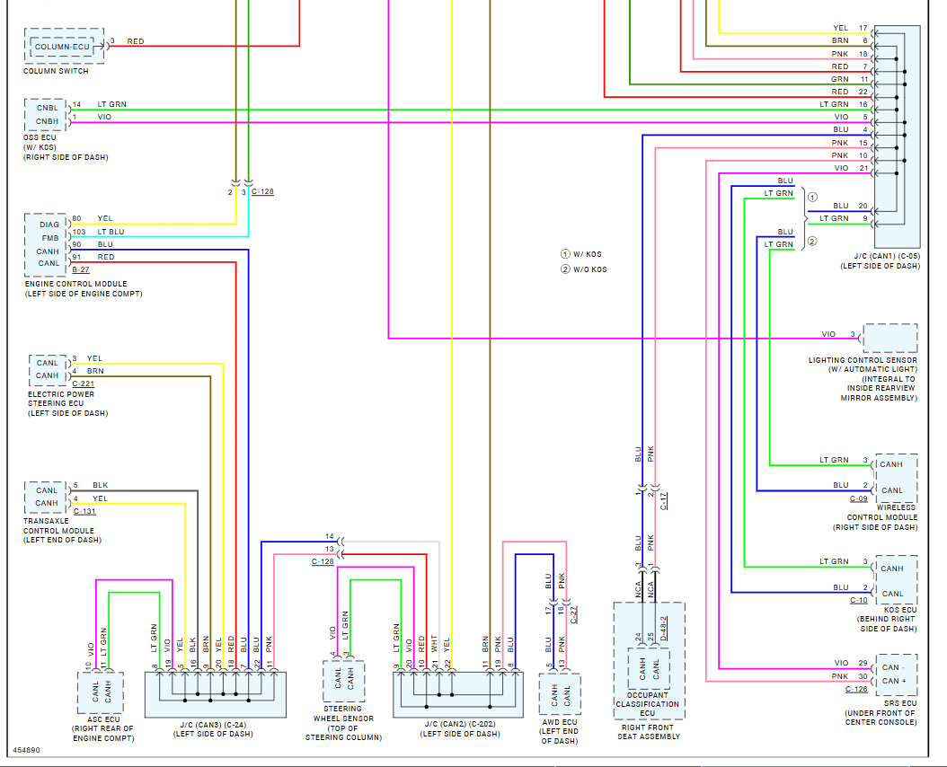

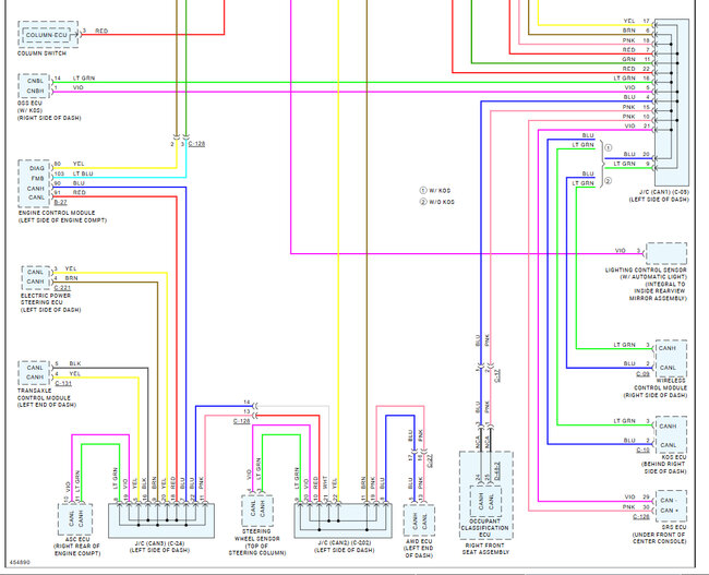

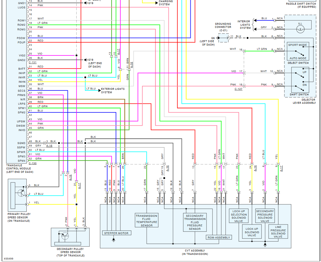

Hi Ken, please I would like to have a diagram for TCM pinout, TCM CAN bus wiring diagram, also pin out for ECU and CAN bus network for ECU.
Mar 6, 2025 at 4:49 AM
  • 55,710 POSTS
Hi Andrin,
You like these wiring problems :) Here is a guide to help with the testing and the wiring diagrams for the TCM and CAN BUS, please start a new post for the ECU wiring. I don't have connector views for this car, sorry. Check out the images (below). Let us know if you need anything else.

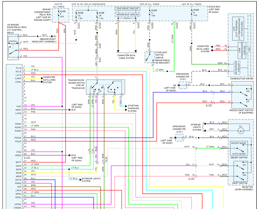

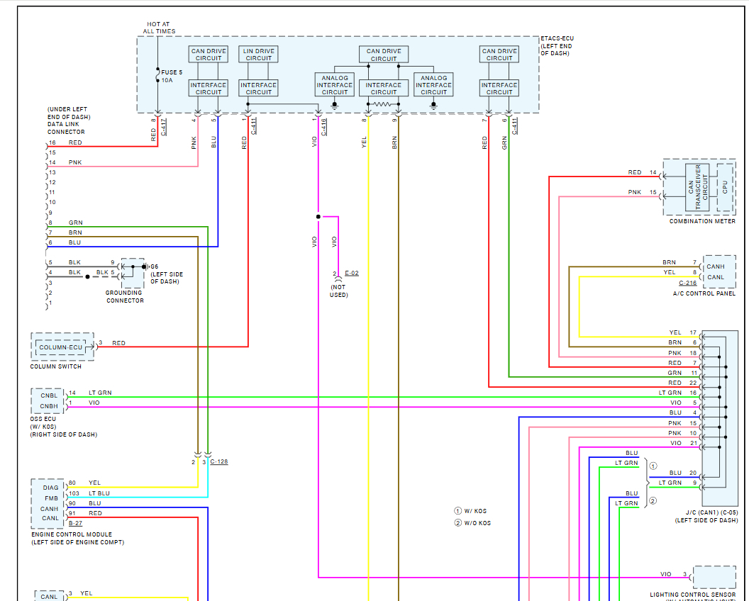

Hi Ken, I noticed the TCM is not appearing on the network. I could not find the can for the TCM, but I got a code P1590, referring to a damaged TCM or ECM. I just need to verify the can, if good then I replace the TCM. I also noticed this model has a gate way module. I did not find it in the diagram you shared with me, can you please?
Mar 18, 2025 at 4:23 AM
  • 55,710 POSTS

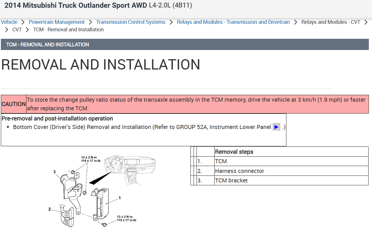

I don't think the car has a gateway module, where do you you see it? To me it sounds like you have a TCM that is out, I would make sure it is getting power and ground and if so, replace the TCM. Use the wiring diagrams above to test. Here is the location of the TCM.
Mar 19, 2025 at 2:53 AM
ANDRIN ATEM
  • 414 POSTS
Thank you, Ken, we found a blown fuse after noticing the TCM was not getting power.
