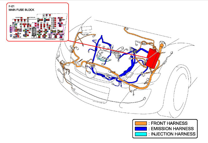

So you were just driving along, and this happened all at once? Were there any repairs or accidents? I would start by check the fuses and to make sure they have power to them, this guide can help:

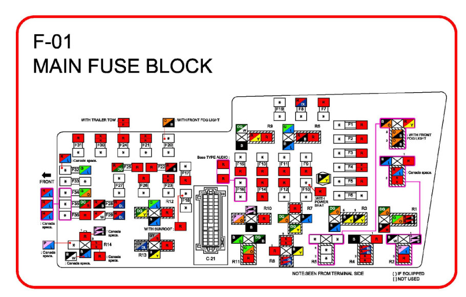

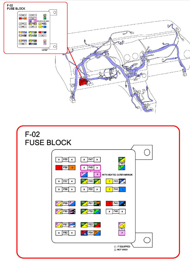

These codes are lost communication codes, so we lost power or ground. I would clear all the codes and then turn the system on without starting the engine or driving the car, then run the codes again. This will give us the most prevalent codes which we will go after first. Here are the fuses and locations. Check out the images (below). Please let us know what happens.
