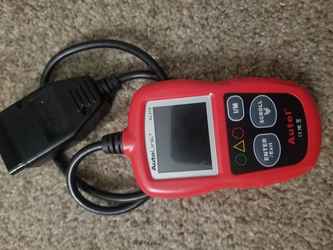

So here is my issue: I brought my vehicle to the dealership to have it repaired under warranty after it had some major engine issues. I have the car towed to the dealership and have them inspect it. I get a call shortly after stating that all the diagnostic information on the vehicle has been wiped and they having seen my cheap obd2 scanner in the door pocket of the vehicle claim I had used it to reset the ECU and remove all data of me " damaging the vehicle " so that I was not held liable. I never even had the scanner hooked to the vehicle much less changed anything at all as the car never had any check engine lights that came on. So my question is as follows: is there any possible way that a basic automotive obd2 scan tool can completely reset an ECU as they claim I have done with it? Not clearing a check engine light but completely wiping all data held on the computer. Thank you.

Hi, sorry to hear you're dealing with this. You would have to have a professional level tool like GM's tech 2, HP tuners , EFI live or something like that to completely erase the calibration software. Consumer grade scan tools will just read and clear codes, some offer bidirectional control of things but not calibration writing. My advice would be to plug it in and say, okay so where's that option? Or at least call their bluff so to speak.

Just for perfect clarification this is the scan tool that was accused of resetting the ECU. By their own words the car now says that it is on key cycle 1 (even after driving it around 5je service department ) everything is cleared from the driving history of the vehicle.

Thanks, it may have reset emissions monitors, that would be it. That's easily set into monitor ready by just driving it. Full features of the scanner at the link below.
