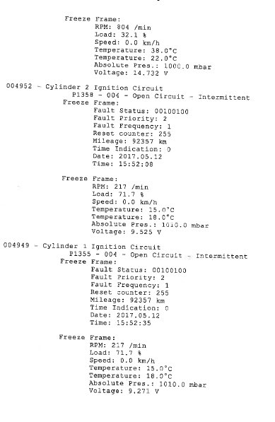

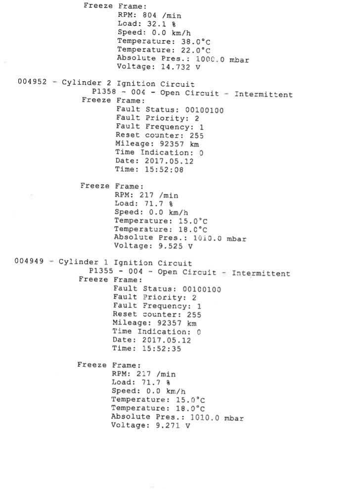

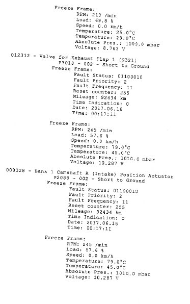

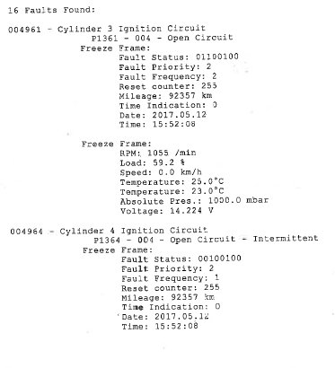

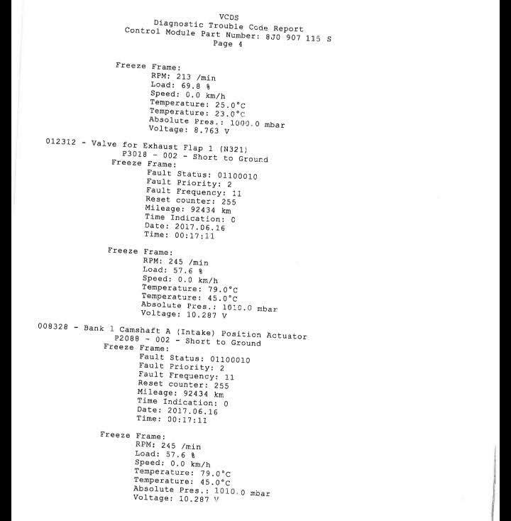

Can all of this be related to electrical faults
2009 AUDI TTS
57,787 MILES • 2.0L • 4 CYL • TURBO • 2WD • MANUAL
CRESCENDO
  • 6 POSTS

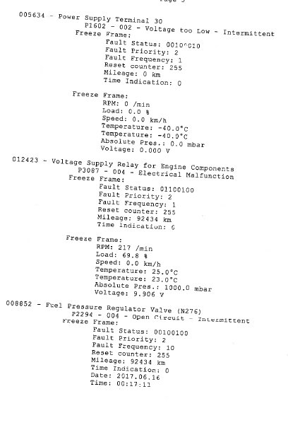

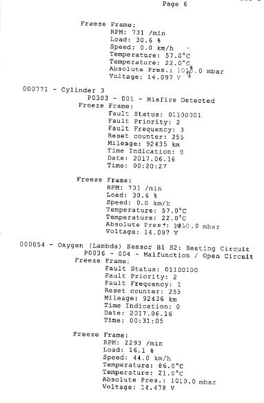

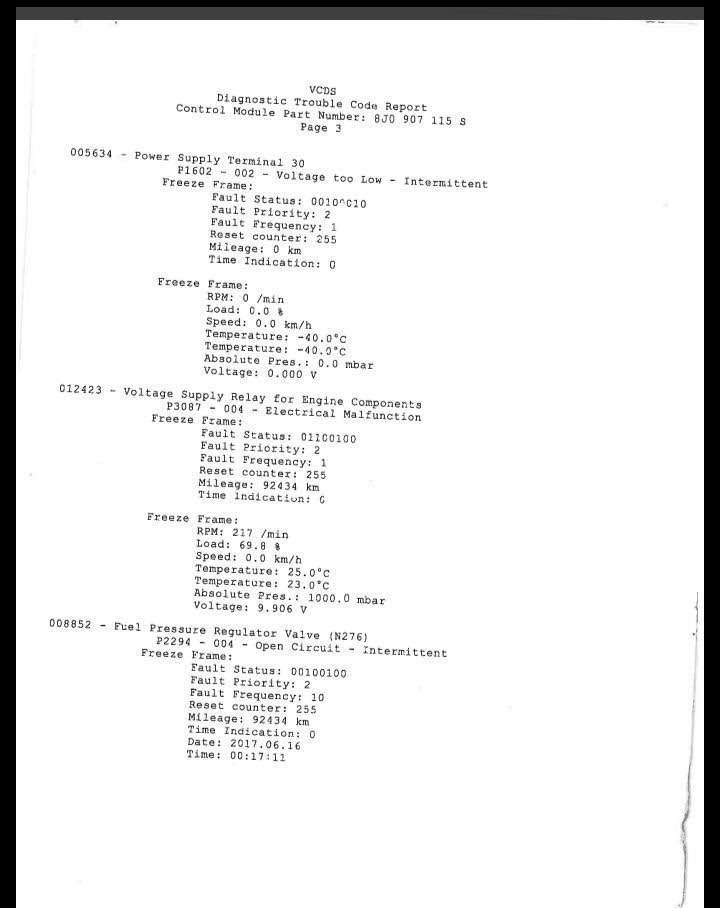

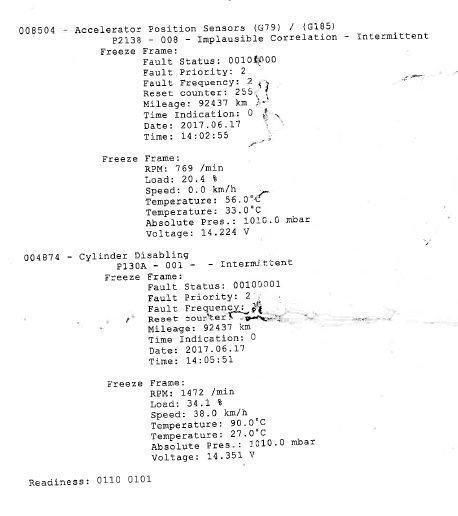

Diagnostic test codes show more short to ground errors, can most of these code be related to it?
Aug 8, 2018 at 4:56 AM
  • 110,194 POSTS
I looked through as many of the picture that would open. For some reason I cannot open four of them. The two that I saw both indicate an open circuit. Based on that, yes a bad ground can cause the issue because the circuit is not closed via the ground.

Good day Joe. Thanks for getting back to me. I am very new to the car things. I really do not know where to start. Every mechanic tells me a different thing that is why I joined you guys. I will try and resend you the faults.
Aug 8, 2018 at 9:59 PM
CRESCENDO
  • 6 POSTS
I have added it again.
Aug 8, 2018 at 10:11 PM

I would clear all codes and then just turn the key to the on position without starting the engine to see the hard codes. It looks like the PCM is having an issue. Has the car had any water damage?

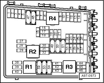

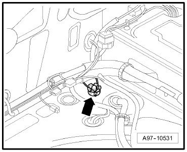

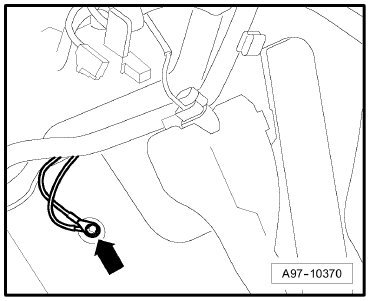

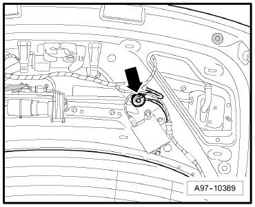

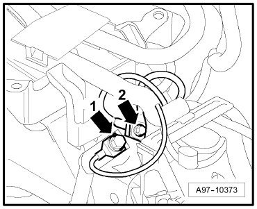

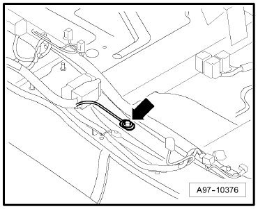

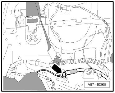

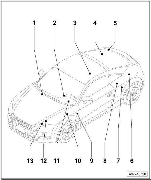

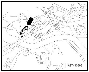

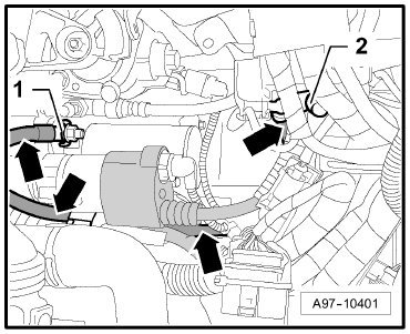

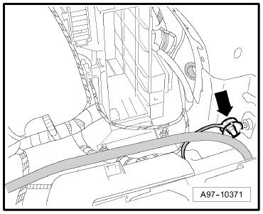

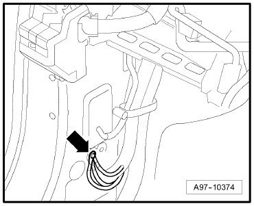

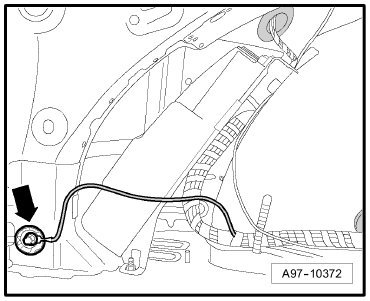

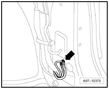

Here are ground locations.
Aug 13, 2018 at 8:19 PM
  • 110,194 POSTS

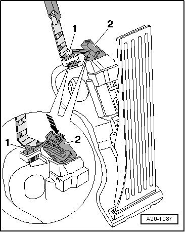

These pictures correlate with the directions that follow (next post).
Aug 13, 2018 at 8:24 PM
  • 110,194 POSTS

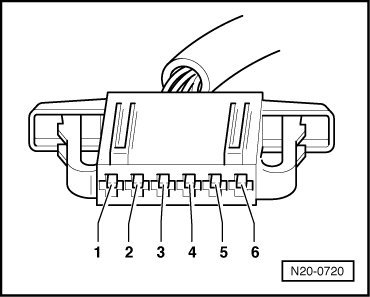

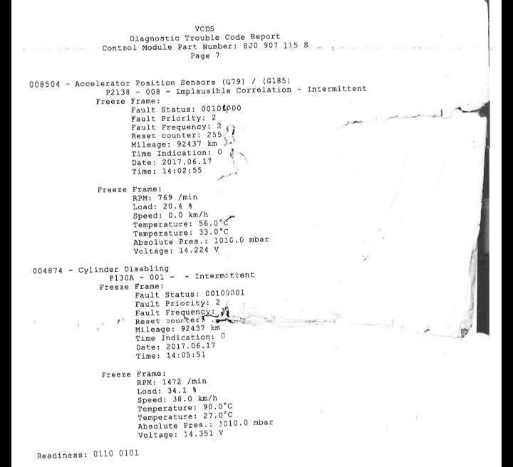

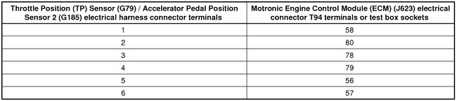

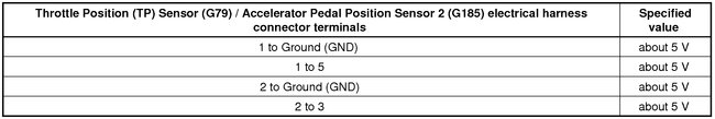

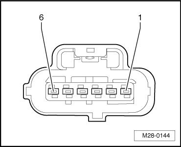

The first group of pictures I sent are general and indicate grounding locations. I attached them if you want to check. The next pictures I sent correlate with the following directions. One of the codes you have deals with the throttle pedal position sensor. I need you to try this test and let me know what you find. That way I can determine if there is a voltage problem or the switch itself is bad.
Aug 13, 2018 at 8:29 PM
  • 110,194 POSTS
Component Tests and General Diagnostics Throttle Position Sensor/Accelerator Pedal Position Sensor 2, Checking
Throttle position sensor/accelerator pedal position sensor 2, checking.
Throttle Position Sensor/Accelerator Pedal Position Sensor 2, Checking.
Observe all safety precautions: => [ Safety Precautions ] See: Computers and Control Systems > Technician Safety Information > Generic Scan Tool
View clean working conditions: => [ Clean Working Conditions ] See: Computers and Control Systems > Technician Safety Information > Generic Scan Tool
Use only gold-plated terminals when servicing any component with gold-plated electrical harness connector terminals.
For wiring diagrams, component locations, and connector views, refer to the applicable wiring diagram.
Aug 13, 2018 at 8:33 PM

Good day. I finally got your pictures. I will print them and try an follow these steps. I think the battery I had might be weak. I need to upgrade to a 652 battery cause the voltage is very low. The car keep switching off. Meaning I have to jump start it all the time. I did a test on the alternator the alternator seem to work. I am very new to cars so I will have to ask someone to assist me with the ground test as you explained.
