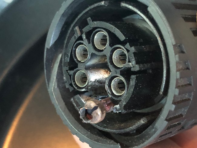

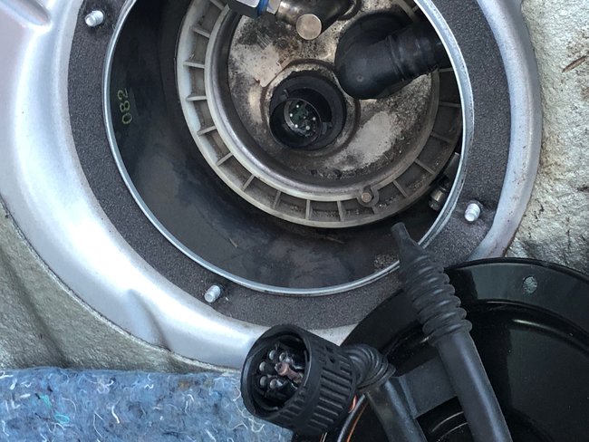

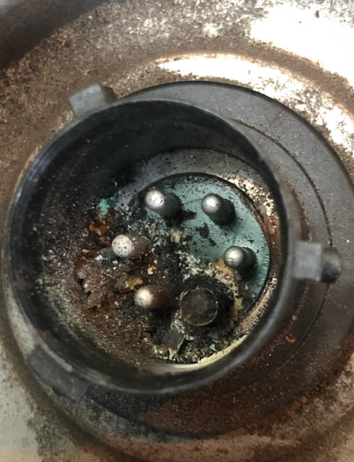

And now for the rest of the story. So I said I was puzzled how the fuel pump ground wire issue disappeared and that replacing the coils fix the issue. Well a few days after picking up the car from the dealer and driving it around, one morning the car didn't start again.
So I decided to take a look at the fuel pump, and to my surprise when I pulled the connector the ground lead was black and the female barrel connector was fused to the male terminal.
So the first shop was right about the ground, but I did not have a compression issue and need a new engine. For the few days the car ran, it had plenty of power, no hesitation and idled fine.
I found a used pump on ebay with a connector and I plan to repair the connector since the pump is good.
One last note, I did see that BMW did have a recall because of bad wiring and referenced the crimping was not done correctly, but only the X and 6 series was included, not for the 328i. I personally feel this defect falls into the same recall issue. I'm going to see if the dealer agrees and maybe I get a new pump and a higher quality wire harness.

Yes, that would cause like a brown out in your house. he goal of any electrical circuit is to dump all available voltage across the load, in this case the load is the fuel pump. This falls into one of Ohm's laws that are so cool on automobiles. Ohm's law states that if one of the three parts that make up electricity is constant, which in automotive applications there is always one constant(12.6 Volts-Battery Voltage) and one of the last two goes up(Resistance-The connector got melted causing unwanted resistance) then the last part(Amperage/Electrical Flow must go down proportionally). If there was any metal part of the positive wire that would have touched the negative terminal it would have caused a short to ground and the fuse would have blown. Anyway, good job. We are happy to hear you got it fixed, and good luck at the dealership.
