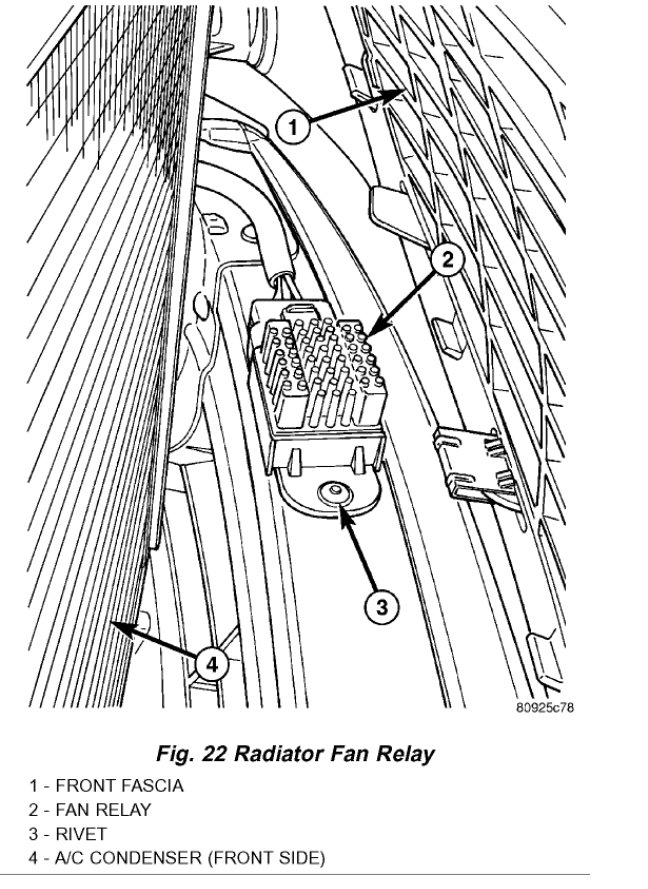

The radiator fan controller goes bad in these cars all the time. But I cannot see how that would make the coolant leak at the engine.
Here is a guide that can help us pinpoint the coolant leak:
https://www.2carpros.com/articles/car-is-leaking-coolant
Below is the fan controller location.
Please let us know what happens so it will help others.
