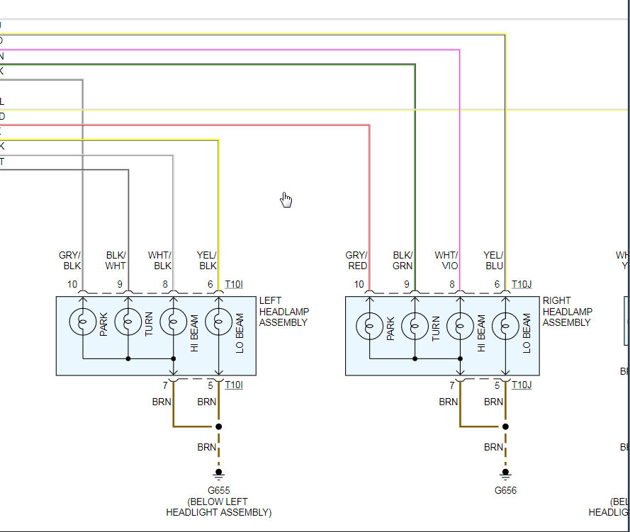

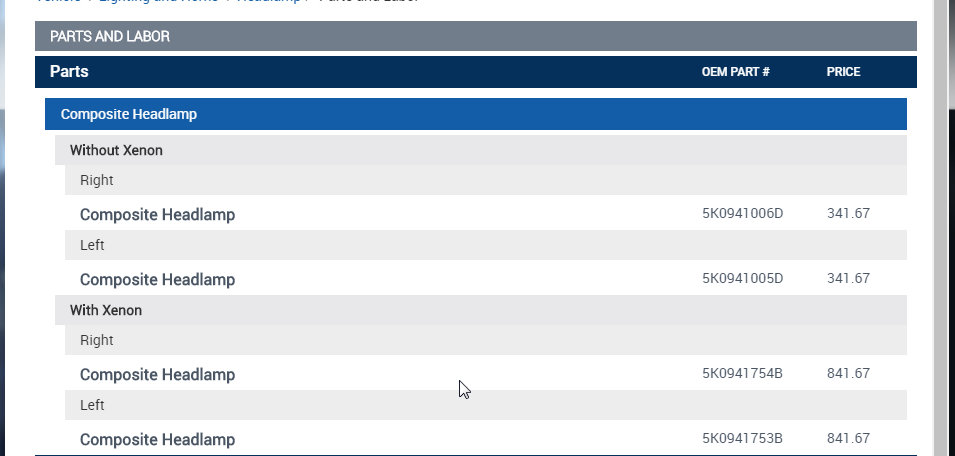

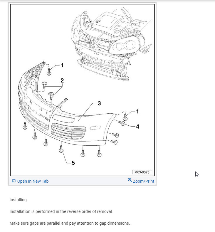

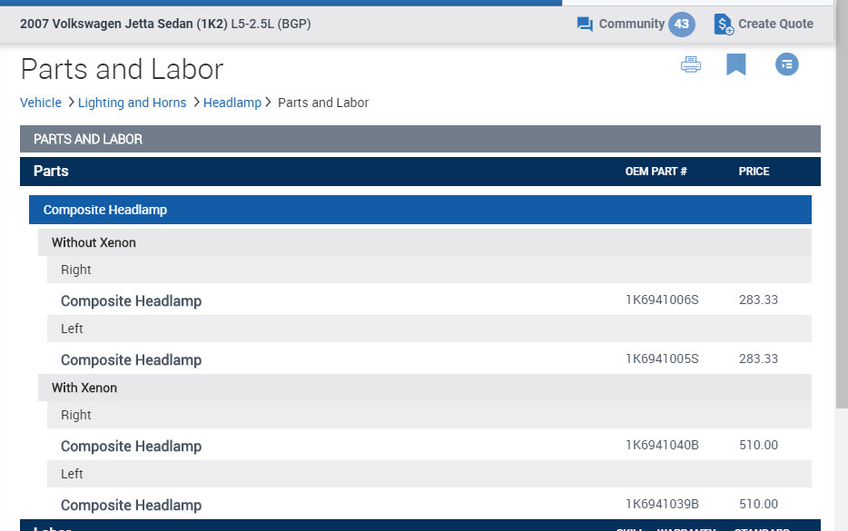

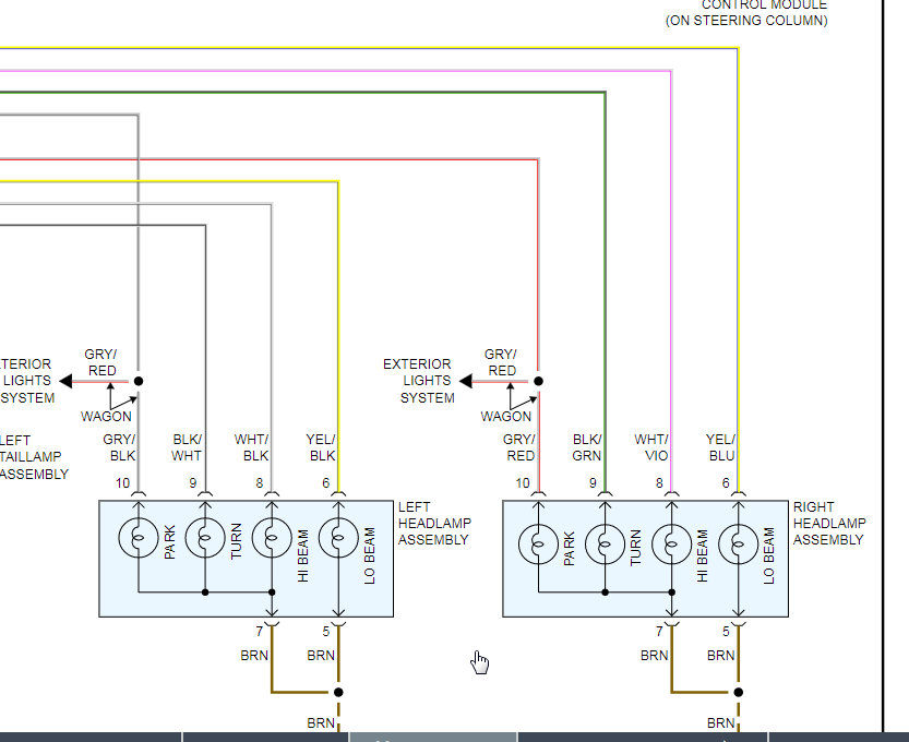

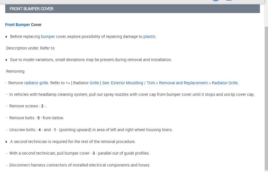

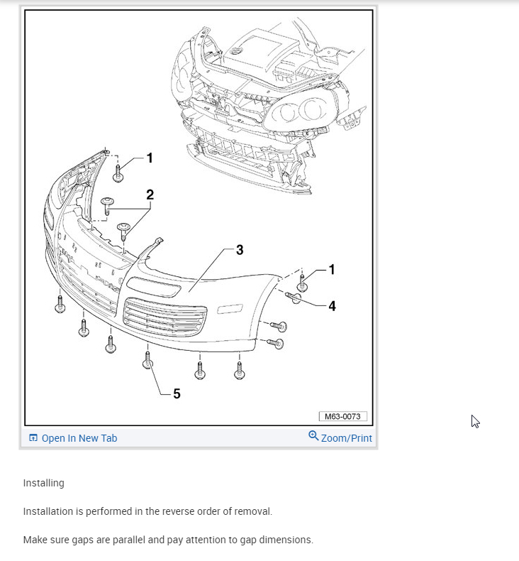

So I was wondering if I could replace the bumper and headlight L from my 2010 VW Jetta from a 2007 VW jetta?
Jan 17, 2020 at 8:46 AM
I cannot find anything that says they are in fact compatible however, everything I am seeing, it appears they will fit. The head lamp wiring is the same so they should plug in and operate which is always the hardest part.
Even if the brackets don't perfectly line up, you can get creative and secure them so that it will work. Again, just check operation and if they operate then you can make it work.
Let me know if you have questions but from what I am seeing it is something that I would move forward with.
