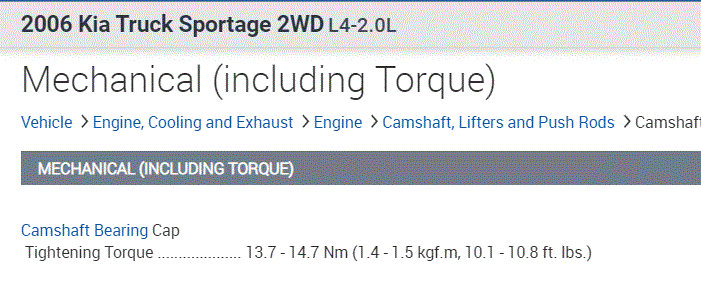

I'm just trying to find out the order to tighten down the camshaft bolts. as well as the Torque specs for each bolt.
Thanks for your help.
Jun 11, 2022 at 1:37 AM
  • 110,244 POSTS

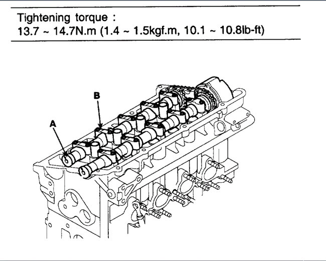

Surprisingly, the manual doesn't provide a sequence. It does give the torque spec. I attached it below.
If I was doing this, I would suggest starting at center and work outward. Tighten to 1/2 the final torque and then go back and tighten to the specifications.
Make sure the cam bearings/caps are fully lubricated before you install the caps.

Thanks Joe, I went from middle out...
