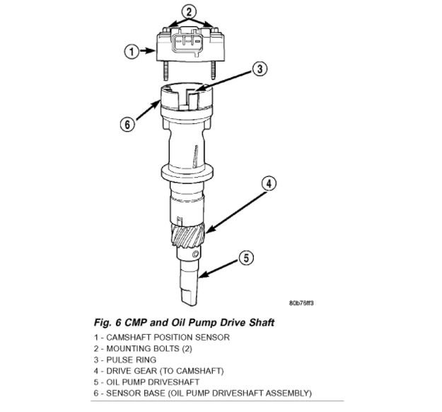

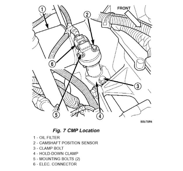

The Camshaft Position Sensor (CMP) on this 6-cylinder engine is bolted to the top of the oil pump drive shaft assembly. The sensor and drive shaft assembly is located on the right side of the engine near the oil filter.
The rotational position of oil pump drive determines fuel synchronization only It does not determine ignition timing.
NOTE: Do not attempt to rotate the oil pump drive to modify ignition timing.
Two different procedures are used for removal and installation. The first procedure will detail removal and installation of the sensor only. The second procedure will detail removal and installation of the sensor and oil pump drive shaft assembly. The second procedure is to be used if the engine has been disassembled.
An internal oil seal is used in the drive shaft housing that prevents engine oil at the bottom of the sensor. The seal is not serviceable.
Sensor Only
1. Disconnect electrical connector at CMP sensor.
2. Remove 2 sensor mounting bolts or.
3. Remove sensor from oil pump drive.
Oil Pump Drive And Sensor

4. Before proceeding to next step, mark and note rotational position of oil pump drive in relationship to engine block. After installation, the CMP sensor should face rear of engine 0 .
5. Remove hold-down bolt and clamp.

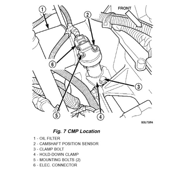

1. Install sensor to oil pump drive.
2. Install 2 sensor mounting bolts and tighten to 2 Nm (15 in. lbs.) torque.
3. Connect electrical connector to CMP sensor.

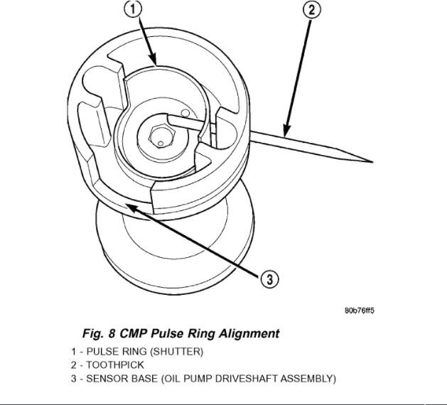

3. Temporarily install a toothpick or similar tool through access hole at side of oil pump drive housing. Align toothpick into mating hole on pulse ring.
4. Install oil pump drive into engine while aligning into slot on oil pump. Rotate oil pump drive back to its original position and install hold-down clamp and bolt. Finger tighten bolt. Do not do a final tightening of bolt at this time.

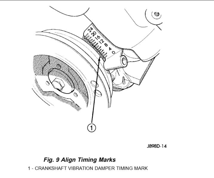

b. Remove cylinder number 1 spark plug.
c. Hold a finger over the open spark plug hole. Rotate engine at vibration dampener bolt until compression (pressure) is felt.
Fig.9 Align Timing Marks - 4.0L Engine
d. Slowly continue to rotate engine. Do this until timing index mark on vibration damper pulley aligns with Top Dead Center (TDC) mark (0 degree) on timing degree scale. Always rotate engine in direction of normal rotation. Do not rotate engine backward to align timing marks.
e. Install oil pump drive into engine while aligning into slot on oil pump. If pump drive will not drop down flush to engine block, the oil pump slot is not aligned. Remove oil pump drive and align slot in oil pump to shaft at bottom of drive. Install into engine. Rotate oil pump drive back to its original position and install hold-down clamp and bolt. Finger tighten bolt. Do not do a final tightening of bolt at this time.
f. Remove toothpick from housing.
