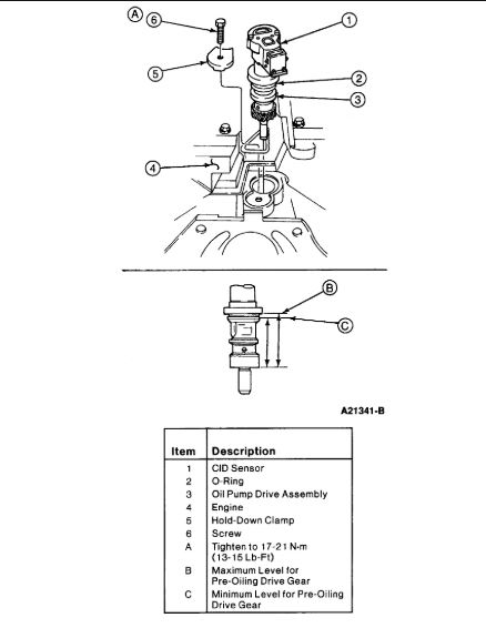

Good evening,
I attached the procedure for removal and installation below. I attached pictures as well for you.
REMOVAL
1. Disconnect the battery ground cable.
NOTE: When the battery has been disconnected and reconnected, some abnormal drive symptoms may occur while the Power-train Control Module (PCM) relearns its adaptive strategy. The vehicle may need to be driven 16 km (10 miles) or more to relearn the strategy.
2. Disconnect the engine wiring harness connector at the Camshaft Position (CMP), or Cylinder Identification (CID) sensor.
3. Remove the CMP sensor retaining screws and CMP from synchronizer assembly.
NOTE: Prior to the removal of the CMP sensor, set No. 1 cylinder to 0 degrees Top Dead Center (TDC) of the compression stroke. Note the position of the CMP sensor electrical connector. The installation procedure requires that the connector be located in the same position.
4. Remove hold-down clamp.
5. Remove the synchronizer assembly from cylinder block.
INSTALLATION
1. Rotate crankshaft until TDC mark on the damper is accessible. If not present, place an additional mark on the damper at 26 degrees After Top Dead Center (ATDC). This position is 34 mm (1.34 in) counterclockwise from the TDC mark.
2. Position No. 1 cylinder to TDC between compression and ignition stroke. (Both intake and exhaust valves must be closed with TDC mark on vibration damper at pointer).
3. Lubricate oil pump drive pinion and O-ring on assembled oil pump drive gear and CMP sensor with SM-2C 1013-A oil. Do not get oil above mounting flange.

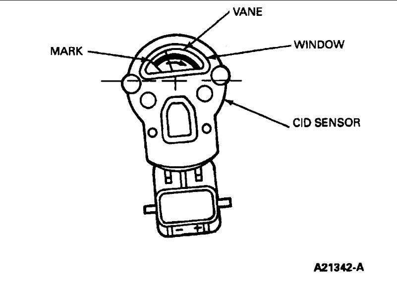

4. Align the CMP sensor rotor as shown with the trailing edge of the vane lined up with the short mark at the left-hand side of the plastic window.
NOTE: Normal CMP sensor rotation is clockwise viewed from top of CID sensor.
5. Position the sensor above its hole at right angles to the block rear face.

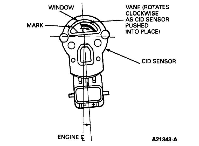

6. Install the assembled CMP sensor and oil pump drive gear into the engine. As the assembly is pushed into place, the camshaft gear will rotate the sensor vane clockwise toward the center window.

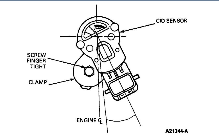

7. Rotate the CMP sensor counterclockwise. Install clamp and screw finger-tight. Rotate the sensor back to its position at right angles to the back of the block.

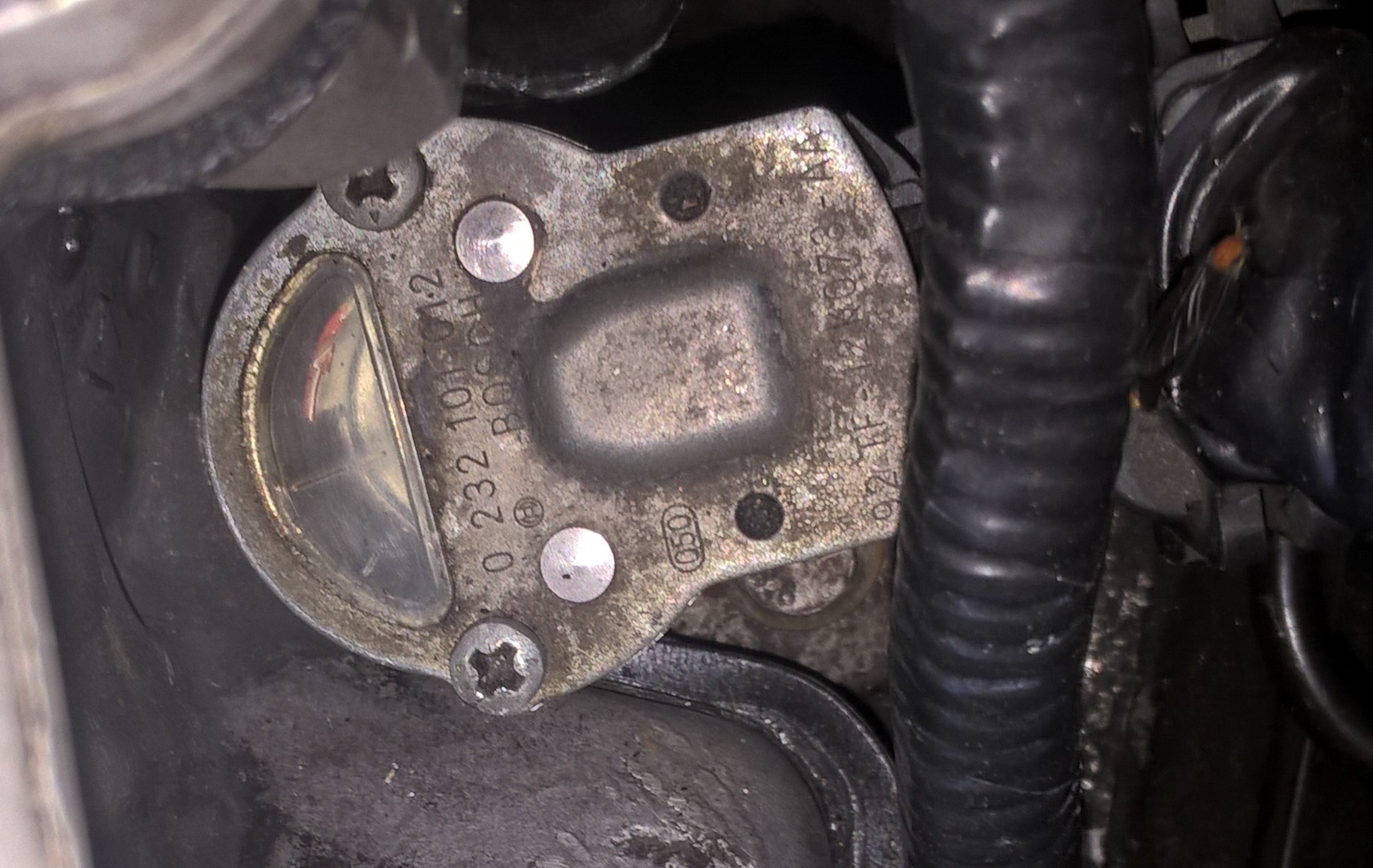

any one have a picture of the sensor window at ATDC since there is not a prefab tool for keeping the sensor at the mark when stabbing it I wonder if im at the wrong tooth in the cam kinda tedious while in vehicle.... my window looks like this at ATDC and my syncro is angled 1030 oclock backprobed correctly as above …
Oct 10, 2019 at 5:03 AM
That is correct.
