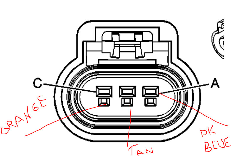

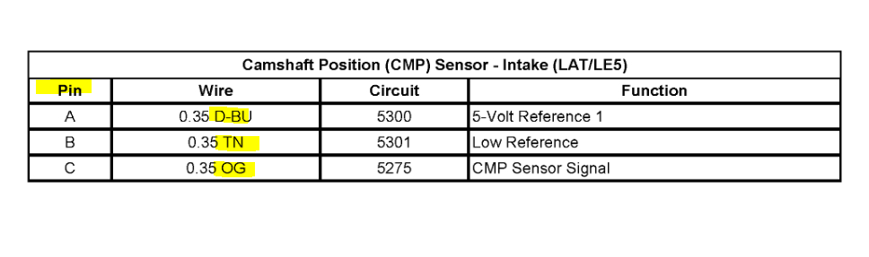

I need to know the wire diagram for the camshaft position sensor. I have orange, tan, and blue wires. I don't know which color goes to which pin.
Jan 26, 2024 at 9:56 AM
  • 110,251 POSTS
Based on the colors you mentioned, it sounds like the intake camshaft position sensor.
If you look below, I attached a pic of the connector and identified the wire color to each pin. Just orient the connector in the same position to locate pins A, B, and C.
Let me know if this helps.
