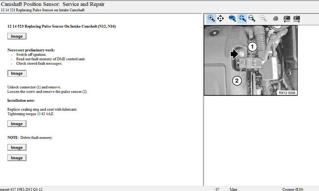

If I replace the sensors myself, is it possible to not have to relearn the system? Can the cars computer do it on its own?
Feb 4, 2021 at 8:01 AM
SEVAG P
  • 405 POSTS
hello,

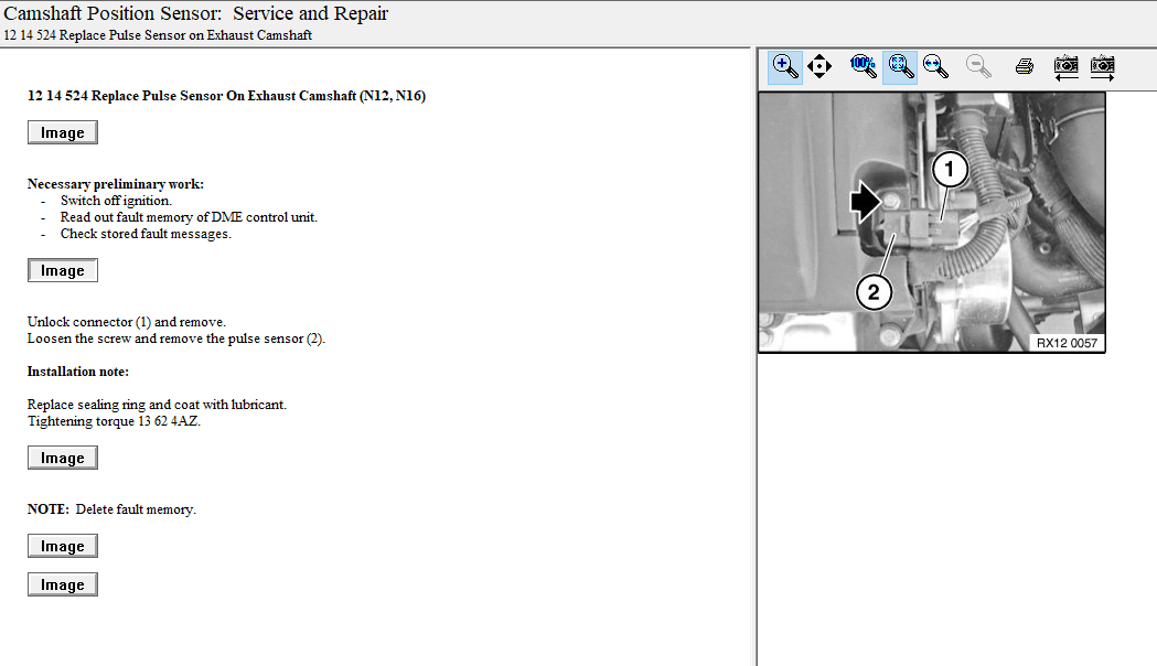

Camshaft sensor replacement does not need any relearn procedure, just remove and reinstall.
check the figure 1 and 2 below procedure how to replace inlet and exhaust camshaft sensor.

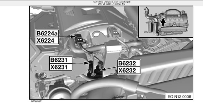

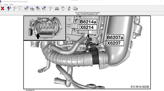

check figure 3 and 5 location of the sensors.
