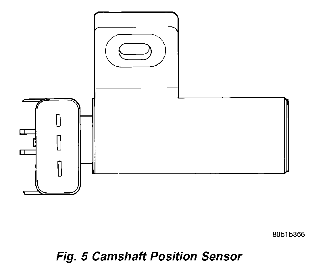

Here are the specific directions for replacement on your vehicle. Pictures 1 and 2 correlate with these directions.
______________________________________
REMOVAL
The camshaft position sensor is installed in the timing belt housing cover above the left camshaft sprocket.
1. Disconnect the negative battery cable.
2. Loosen the upper intake plenum, refer to the Intake System section.
3. Disconnect electrical connector from sensor.
4. Remove camshaft position sensor screw.
5. Pull sensor up out of the timing belt housing cover.

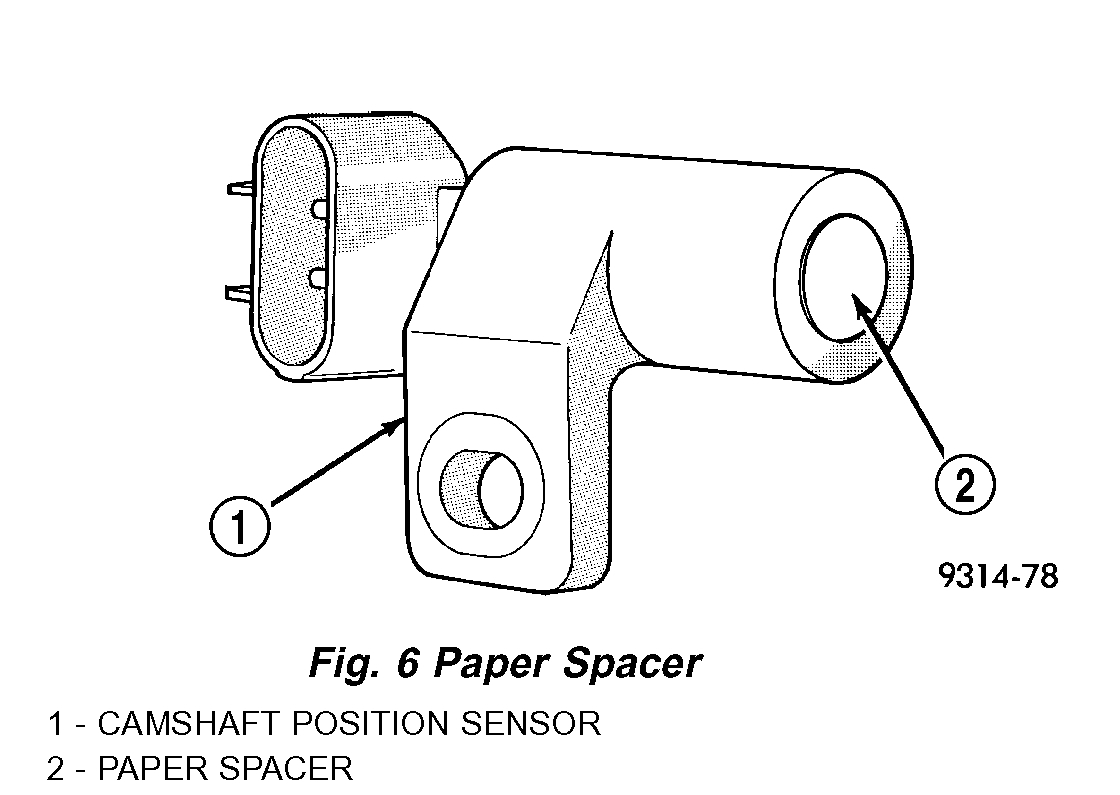

Fig. 6 Paper Spacer - 3.5L
pic 2

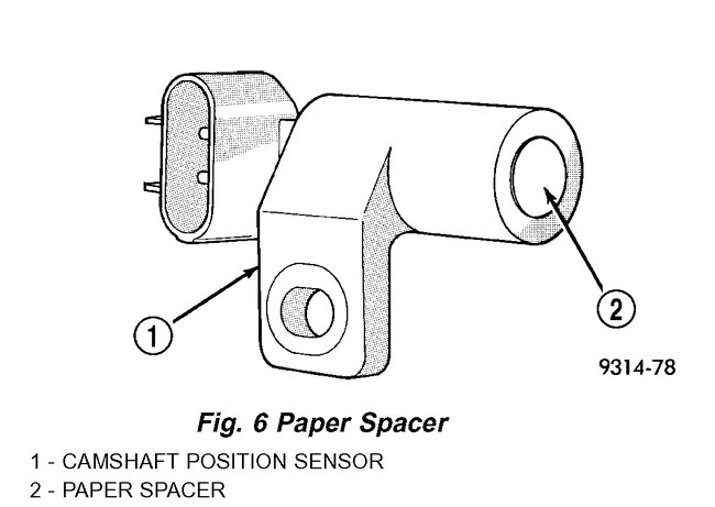

If the removed sensor is reinstalled, completely remove the old spacer from the sensor face. Attach a NEW SPACER to the face of the sensor before installation. If installing a new sensor, confirm that the paper spacer is attached to the face.
1. Install sensor in the timing belt housing and push sensor down until contact is made with the camshaft sprocket. While holding the sensor in this position, install and tighten the retaining bolt to 12 Nm (105 in. lbs.) torque.

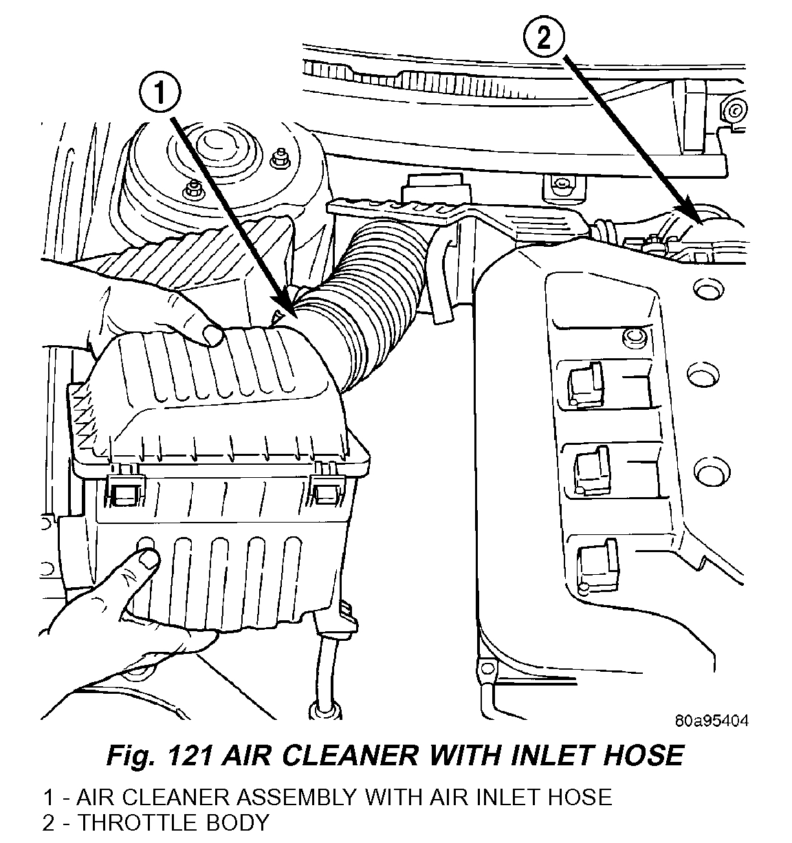

pic 3

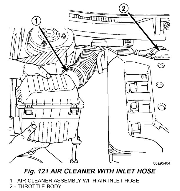

2. Disconnect the Inlet Air Temperature (IAT) Sensor connector. Remove air cleaner housing and inlet hose (Fig. 121).

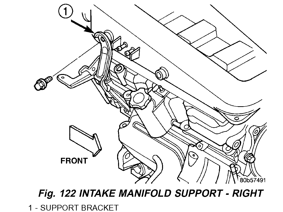

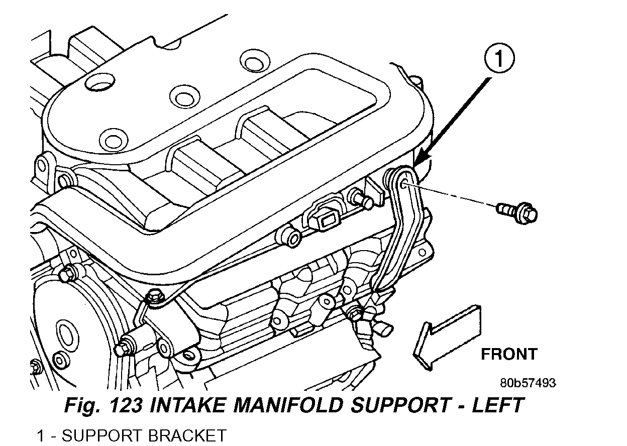

6. Remove right side (Fig. 122) and left side (Fig. 123) intake manifold supports.

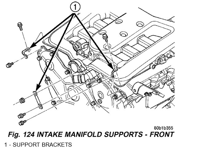

7. Remove support brackets at intake manifold front corners and at MTV (Fig. 124).

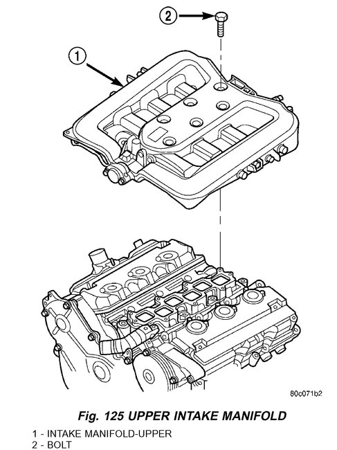

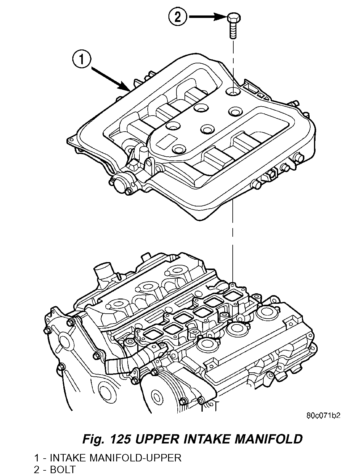

9. Remove bolts attaching intake manifold and remove manifold (Fig. 125).

3. Install intake manifold (Fig. 125) and hand start all attaching bolts.

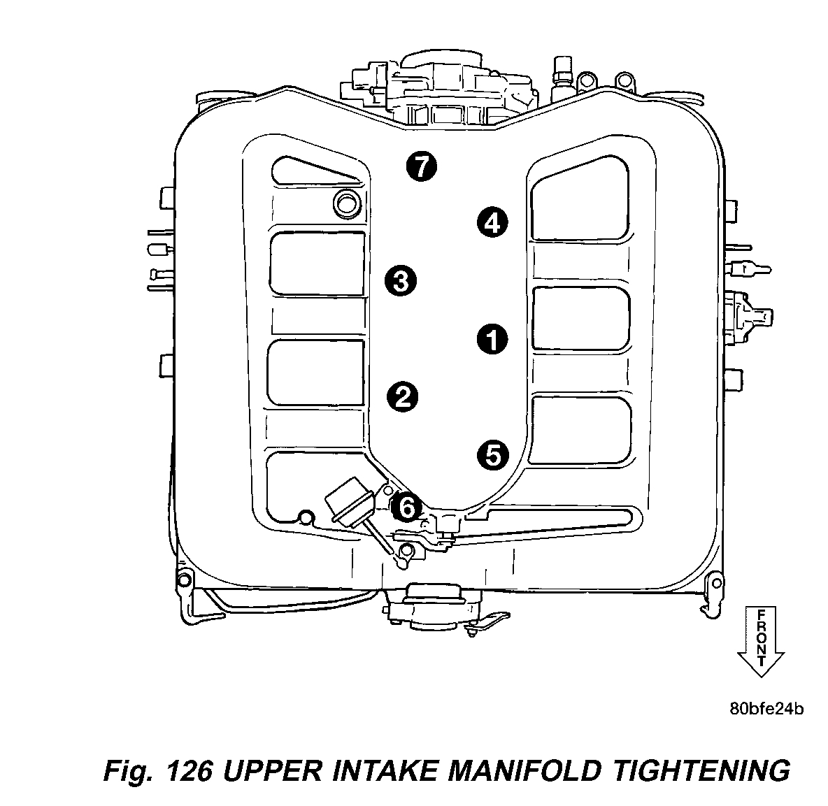

Upper
pic 8
4. Tighten bolts gradually in sequence shown in (Fig. 126)until a torque of 12 Nm (105 in. lbs.) is obtained.
5. Install right side (Fig. 122) and left side (Fig. 123) intake manifold supports.
6. Install manifold support brackets at front corners and at MTV (Fig. 124).

11. Install air cleaner housing and inlet hose (Fig. 121). Connect Inlet Air Temperature (IAT) Sensor connector.
