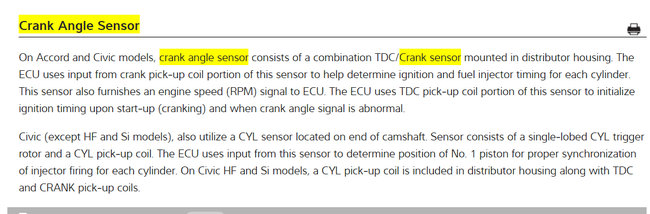

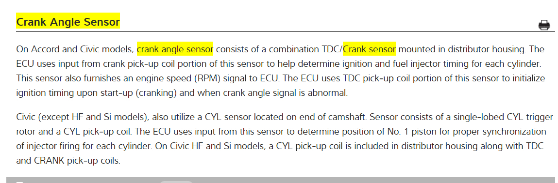

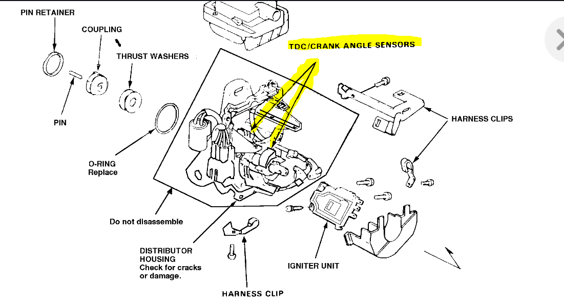

Two prong plug on the camshaft sensor no power to it. want to know if there's a way to fix that? do I need to rewire it? what to do I need my car is stressing me out? I don't have money for a shop. thank you if you can help me.
Jul 22, 2019 at 2:32 PM
SCGRANTURISMO
  • 4,897 POSTS

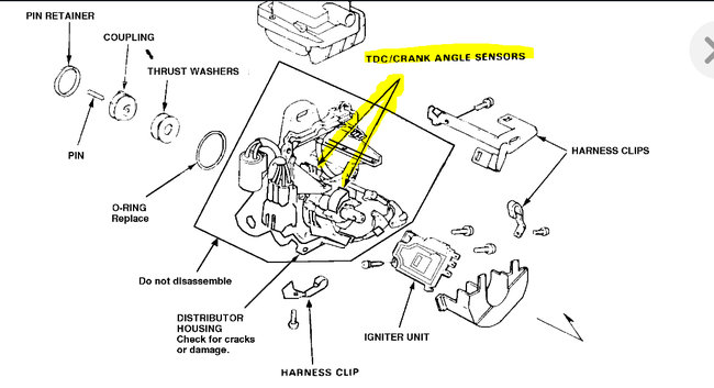

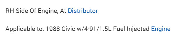

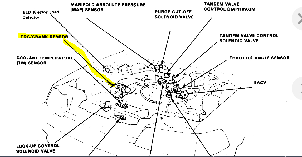

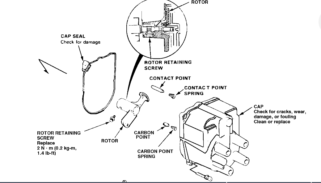

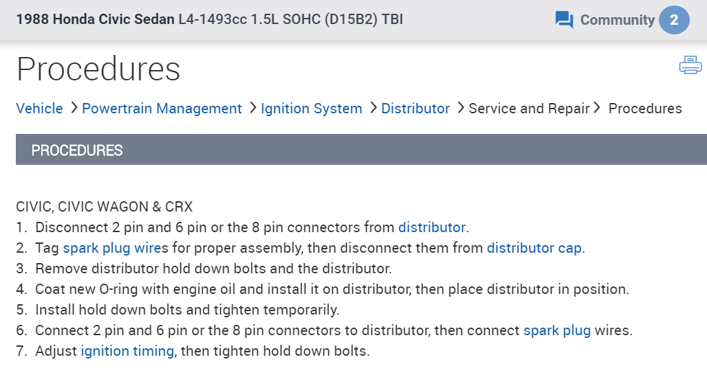

There shouldn't be any power going to the TDC/Crank/CYL sensor, which is located the distributor housing. In the diagrams down below I have included a description of the TDC/Crank/CYL sensor, as well as it's location, and an exploded view of the distributor and the directions for the removal and installation of the distributor for your vehicle. Please go through these guides and get back to us with what you are able to find out.
