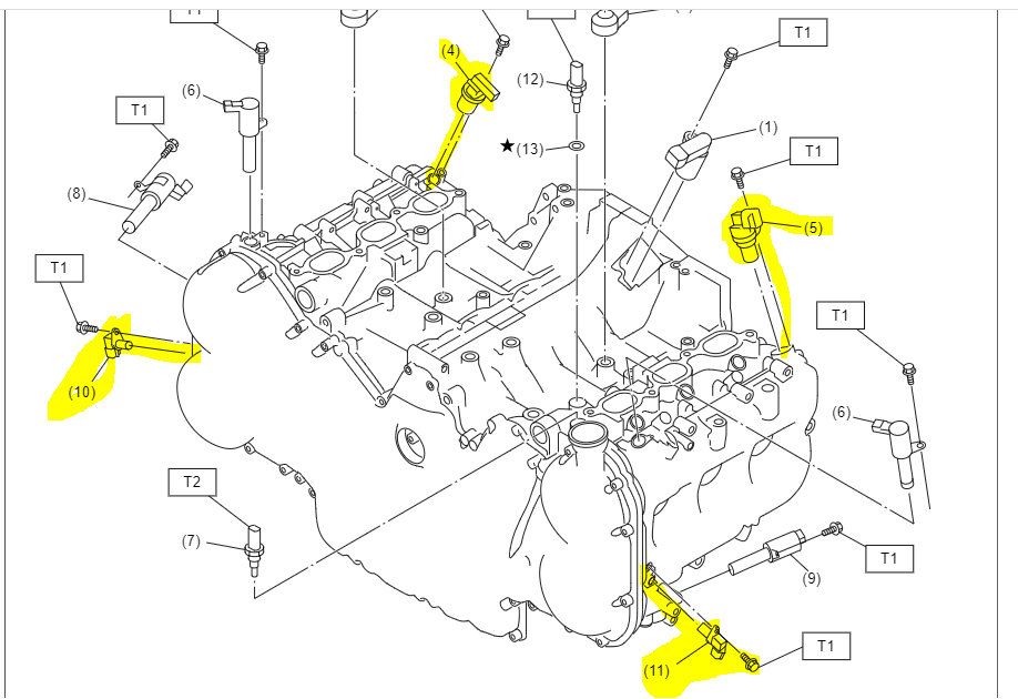

Needing to replace both bank 1 and, bank 2 camshaft sensors. So far, after hours of searching Google and, the Tube, I have yet to find any clear answers or schematics for a 6 gen Legacy.
Apr 16, 2023 at 4:25 PM
  • 110,194 POSTS

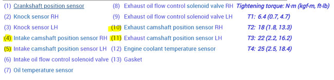

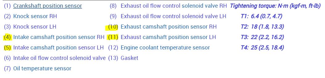

If you look below, pic 1 shows an exploded view of the engine/sensors. Pic 2 is the legend for the picture.
There are a total of 4 cam sensors on this vehicle. Two are for each exhaust camshaft and the other two are for each intake camshaft.
Let me know if this helps. If you do need wiring schematics, let me know.

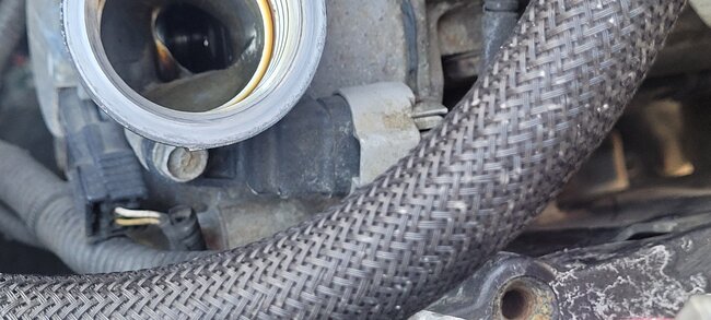

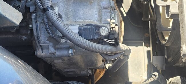

Driver pic 1 Pass pic 2... Are these the bank 1 and, bank 2 sensors?
Apr 17, 2023 at 9:05 AM
  • 110,194 POSTS
Those appear to be the sensors. Have you had a chance to replace them?

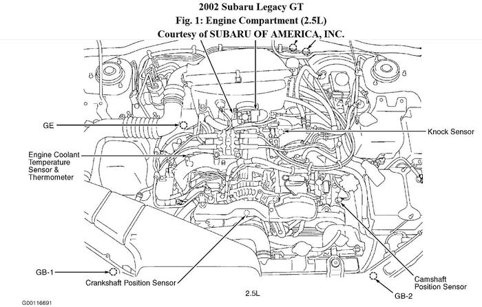

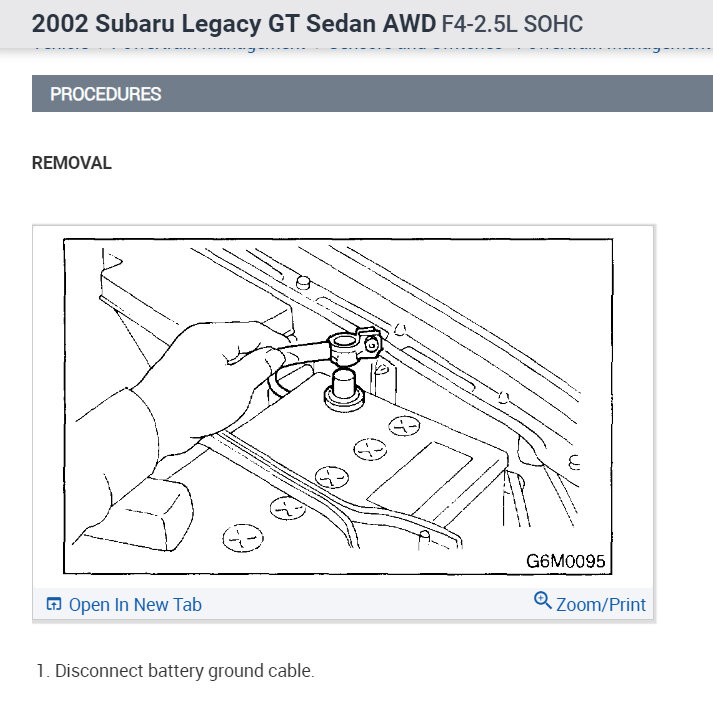

where is the camshaft positioning sensor located?
Jun 21, 2023 at 1:01 PM (Merged)
KHLOW2008
  • 41,814 POSTS

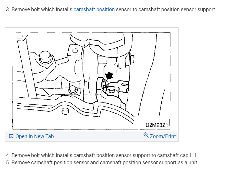

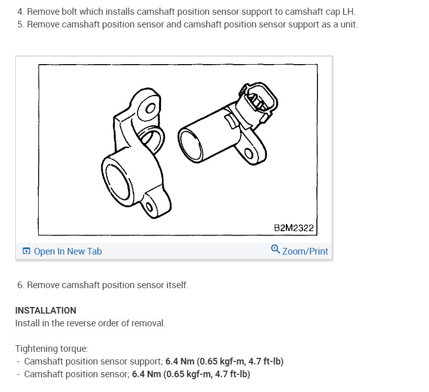

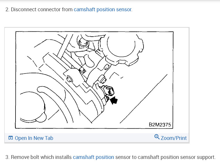

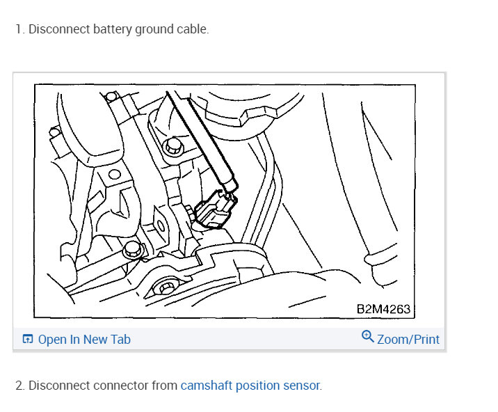

The camshaft position sensor is located on the left side if the engine near the front. Here is a guide and diagram to help you see how to do the job check out the diagrams below.
https://www.2carpros.com/articles/camshaft-angle-sensor-replacement
