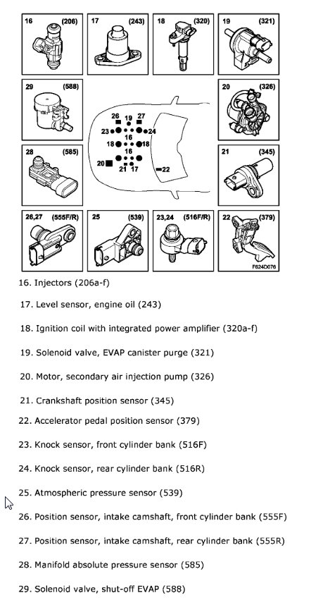

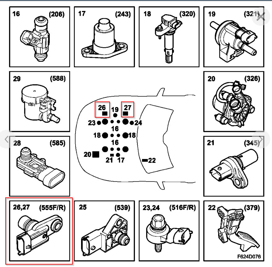

engine light on, code P0340 came up. I have the vehicle listed above 2.0T. I cannot find the location of the camshaft position sensor, can you please let me know where it is located?
Mar 3, 2020 at 8:45 AM

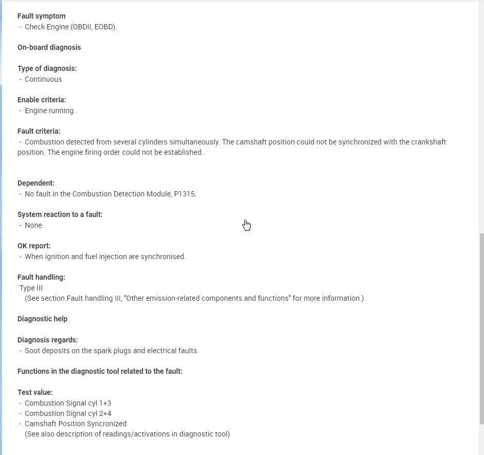

Take a look at the attachments. I provided the info for this code but you are correct that it is normally the sensor. Also provided the location of these. It is not extremely detailed but they are on the front of each cam tone wheel.
Mar 3, 2020 at 9:04 AM
DCAMACHOCZ

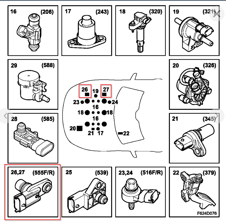

thank you for the information, by your detail my car has 2 camshaft position sensors correct?
Mar 3, 2020 at 1:08 PM
That is correct. One on each bank. You are welcome.
