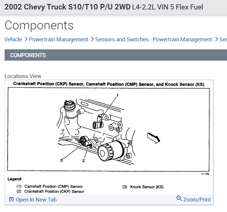

Where are the Camshaft and crankshaft sensors located?
2002 CHEVROLET S-10
150,000 MILES • 2.2L • 4 CYL • 2WD • AUTOMATIC
BEST8419
I'm trying to find out where these sensors are located to change them all due to engine code. thank you

Sure, here are the locations of the camshaft and crankshaft sensors. Check out the images (below). Please let us know if you need anything else to get the problem fixed.
