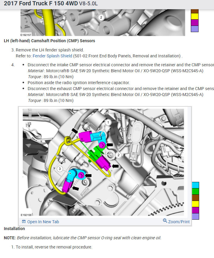

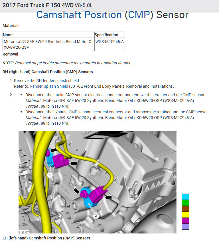

Check engine light is on. Code p03040 camshaft sensor a bank 1. How do I locate and replace?

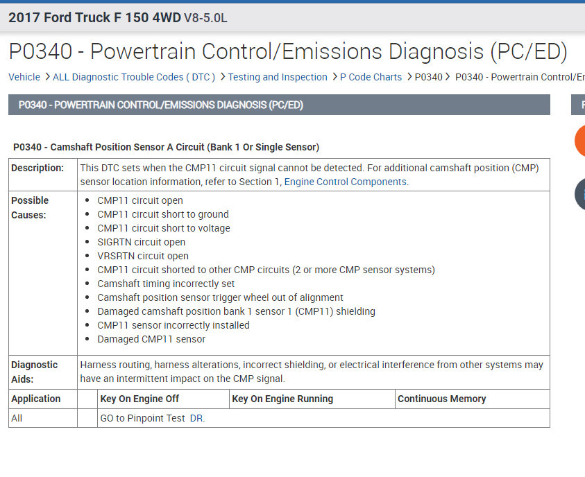

The code:
P0340 - Camshaft Position Sensor A Circuit (Bank 1 Or Single Sensor)
This code gets triggered when ECM is unable to detect the cam position sensor.
It can be due to a faulty sensor, the circuit short to the ground, open circuit, not getting enough voltage, damaged sensor.
I have attached the basic diagnostics for that code.

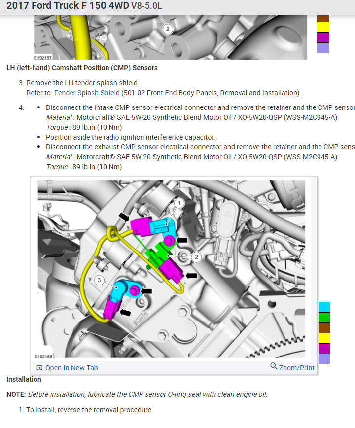

https://www.2carpros.com/articles/camshaft-angle-sensor-replacement
See diagrams below for the location of the sensor.
