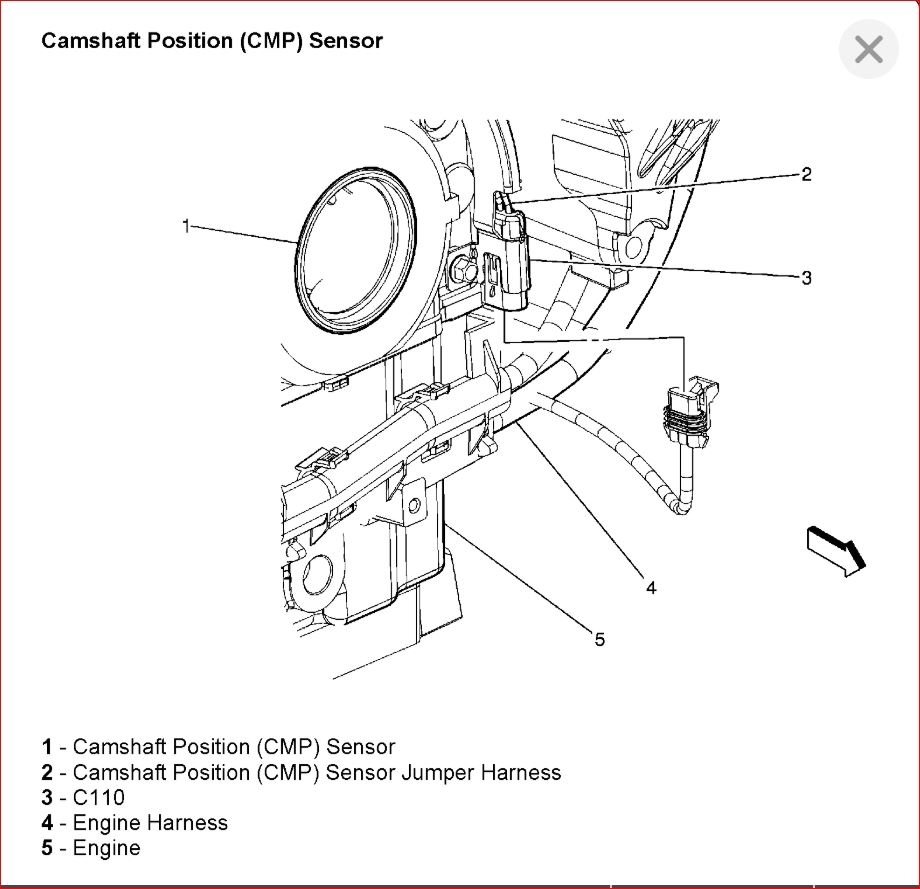

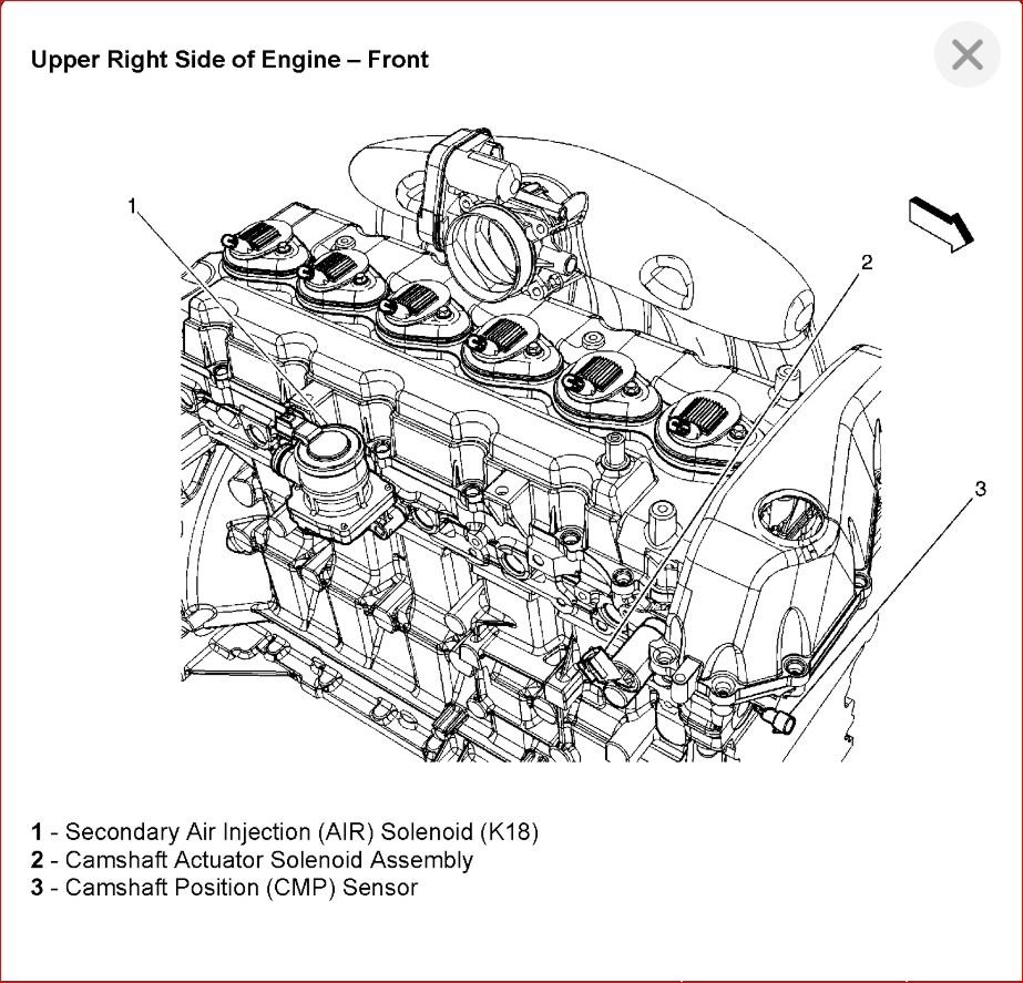

Where is the cam sensor located at on the vehicle listed above?
May 16, 2019 at 6:31 PM
Hi Donna,
Attached are the locations of the cam sensor for each engine option because I am not sure which one you have. First is the 4.2L and second is the 5.3L.
Please let me know if you need anything else. Thanks
