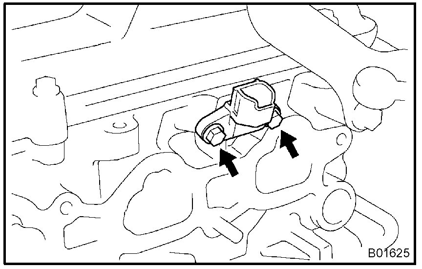

Here is the process for replacing the camshaft position sensor on your vehicle. It is a bit involved. I am adding this so you can see what was done and maybe check to make sure connectors are correctly reattached, vacuum hoses are back on, and basically, a good look over to make sure something that was removed was replaced. The picture I attached correlates with these directions. It shows the actual sensor and location.

PROCEDURES
REMOVAL
1. DRAIN ENGINE COOLANT
2. REMOVE OIL DIPSTICK AND GUIDE FOR ENGINE
3. REMOVE OIL DIPSTICK AND GUIDE FOR A/T
4. REMOVE AIR INTAKE CHAMBER
5. REMOVE VACUUM CONTROL VALVE SET AND NO.2 VACUUM PIPE
6. REMOVE NO.3 TIMING BELT COVER
7. DISCONNECT HOSES AND ENGINE WIRE
a. Disconnect the air assist hose from the intake manifold.
b. Disconnect the water bypass hose (from the water outlet) from the throttle body.
c. Disconnect the 2 ground terminals from the intake manifold.
HINT: At time of the installation, place refer to the following item. Tighten so that each calking part should inside.
d. Disconnect the throttle position sensor connector.
e. Disconnect the 6 injector connectors.
f. Disconnect the camshaft position sensor connector.
g. Disconnect the knock sensor 2 connector.
h. Disconnect the starter connector.
i. Disconnect the engine wire clamp from the clamp bracket on the intake manifold.
j. Remove the 3 nuts, and disconnect the engine wire protector from the intake manifold.
8. REMOVE FUEL PRESSURE PULSATION DAMPER
9. REMOVE PS PUMP REAR STAY
Torque: 39.2 N.m (400 kgf.cm, 29 ft.lbf)
10. REMOVE INTAKE MANIFOLD ASSEMBLY
11. REMOVE CAMSHAFT POSITION SENSOR
Remove the 2 bolts and camshaft position sensor.
Torque: 9.0 N.m (90 kgf.cm, 80 in..lbf)
INSTALLATION
Installation is in the reverse order of removal.

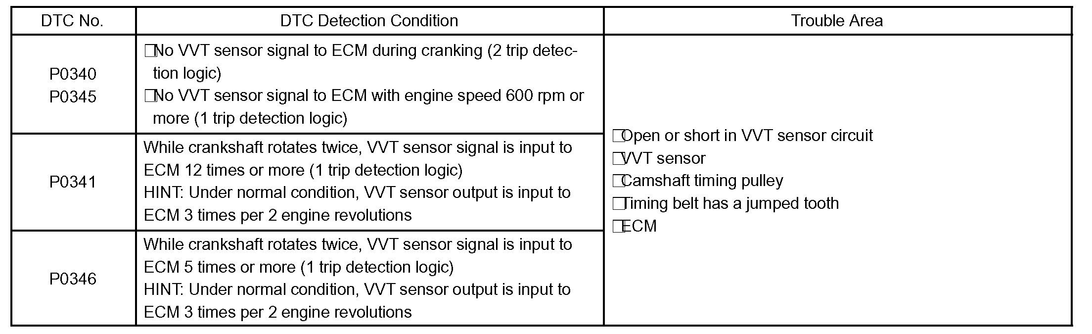

The codes are p0346, p0420, p0430 and p0300.

The P0346 indicates an issue with the camshaft position sensor, (sensor A bank 2). If that is what was replaced, take the car back.
Code 300 is a random misfire which is most likely the result of the cam sensor.
The last two codes are the same, just for different sides. Both indicate the catalytic converters are not doing what they should. Usually, that is the result of a bad converter.
I would start with the cam sensor. I attached a list of possible causes for the P0346. I would return the vehicle for repairs that you already paid for.
