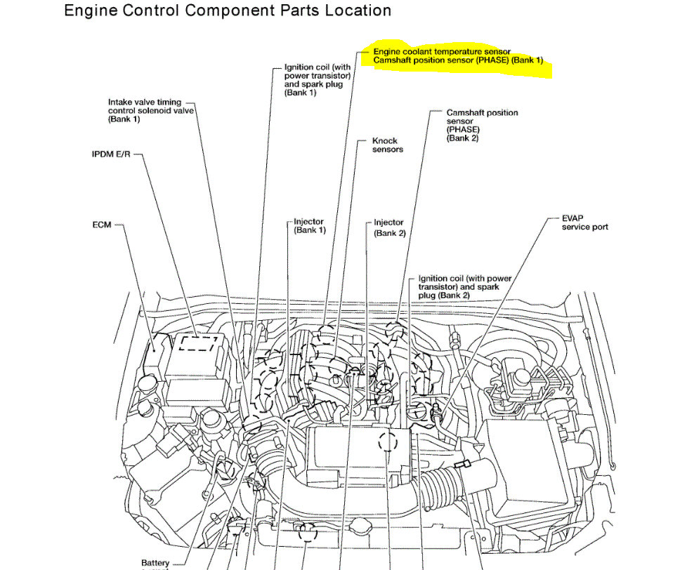

Check engine light on, Camshaft sensor
2005 NISSAN XTERRA
157 MILES • 4.0L • V6 • 4WD • AUTOMATIC
SAFIA
So my car has engine light has 157,000 miles and it saying camshaft position sensor bank 1, but when I go to shop to buy they say what side is it left or right. I don't know what it is. please reply.
Jun 12, 2021 at 1:22 PM
  • 110,241 POSTS
Telling them bank one should answer their question. LOL. Okay, if you are sitting in the vehicle, it is on the right side of the engine. It's located on the rear of the engine. (see pic 1 below)
If you are standing at the front of the vehicle, it is on the left.
In most cases, they determine left and right based on sitting in the vehicle, but you better ask them that as well.
Good luck. Please let me know if there is anything I can do to help.
See pic below.
