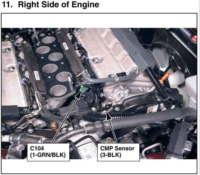

Where are the camshaft positioning sensors on my car?

The camshaft position sensor is right behind the timing cover on the right side of the engine. Check out the images (below). Let me know if you need anything else.
