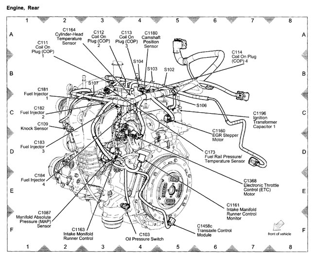

Hi, my car has probably a bad camshaft sensor, my mechanic is 95% sure.
Can I replace it myself, is it an easy job?
Does it require anything special, any computer work?

This job is not bad. this guide will help walk you through the repair with diagrams below to show the location on your car:

Will the engine check light go off automatically when I change the sensor?

No, you will need to clear the codes. here is a video to help you see how:
