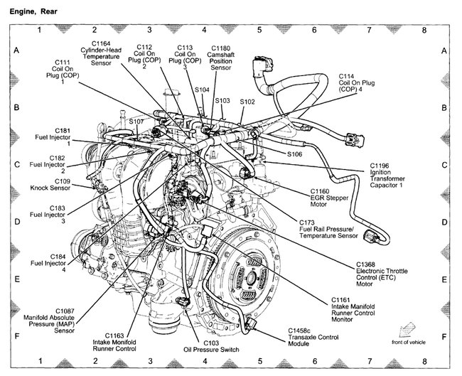

Hi, my car has probably a bad camshaft sensor, my mechanic is 95% sure.
Can I replace it myself, is it an easy job?
Does it require anything special, any computer work?

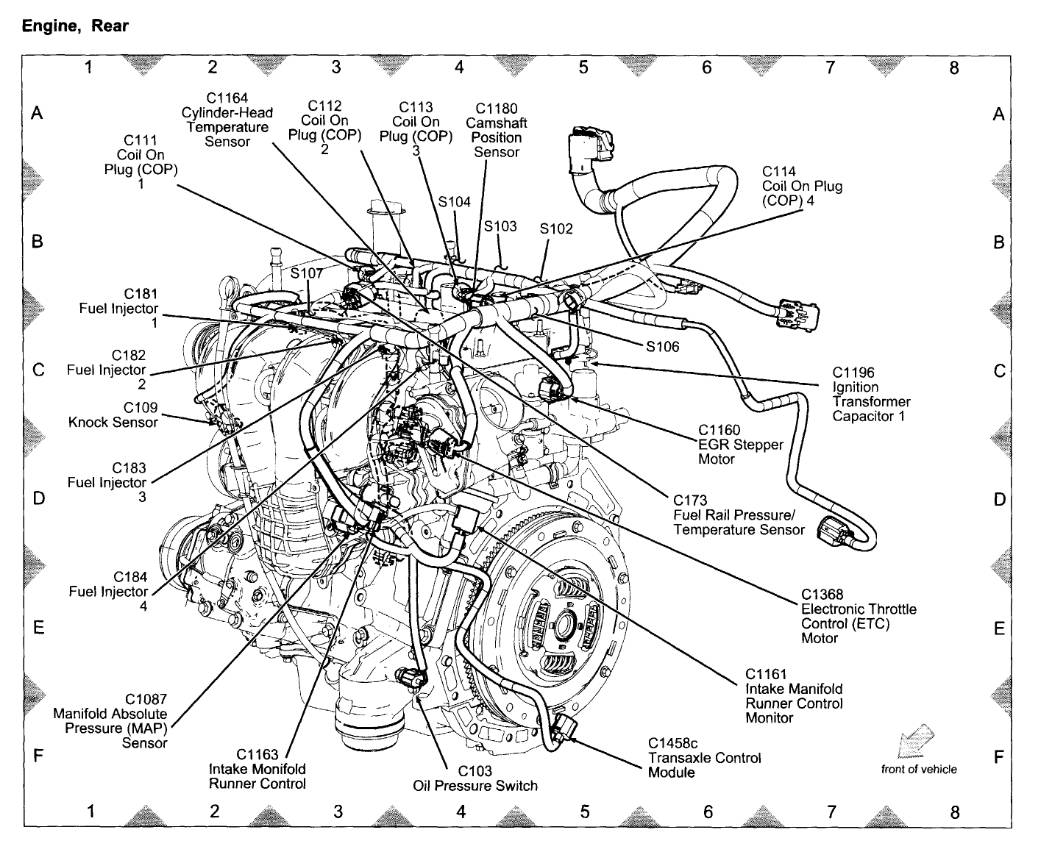

This job is not bad. this guide will help walk you through the repair with diagrams below to show the location on your car:
https://www.2carpros.com/articles/camshaft-angle-sensor-replacement
