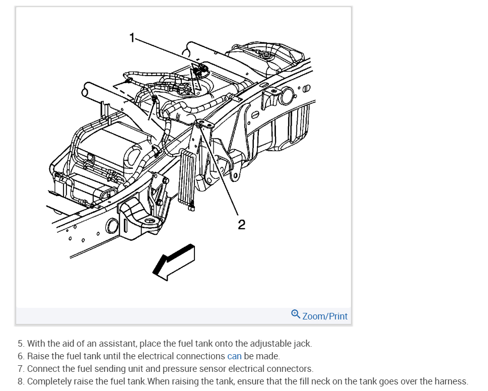

Truck runs for a bit then shuts off, maybe wait 15-20 minutes it starts back up. I replaced crank sensor and it still does it. Should I now replace cam sensor? It's not a fuel problem it gets no spark when this happens. Thanks

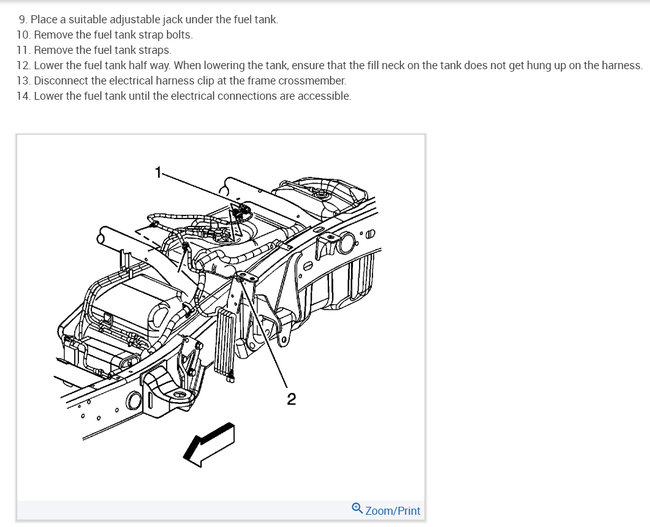

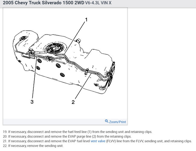

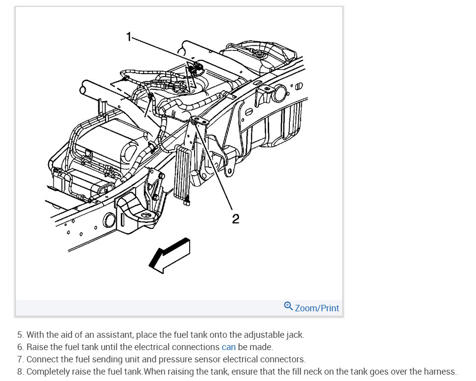

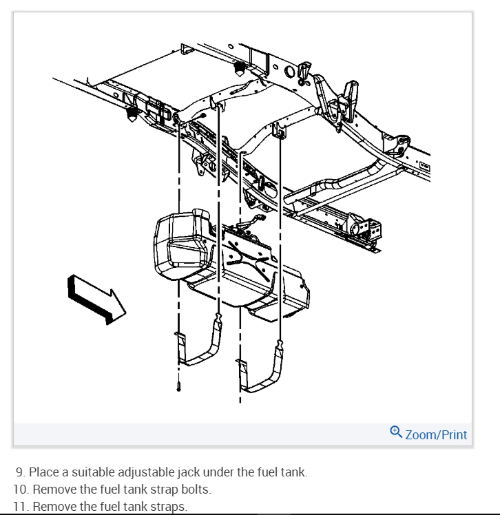

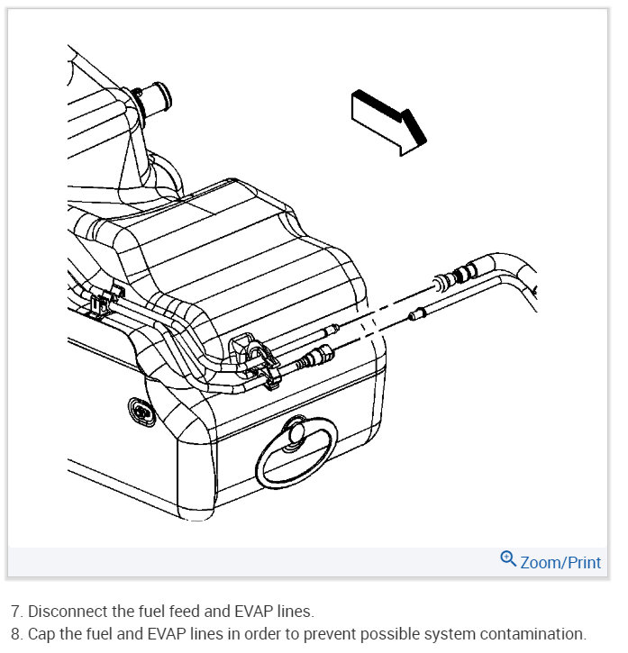

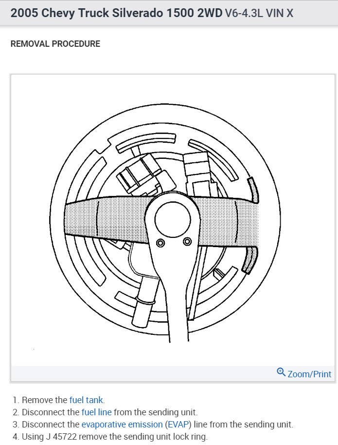

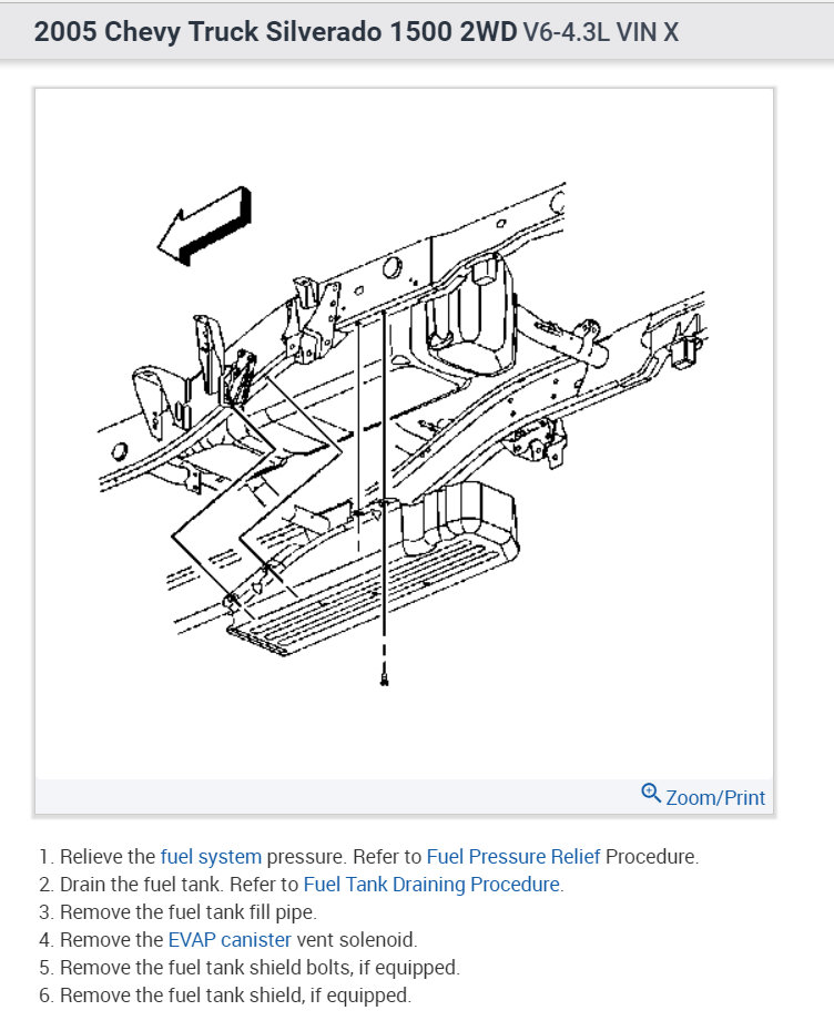

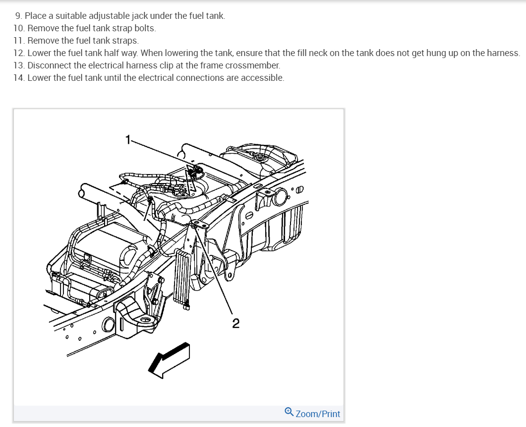

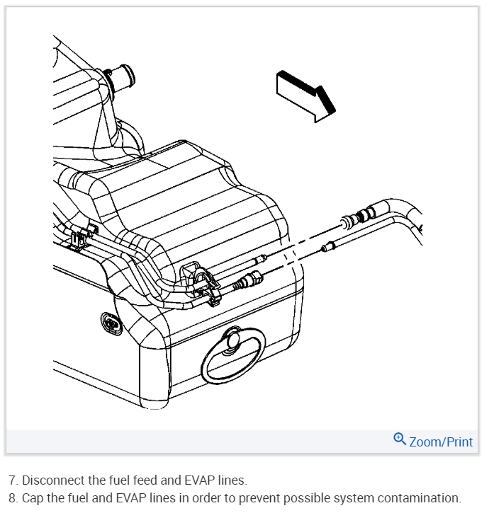

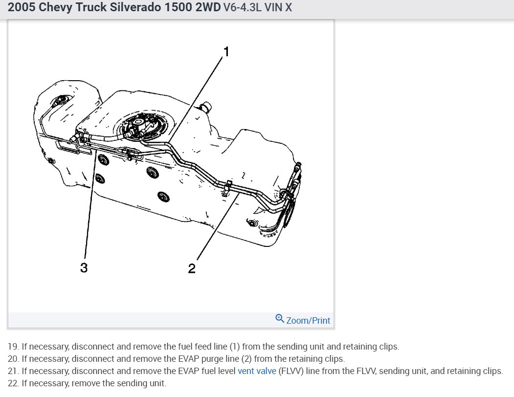

We should check for codes, but it sounds like the fuel pump is going out. After is has stalled out when you turn the key to the on position without cranking the engine over can you hear the fuel pump run in the tank for 5 seconds? Here are a couple of guides and the fuel pump replaced instructions in the diagrams below:
and
