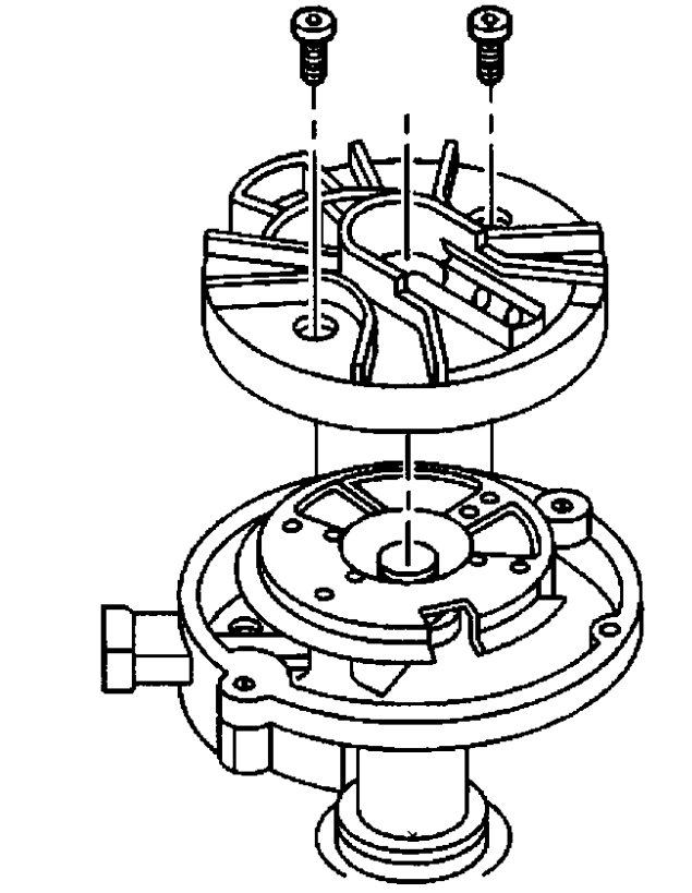

Where is the Camshaft Sensor located?
2000 CADILLAC ESCALADE
242,959 MILES • 0.6L • 6 CYL • 4WD • AUTOMATIC
KATIEBUG7N10

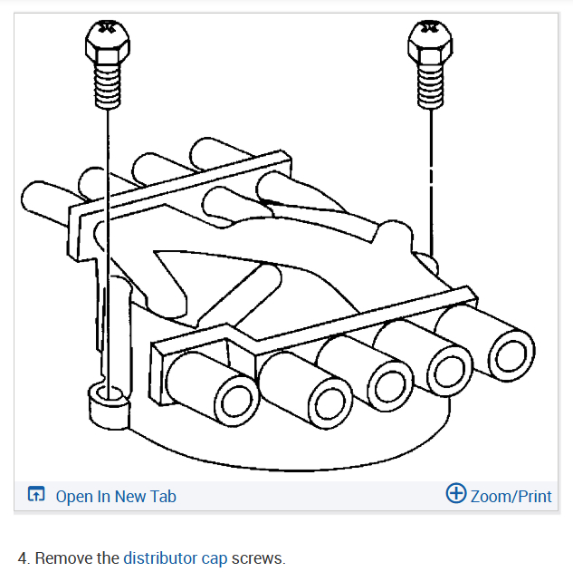

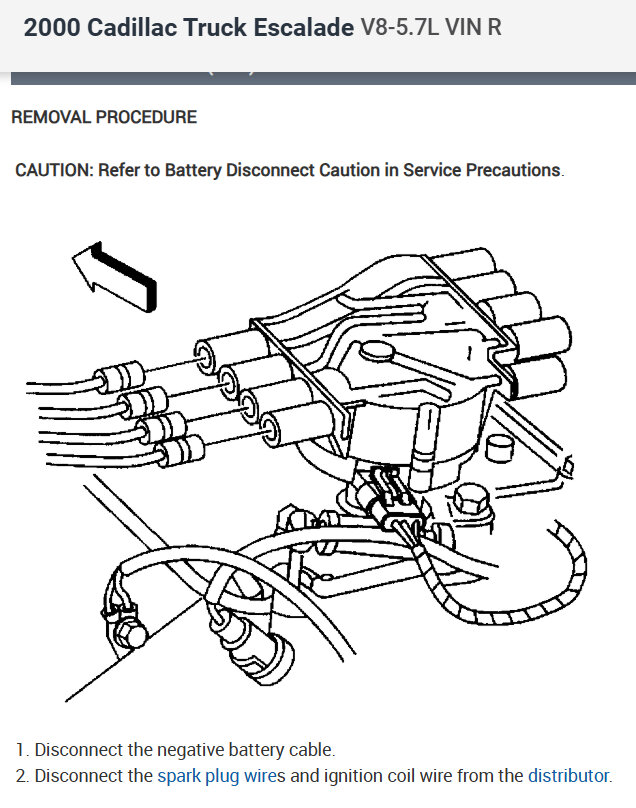

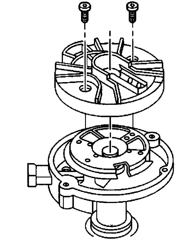

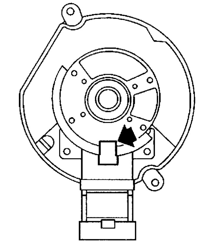

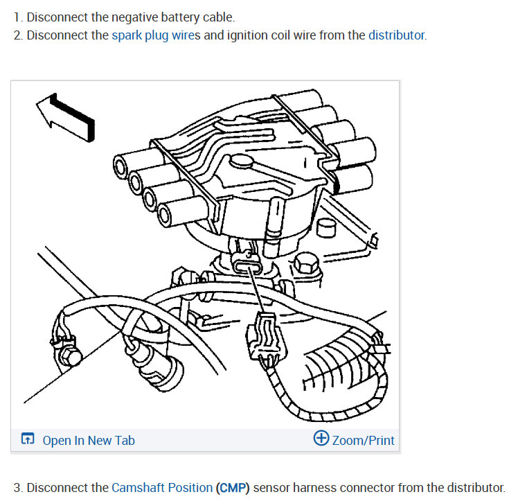

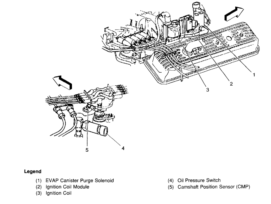

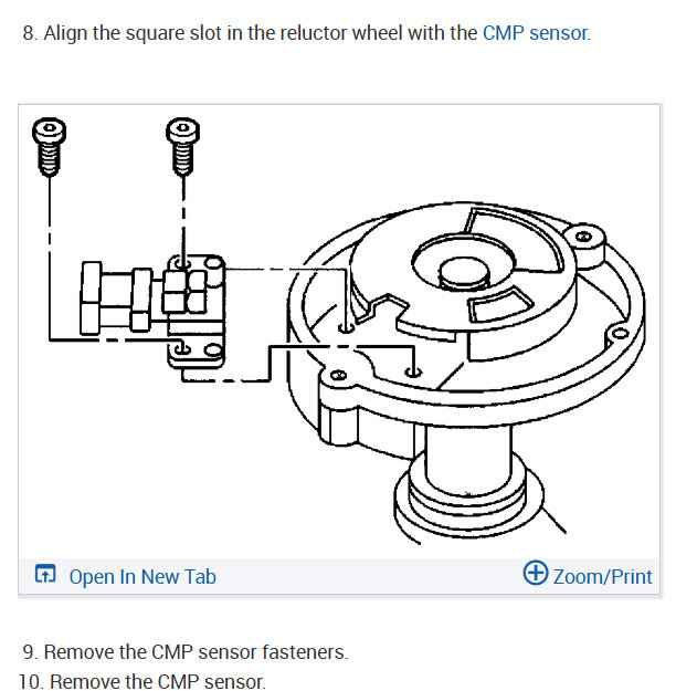

I am trying to replace the camshaft sensor on my vehicle listed above. Can you tell me where it is please?
Mar 16, 2025 at 5:44 AM
  • 55,224 POSTS
The camshaft sensor is located inside the ignition distributor. Here is the location and how to change it out. Can I ask if you are getting a code for this? Sometimes it will give you a code, but the sensor is not the problem FYI. Check out the images (below). Let us know how it goes.
