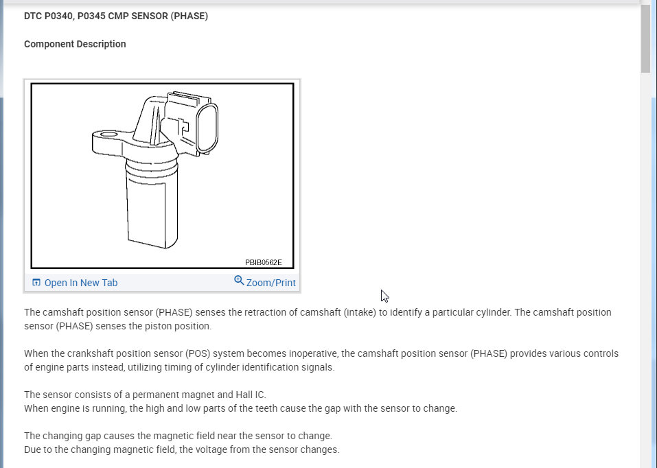

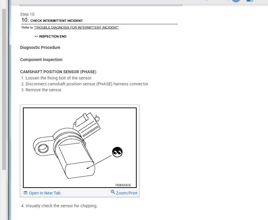

If I get a p0340 code does it mean bank 1 or bank 2?
Jul 30, 2020 at 7:31 AM
Experienced Mechanic
18,907 POSTS

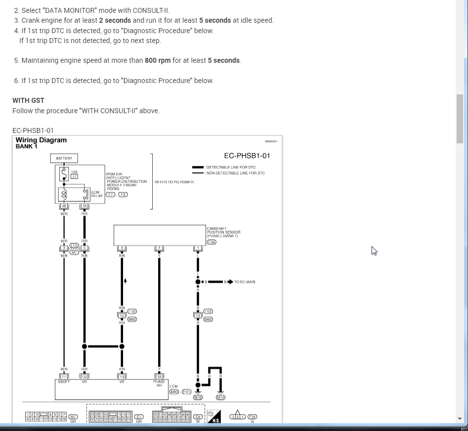

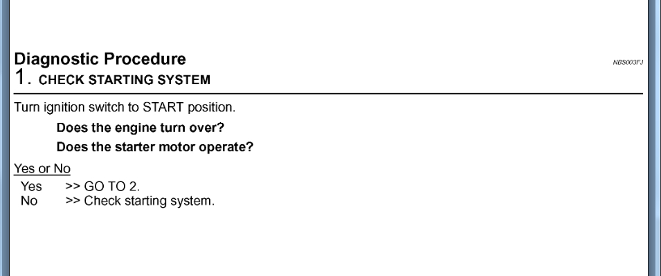

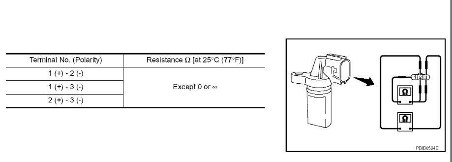

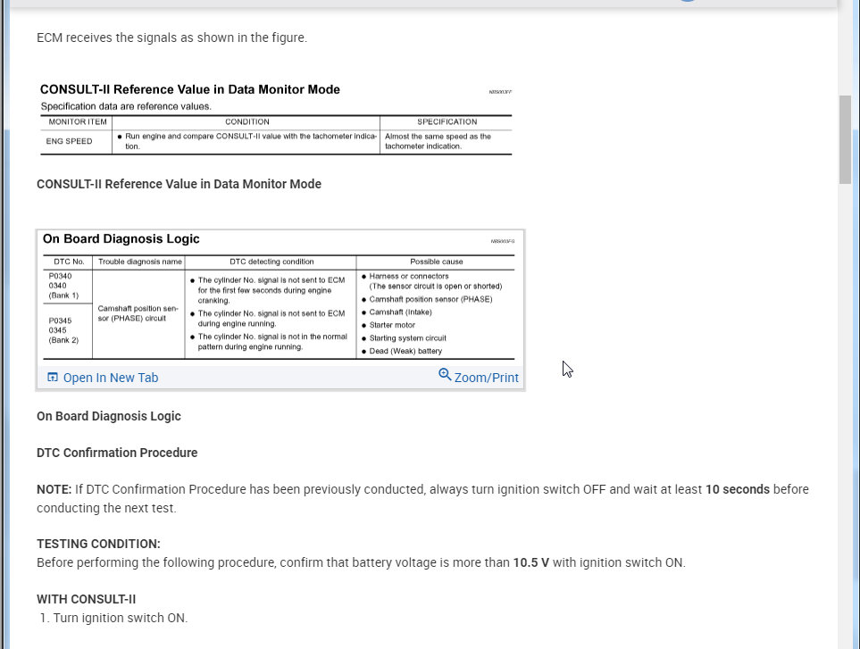

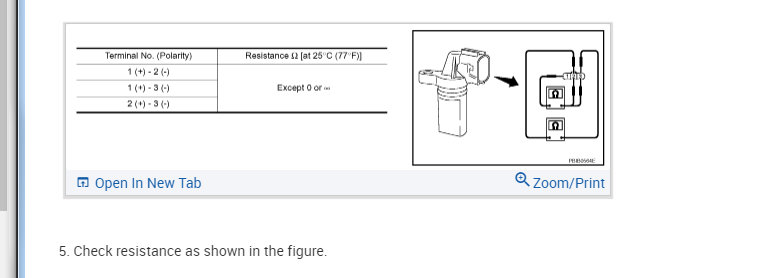

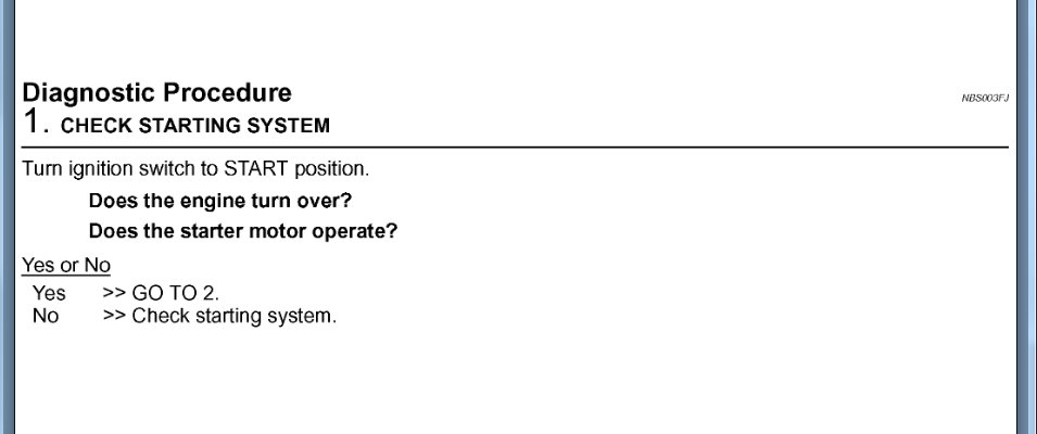

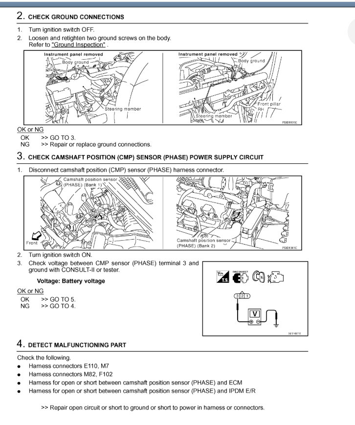

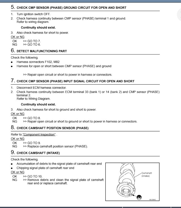

P0340 is Bank 1. I attached all the info on this code for your review and to run through the testing.
Here are a couple guides that will help with info and testing on o2 sensors.
https://www.2carpros.com/articles/how-to-test-an-oxygen-sensor-02-sensor
https://www.2carpros.com/articles/how-to-replace-an-oxygen-sensor
Let us know if you have questions and what you find. Thanks
