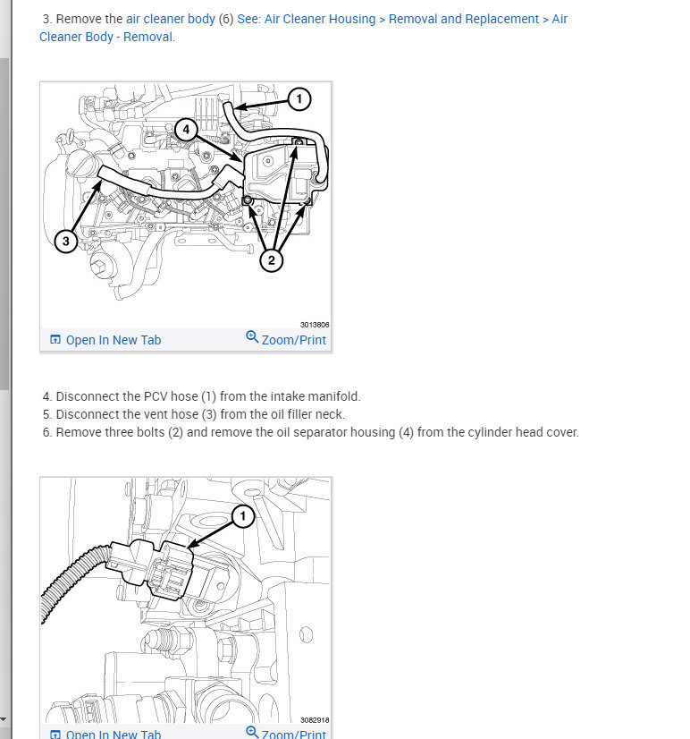

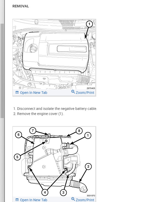

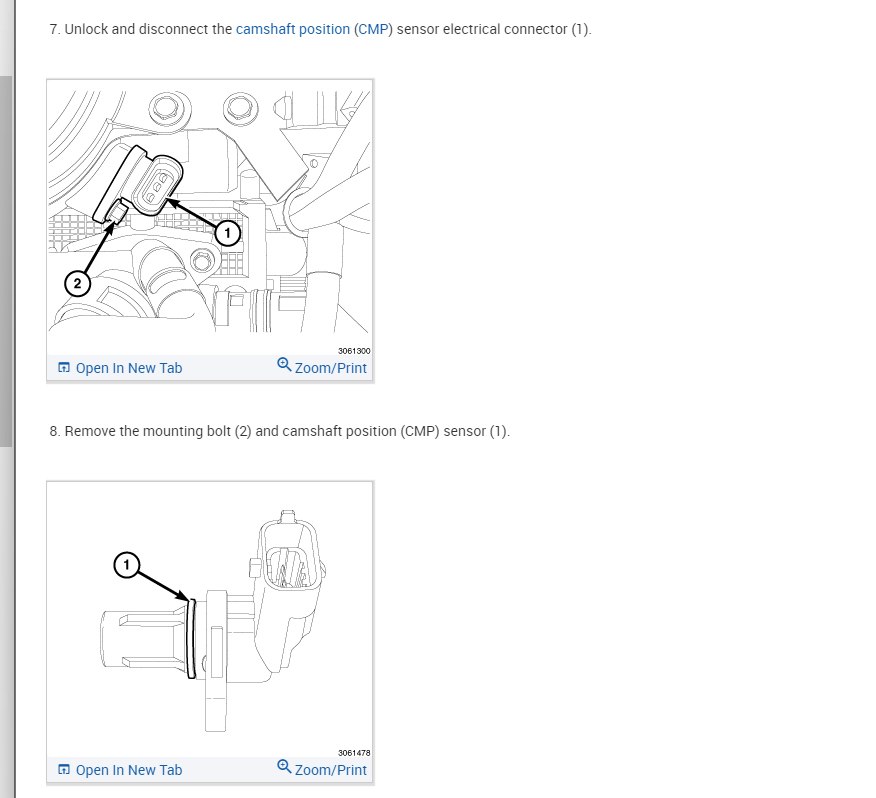

Where is the Camshaft Procession Sensor located?
2001 FIAT PALIO
180,000 MILES • 1.6L • 4 CYL • MANUAL
JUANITA JANSEN VAN RENSBURG
Camshaft Procession Sensor.
Jun 25, 2022 at 8:45 AM
Unfortunately, we don't have a manual on this vehicle as it is not offered here in the USA. However, I am attaching the info from a similar vehicle that we do have the info on.
Your engine is an overhead cam, so the sensor is going to be in the same general location as shown below.
If you still cannot find it, then try to get a couple of pictures of the front of the engine and I will see if we can locate it.
Please see the attached info below.
