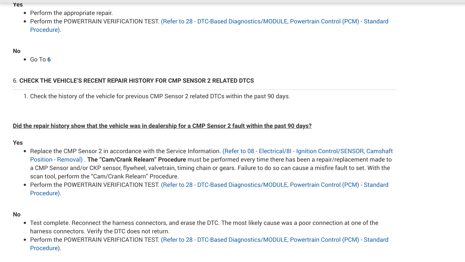

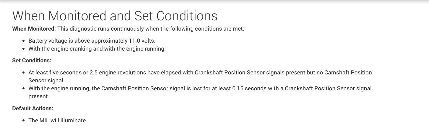

Car shut off while driving on highway, hooked it up to a scanner, codes for both cam position sensors A and B malfunction. Replaced both sensors. Still won't run. Scanner still reads cam position sensor b malfunction. Exchanged sensor to verify it was not a bad from the start, still won't run. It will start misfires and stalls. Wiring appears to be okay. Fuses good. P0365 code.

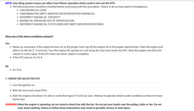

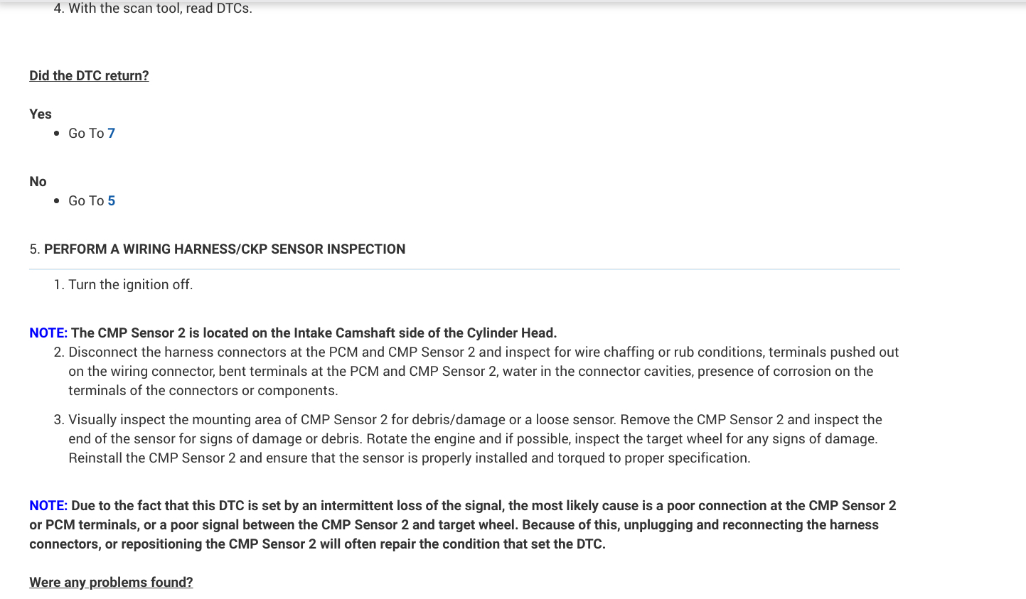

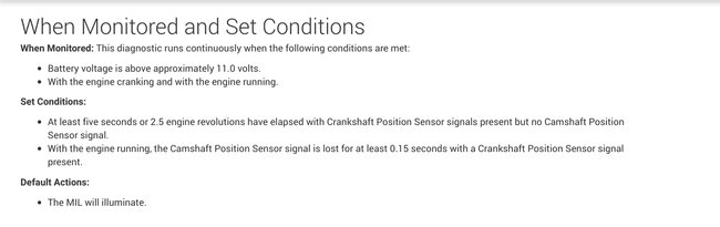

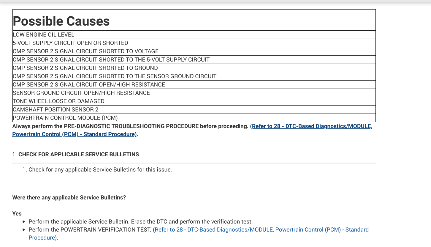

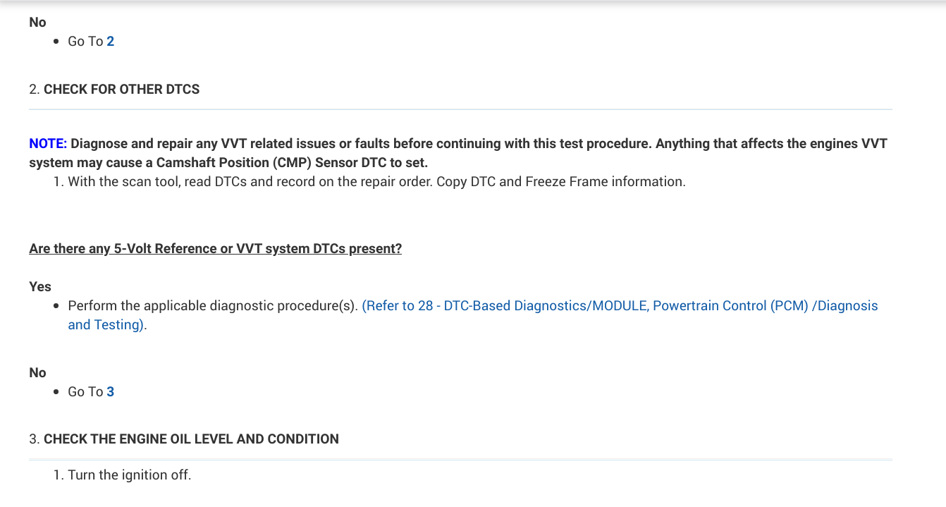

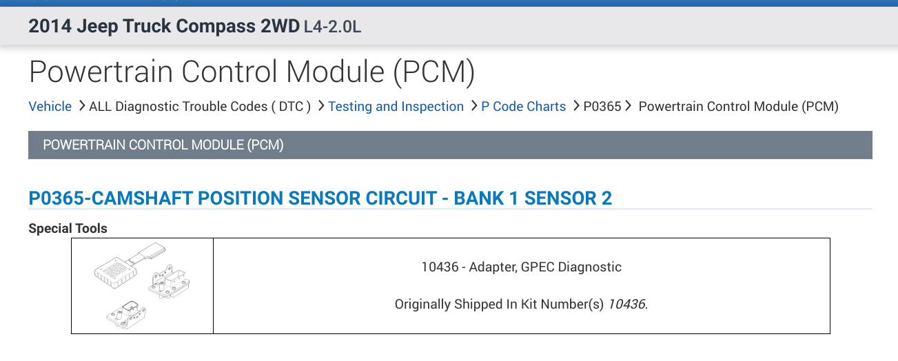

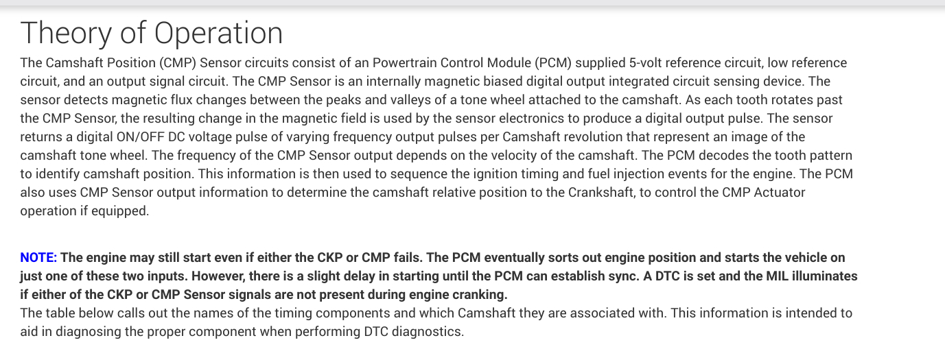

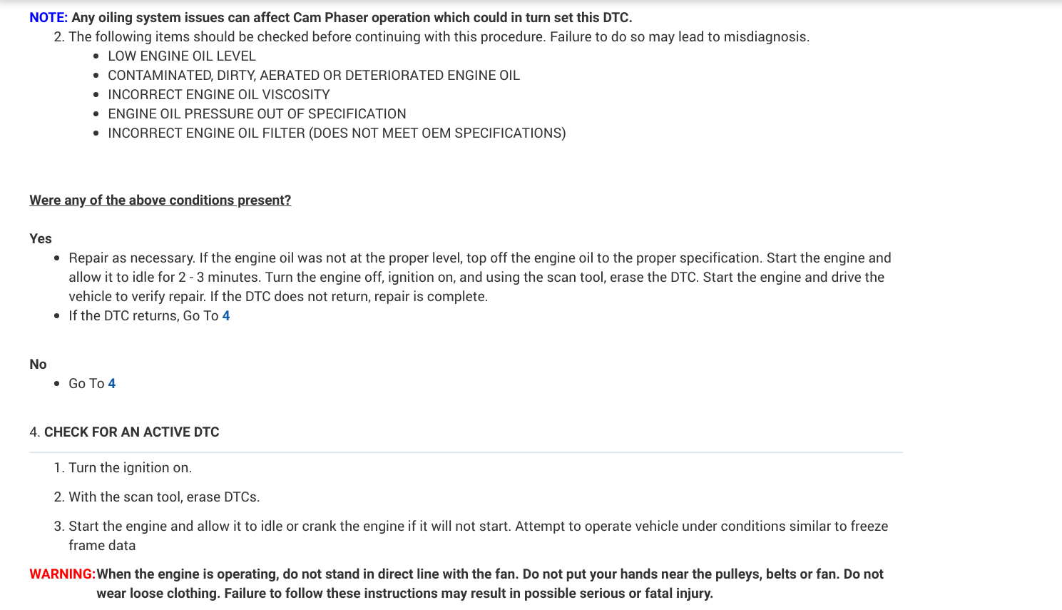

Hello again,
In the diagrams down below I have included the diagnostic troubleshooting guide for Direct Trouble Code[DTC] P0365 for your vehicle. It is from the vehicle manufacturer and if you follow it it will lead you to the problem so you can fix what is going wrong. Please go through this guide and get back to us with how everything turns out.
Thanks,
Alex

THRASHER421
Well, I have discovered the problem. Thank you guys for your help. I had 0 compression in 2 cylinders, so I pulled the top cover off. Only to discover my camshaft is snapped in two. It appears the middle Journal got hot seized up and snapped the camshaft..
Mar 6, 2020 at 5:25 AM
  • 55,423 POSTS
You don't see that problem to often. It sounds like the engine had an oiling problem with one of the journals. Are you going to fix it or have it done? I can send instructions if needed.
