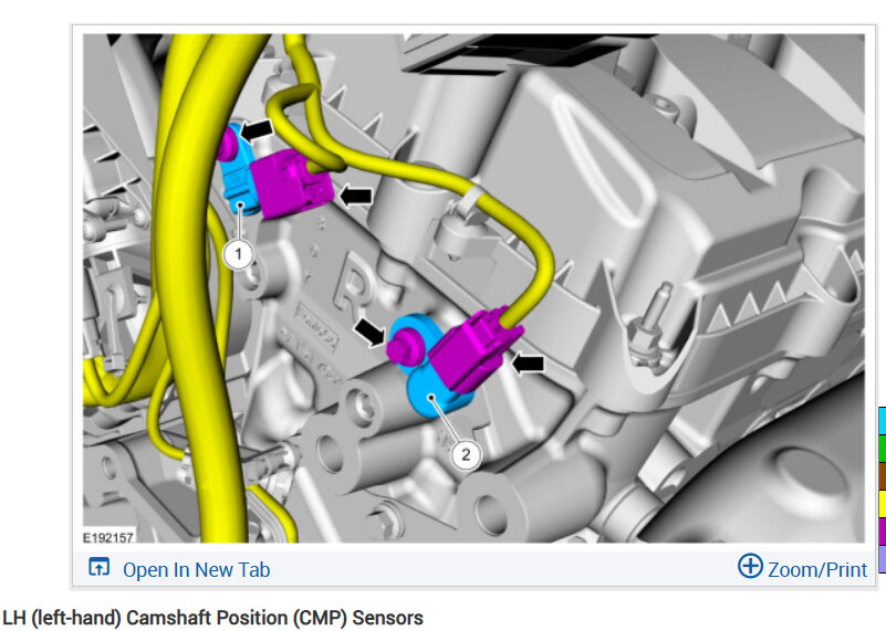

Where are the camshaft positioning sensors bank 1 and bank 2 located?
2017 FORD F-150
200,000 MILES • 5.0L • V8 • 4WD • AUTOMATIC
JOSEPH BINGENHEIMER
I need to replace the sensors. I cannot find the camshaft sensor one or camshaft sensor 2.
Jul 3, 2025 at 8:16 AM
  • 55,436 POSTS
The problem will probably not be the sensors, you get these codes when the timing chains, guides and camshaft actuators go out, this is a common problem. but if you want to give it a shot here, they are at the rear of the cylinder heads. The way to tell if the timing components are worn out is the eigne is make a slight rattle sounds at idle. Check out the images (below). Let us know how it goes.
