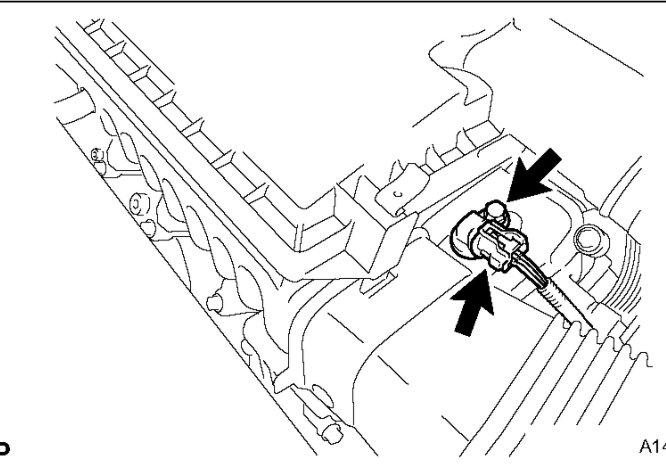

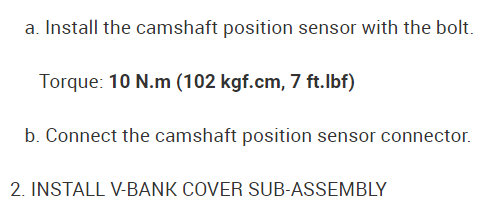

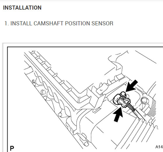

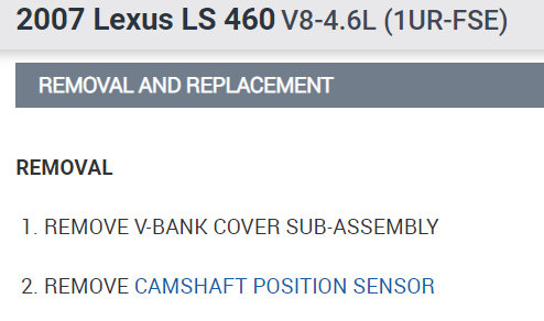

Do not know where it is, or they are to replace?
Jul 10, 2018 at 9:55 AM
DANNY L
  • 5,648 POSTS
Hello, I'm Danny.
Here is the information you've requested. First, here is a tutorial for you for you to view on camshaft sensor replacement:
https://www.2carpros.com/articles/camshaft-angle-sensor-replacement
I've attached picture steps below for the camshaft sensor replacement on your car. Hope this helps and thanks for using 2CarPros.
