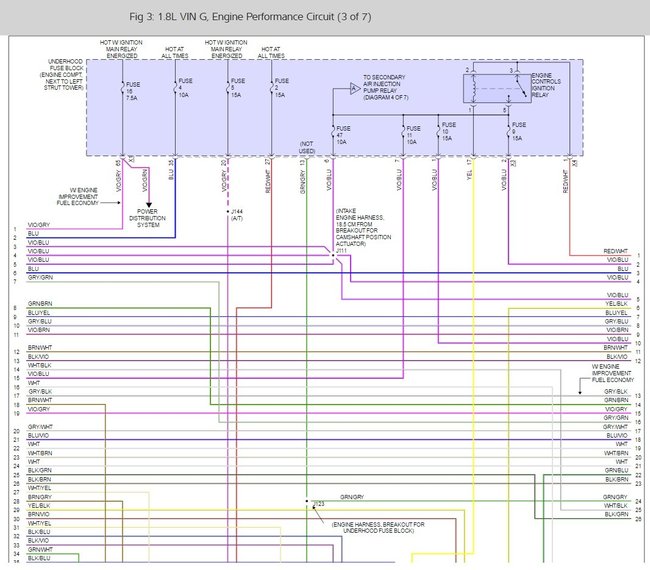

I was told that i had a small crack in both of these valves, but it was not to worry some. Now, when I shut my car off. it seems as if my car is still running for some time before it finally shuts off. Does this have anything to do with the camshaft or is this something completely different?

Hey LINSIH,
The shutting off problem would be something different. It sounds like you have an ignition relay that is sticking, here is a diagram that will show you were it is. When you shut the engine off and it is still running try pulling the relay to see if the engine shuts down.
Please let us know happens so it will help others.
Best, Ken
