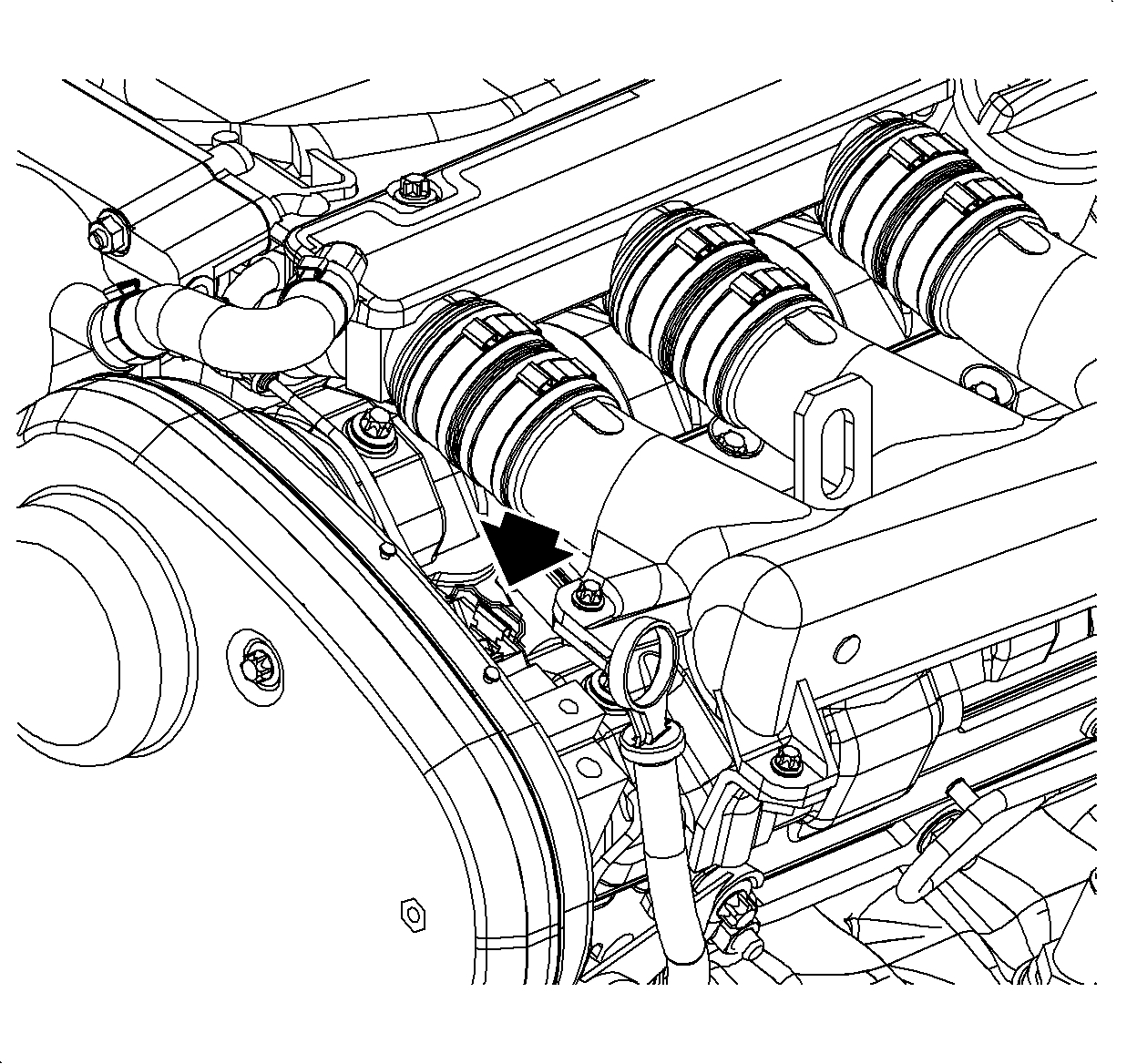

does this model have one or two sensors, if 2 where is it?
Jan 23, 2020 at 2:56 PM
  • 110,194 POSTS
There is one. Here are the directions for replacing it. The attached pic both correlates with the directions and shows the location of the sensor.

CAMSHAFT POSITION (CMP) SENSOR REPLACEMENT
REMOVAL PROCEDURE
pic 1
1. Turn the ignition OFF.
2. Disconnect the camshaft position (CMP) sensor harness connector.
3. Remove the knock sensor 2 pigtail from the attachment clip.
4. Remove the CMP sensor attachment bolt and remove the sensor.
INSTALLATION PROCEDURE
pic 2
1. Install the knock sensor 2 pigtail clip to the CMP sensor if installing the new sensor.
NOTE: Refer to Fastener Notice in Service Precautions.
2. Install the CMP sensor by gently pushing into place and install the attachment bolt.
Tighten the camshaft position sensor bolt to 8 N.m (71 lb in).
3. Insert the knock sensor 2 pigtail to the clip.
4. Connect the CMP sensor harness connector. Push the connector in until the lock position is felt, then pull back to confirm engagement.
