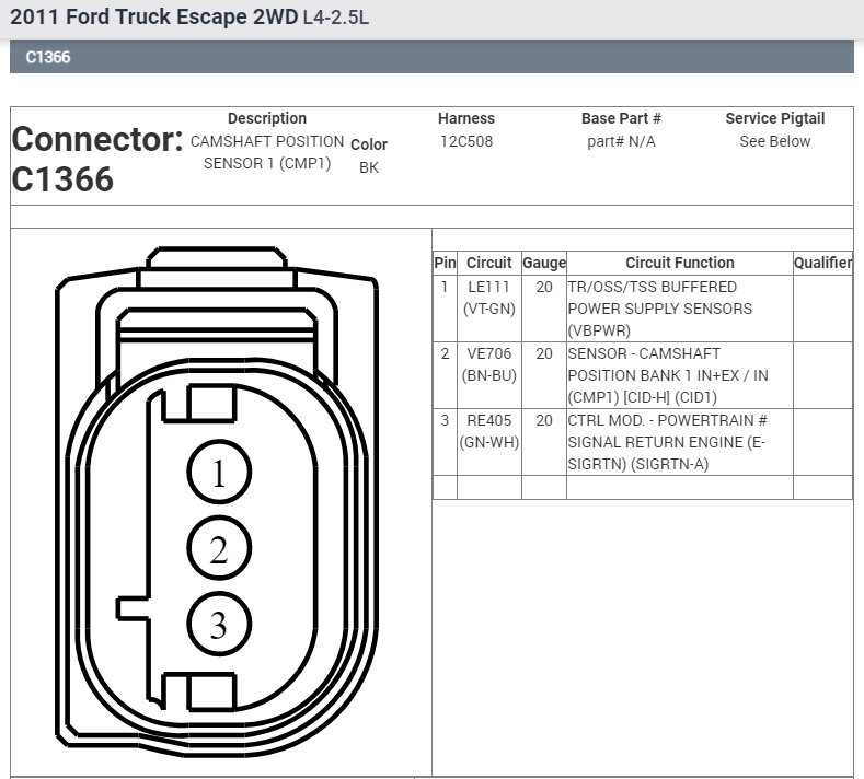

Do you have the connector pin wiring diagram for the camshaft position sensor please?
Monday, January 10th, 2022 AT 11:01 AM
SQM
MECHANIC
6,383 POSTS

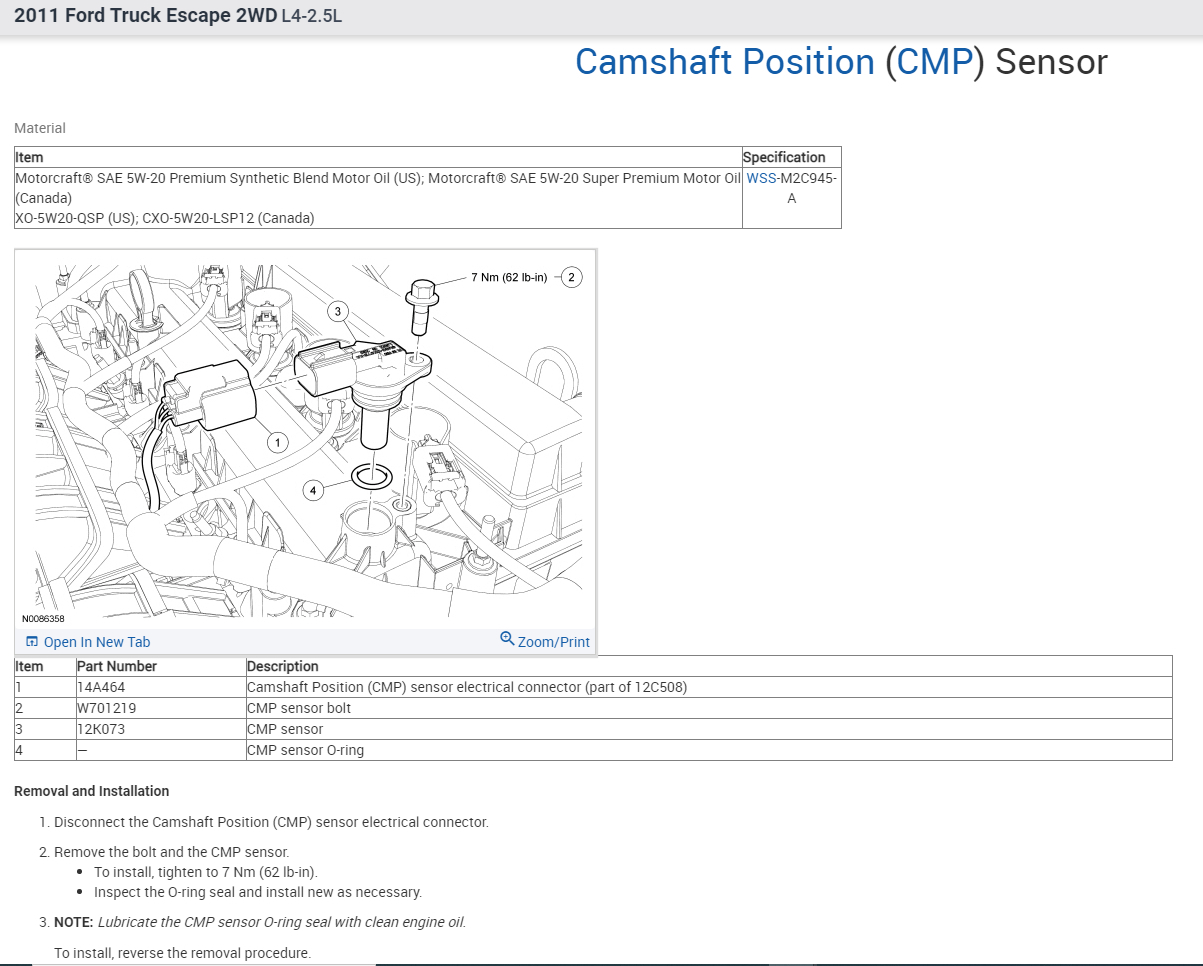

See attached for the pinout diagram for the camshaft position sensor.
Also included is the replacement procedure including the torque specification.
