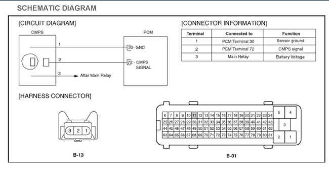

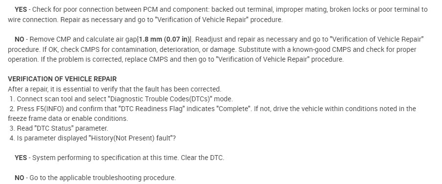

I replaced my VVT solenoid and once replaced, I started having engine issues. My car had a camshaft position sensor bank a code and I replaced the camshaft position sensor entirely since it’s an old car and I’m the new owner. I’m still getting the same performance issues/stalling and same code. A spark occurred from faulty VVT solenoid and s*** the engine off, so I replaced the wiring and solenoid itself to keep that from happening again. I’m thinking this may have caused ECM damage but that’s expensive and I want to make sure before I do anything.

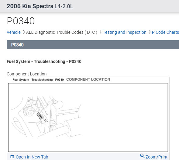

The idea that something sparked/shorted, there is a chance an electronic component was damaged. However, if you replaced the solenoid and that is when the problem started, I question if the solenoid is faulty.
Let me know the diagnostic trouble code you have. I can use that to see possible causes and diagnostics to resolve the issues.

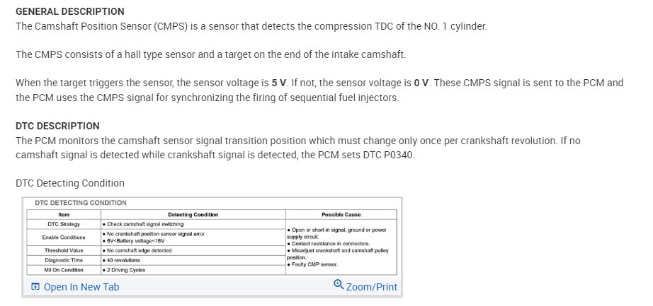

P0340 was the code. Also, the solenoid sparked on the old one. I replaced the solenoid and the electrical connector to it after that. Then my car had this code after the old one went away.

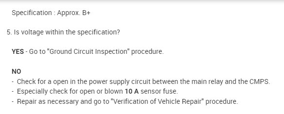

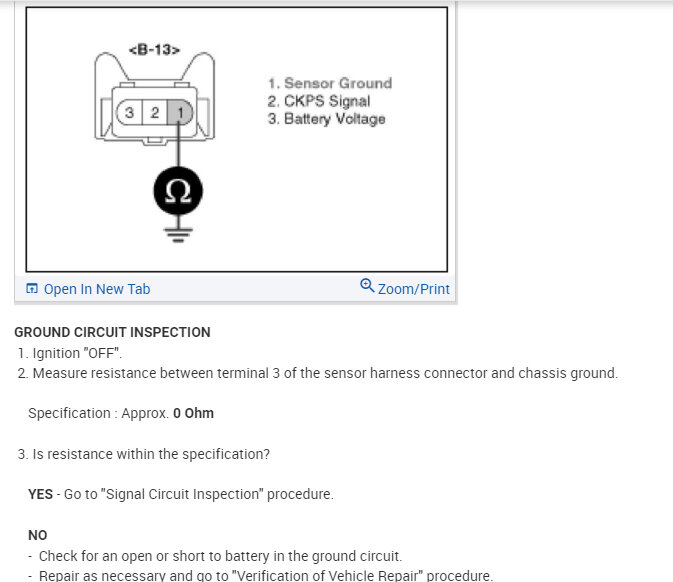

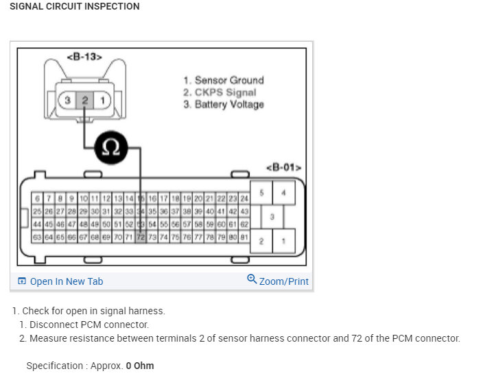

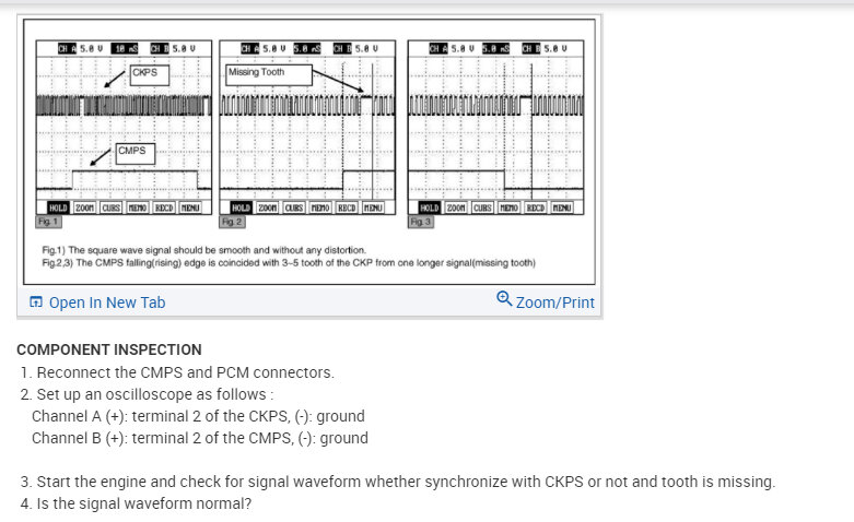

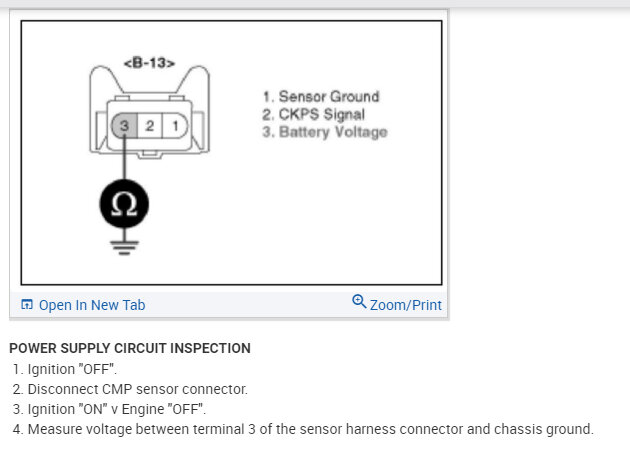

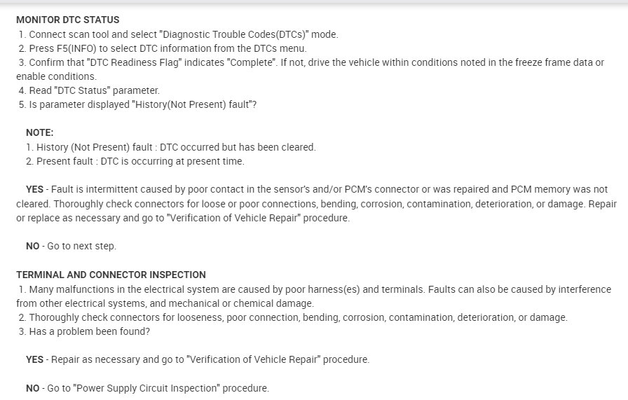

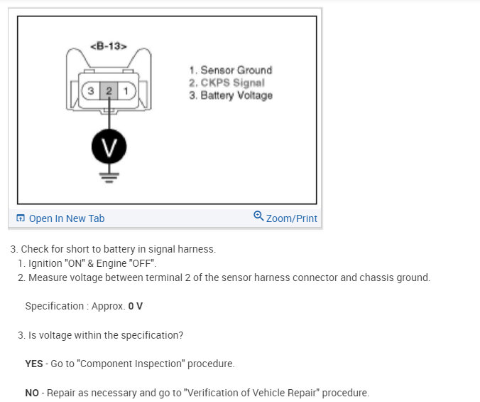

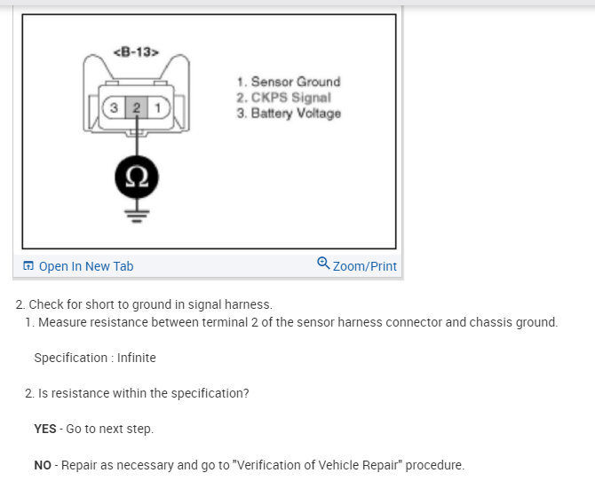

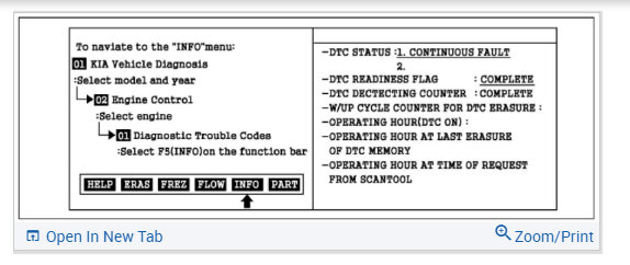

The P0340 indicates there is no signal from the sensor. You indicated the replacement of the connector. Are you certain the wiring was connected to the correct pins? Is there a possibility that one of the repairs has failed?
I attached diagnostics below which will walk you through checking the connector. Take a look through them and let me know if you are comfortable performing them.
