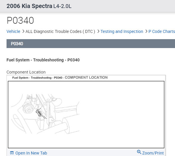

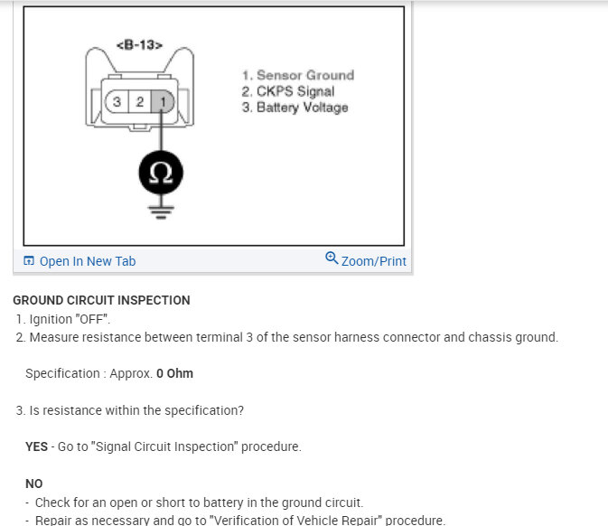

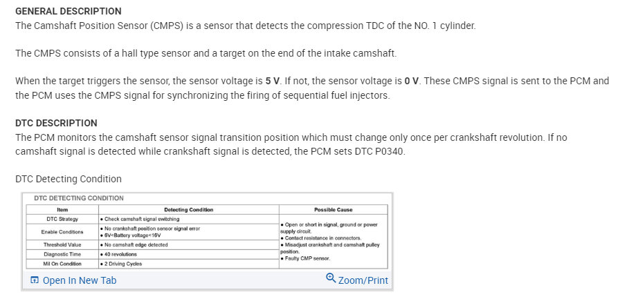

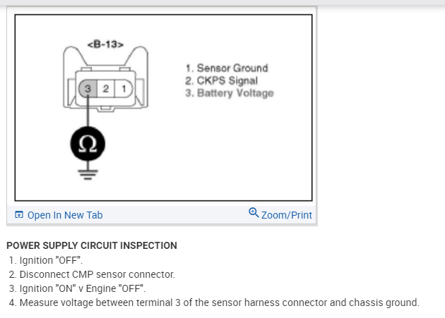

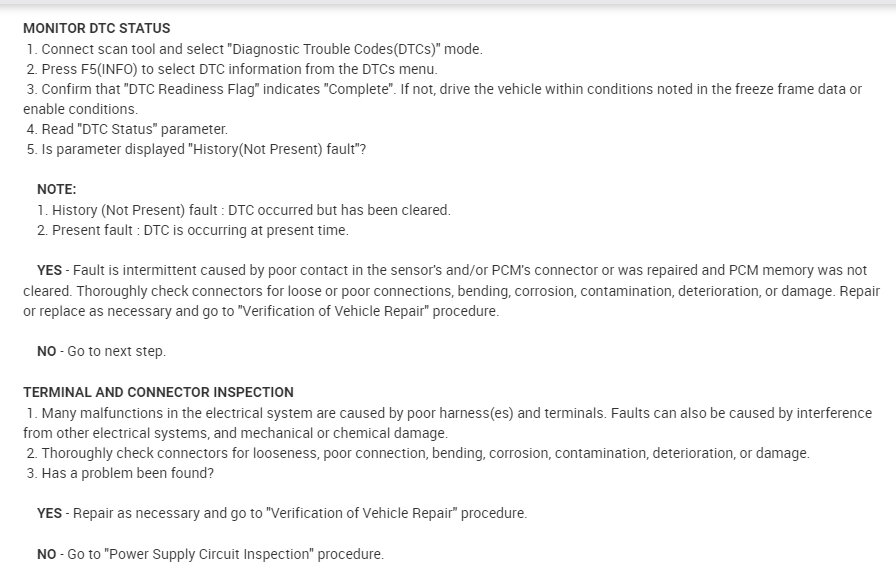

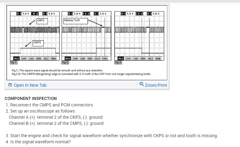

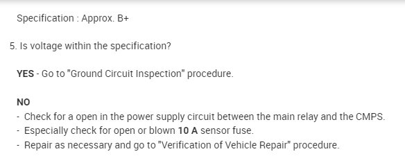

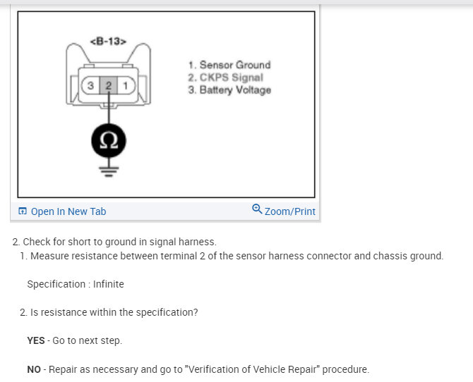

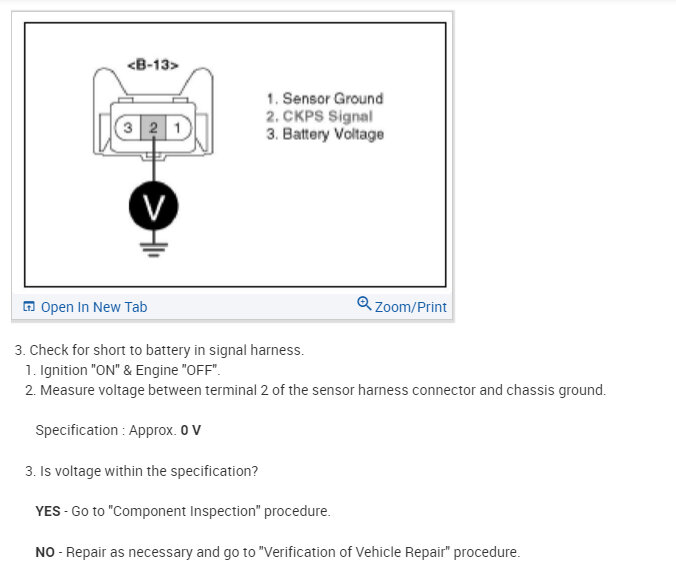

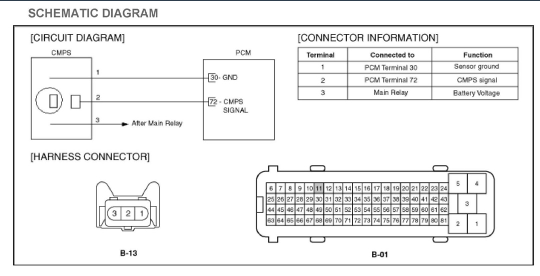

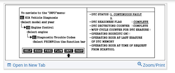

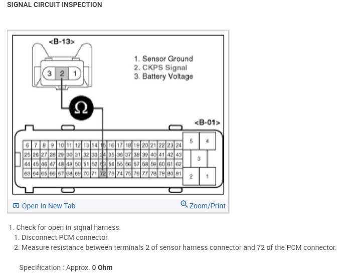

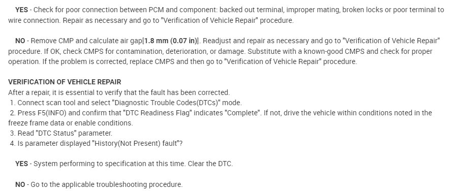

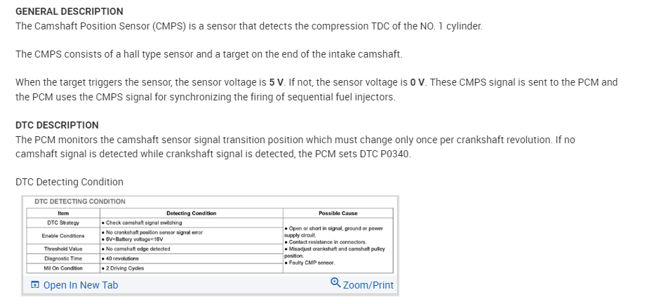

The P0340 indicates there is no signal from the sensor. You indicated the replacement of the connector. Are you certain the wiring was connected to the correct pins? Is there a possibility that one of the repairs has failed?
I attached diagnostics below which will walk you through checking the connector. Take a look through them and let me know if you are comfortable performing them.
